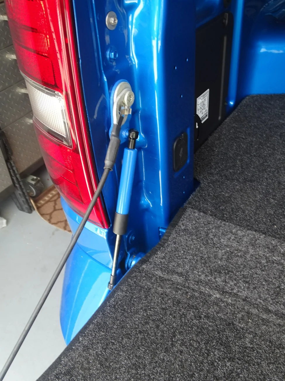

Seems like it's mounted upside down but This is how I mounted mine. Works fine
This is how I mounted mine as well
#BTW I haven't open the tailgate since tho...

The pictures actually show the correct mounting. Mounting this way allows the seal oil in the cylinder to remain on the the piston seal when in the closed position, which is 99% of the time.

The only thing is if it develops a leak it will drain out. The other way the oil will stay inside if the seal goes bad.
The amount of oil is less than a drop or 2. It is better to install piston down for longer life. Either way, if the seal fails it will need to be replaced. It will just last longer lubricated. The actual dampening of the strut is nitrogen gas, not liquid.
