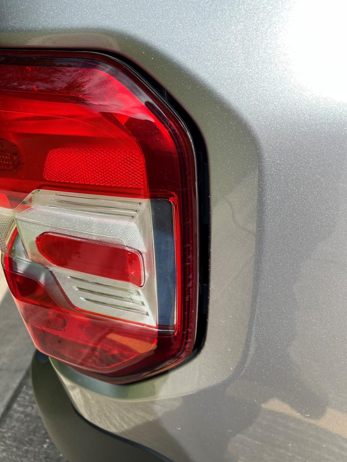

Anyone else having this issue? The passenger taillight, you can pop it back into place but it will pop back out at some point. Not sure if maybe those clips are bad or what. I plan to have it looked at when I take it in for the first time soon.

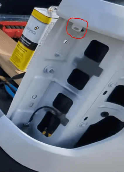

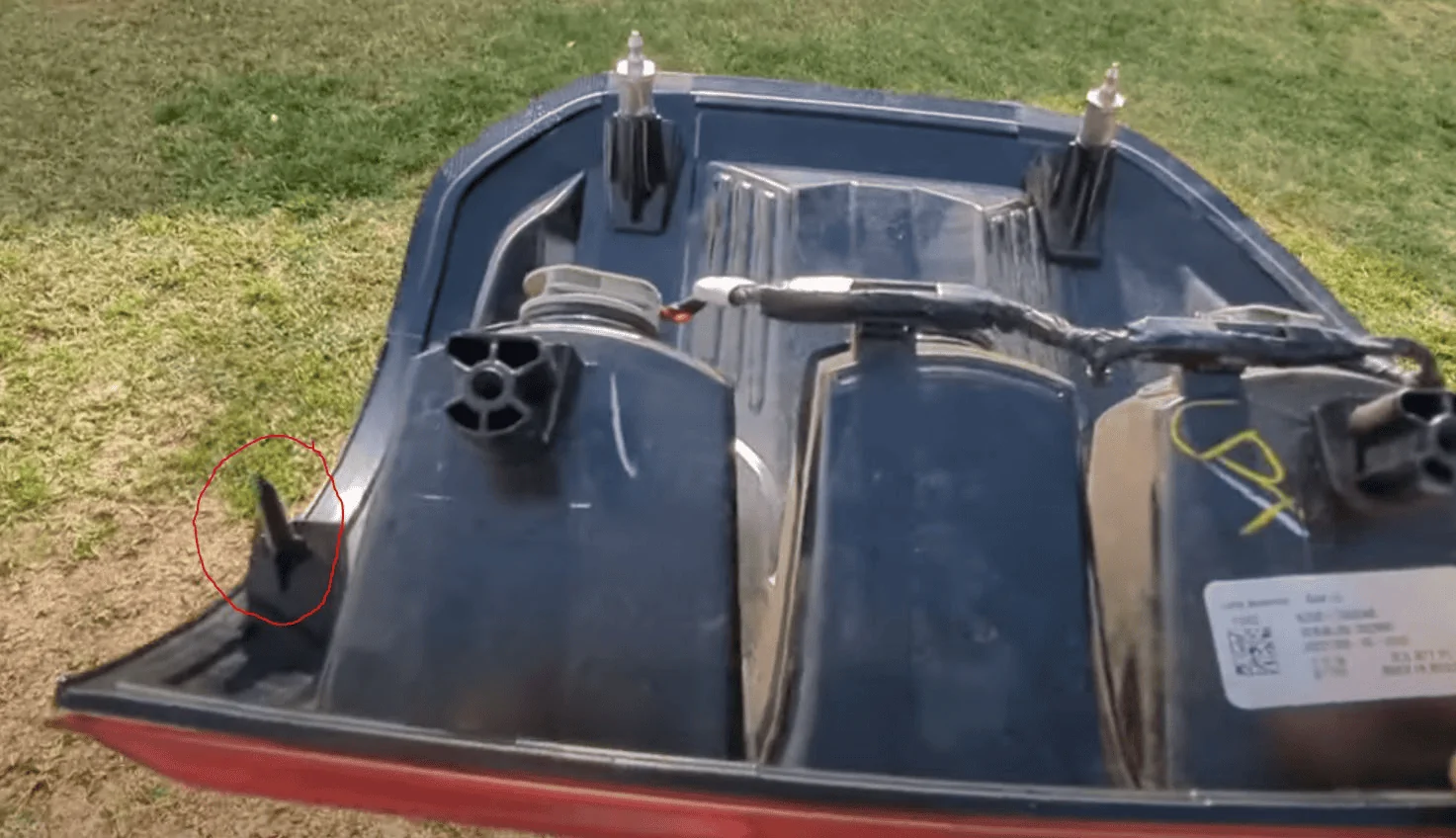

There is a pin at the top of the light fixture that goes into a slotted hole in a flimsy tab on the fender. If it's missing the hole and pushing against the tab it will try to spring the front edge of the light out.
You can check this pin/tab/hole alignment by looking into the small gap between the top of the light and the fender, looking in from the side using a flashlight, should be easy to see with the light popped out like yours.
Here are pictures showing the tab and pin I'm referring to. The pictures I found show the right side fender and a left side tail light, but you can get the idea.
Ford Maverick Taillight keeps popping out 1712336286082-gi
Ford Maverick Taillight keeps popping out 1712336309958-c8
