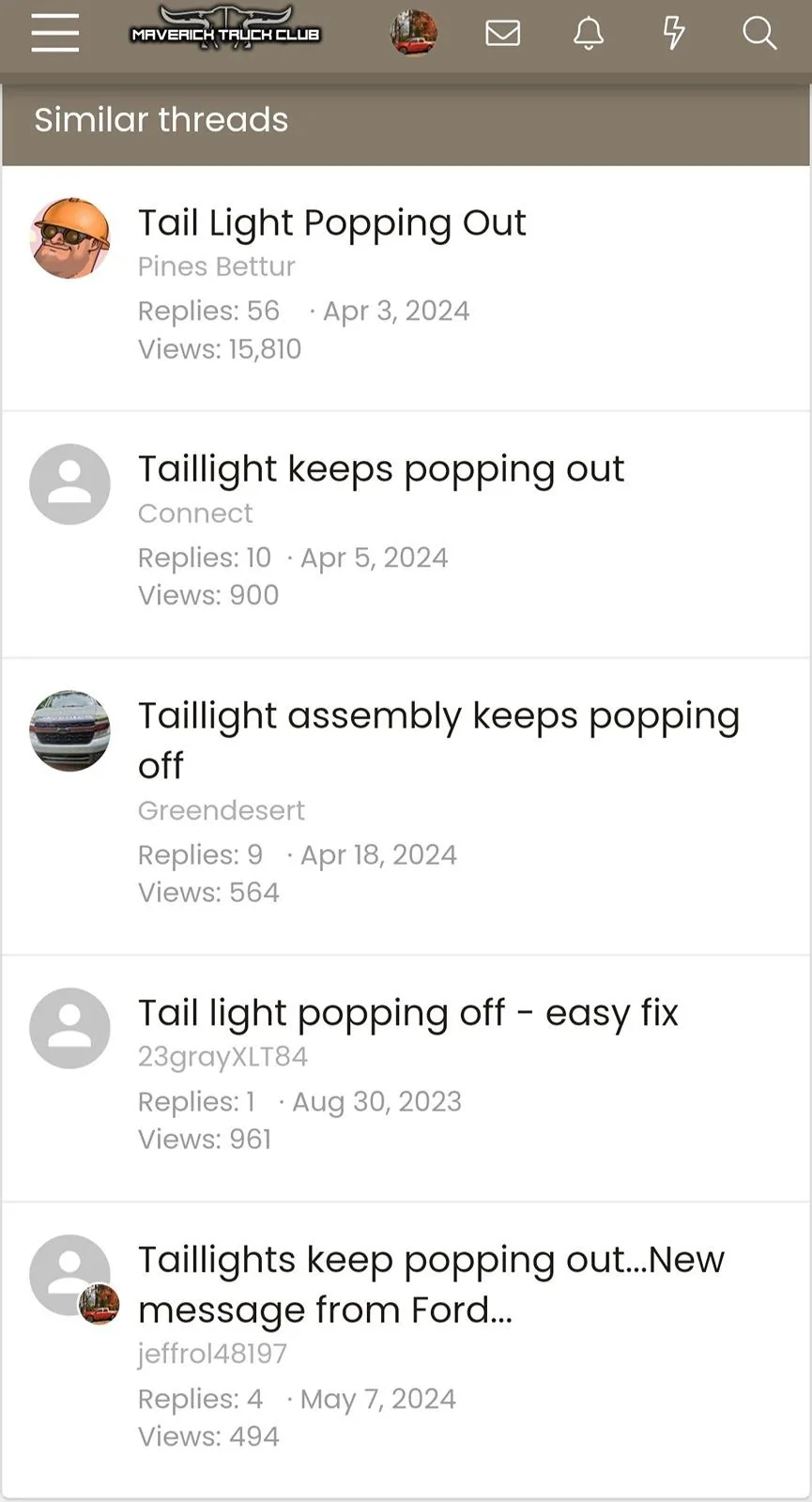

See the similar threads below these posts
Ford Maverick Tail light keeps popping out…. 20240616_225138
