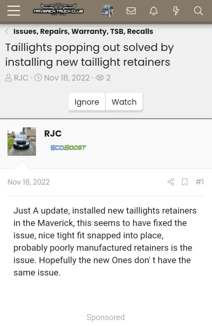

Look through the threads at the bottom of this thread. They're indeed was an update. Including some suggestions of removing the retaining clip putting it on the tail light pin and then pushing it back into place.
Example 👇👇
Ford Maverick Taillight popping out TSB 20250906_102904
