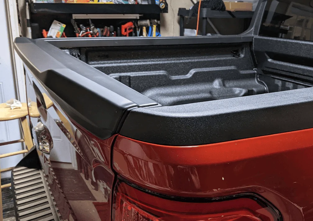

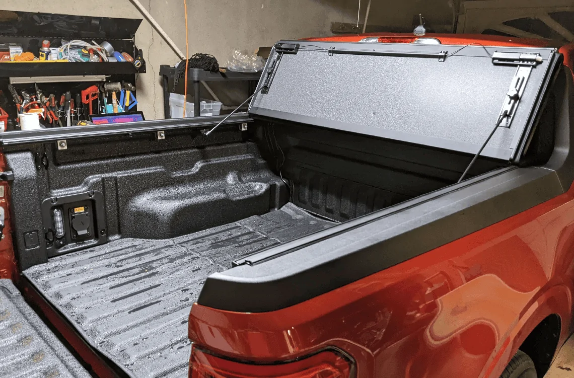

I like the upgrade you did especially the spoiler on the tailgate. I wish that there was a section in the odometer that would tell you lifetime electric miles. Luckily one of my trip one or trip two I started as soon as I got it from the dealership so I'm able to track it that way but the second I have to restart the battery it's going to be gone
Thanks! If the cab spoiler didn't point upwards so much (and maybe came body colored) I might have considered that as well but I feel like it might be detrimental for my MPGs?

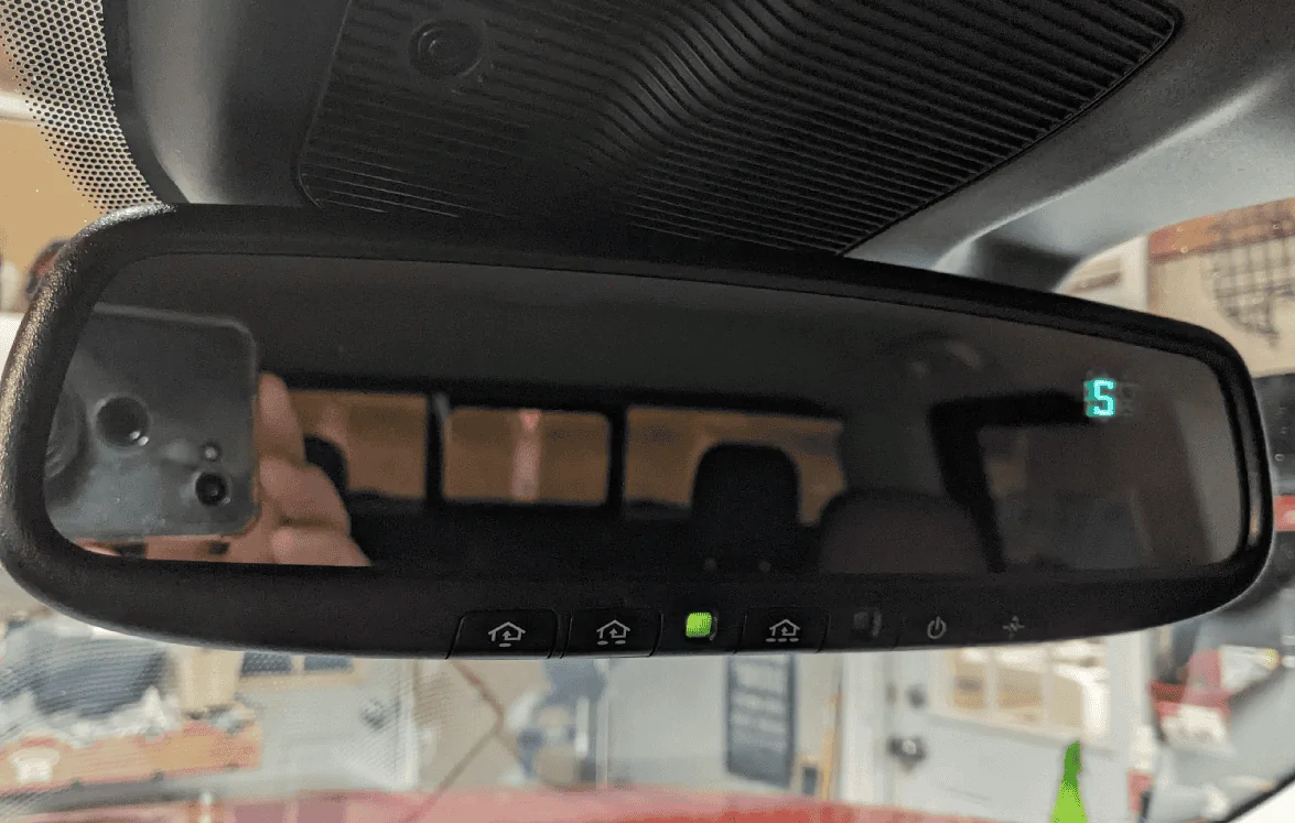

Also doing the same for the odometer, planning to leave trip 2 on until at least my first oil change. Maybe should remember to take a photo before I reset it :)

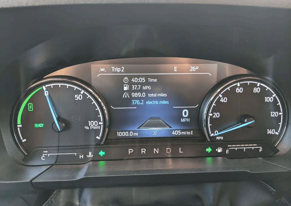

After 1,000 miles, I'm very pleased with it. I ended up right at the EPA estimated MPG after the first 1k. I drive a mix of mountainous back roads and have taken her on a few 100+ mile drives. I've been using the EV Coach as my primary screen when driving to keep the MPG up and using slippery mode to allow for more of a pulse and glide style (eco mode regen brakes a bit too much for this IMO) I do wish this screen could be combined with the Fuel Economy screen which would bring it a lot closer to the info I had in front of me while driving the Prius. I also spent a lot of time just sitting in it with it turned on, thinking about what upgrades I wanted to do and just taking it all in, so I potentially could have 40MPG+ in the next 1K.

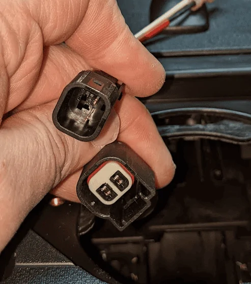

  • HVAC controls swap with temperature displays (Apparently I might need forscan for this, the unit I picked up didn't work right when installed)

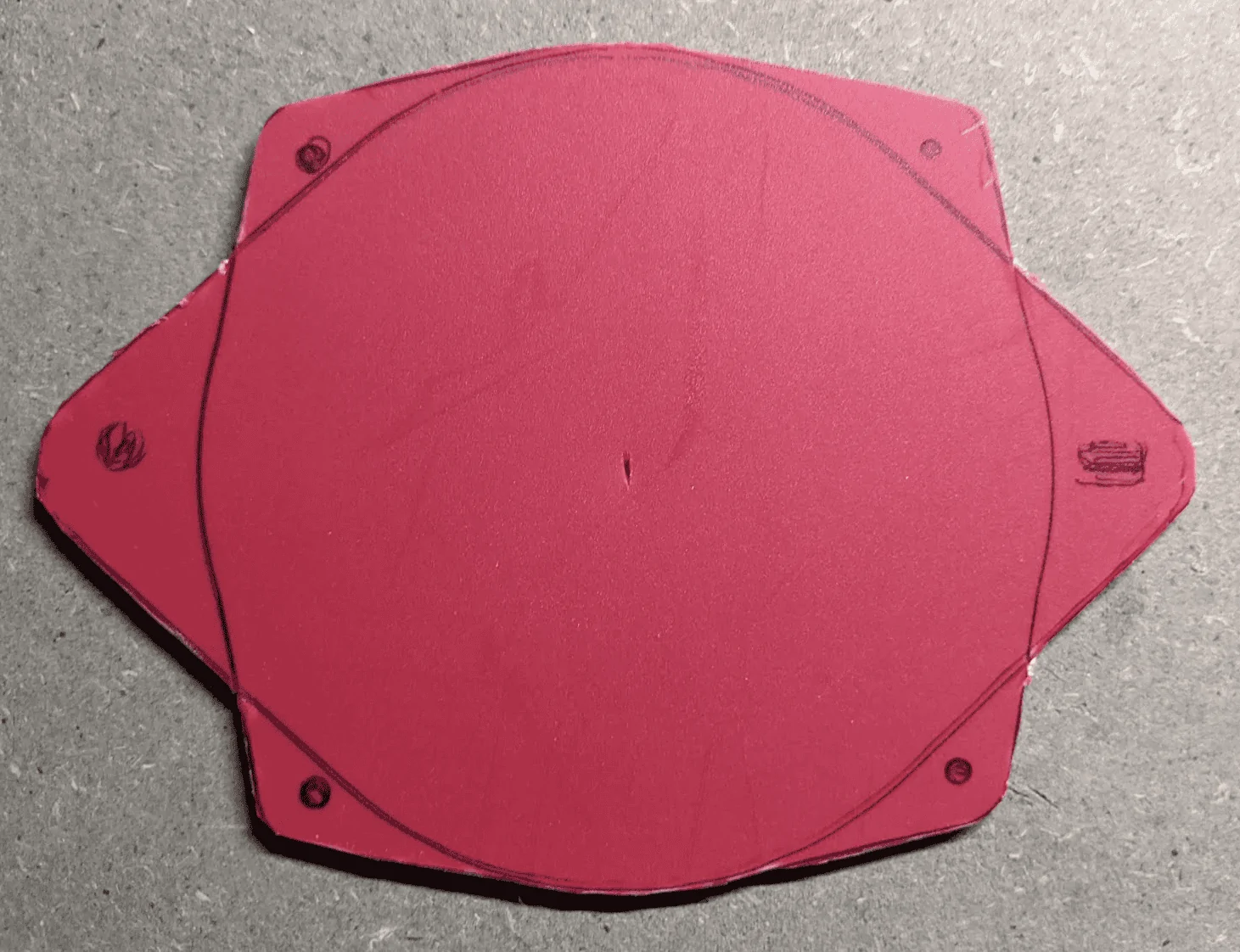

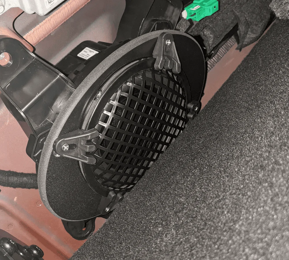

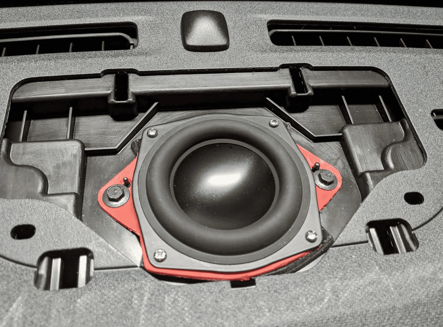

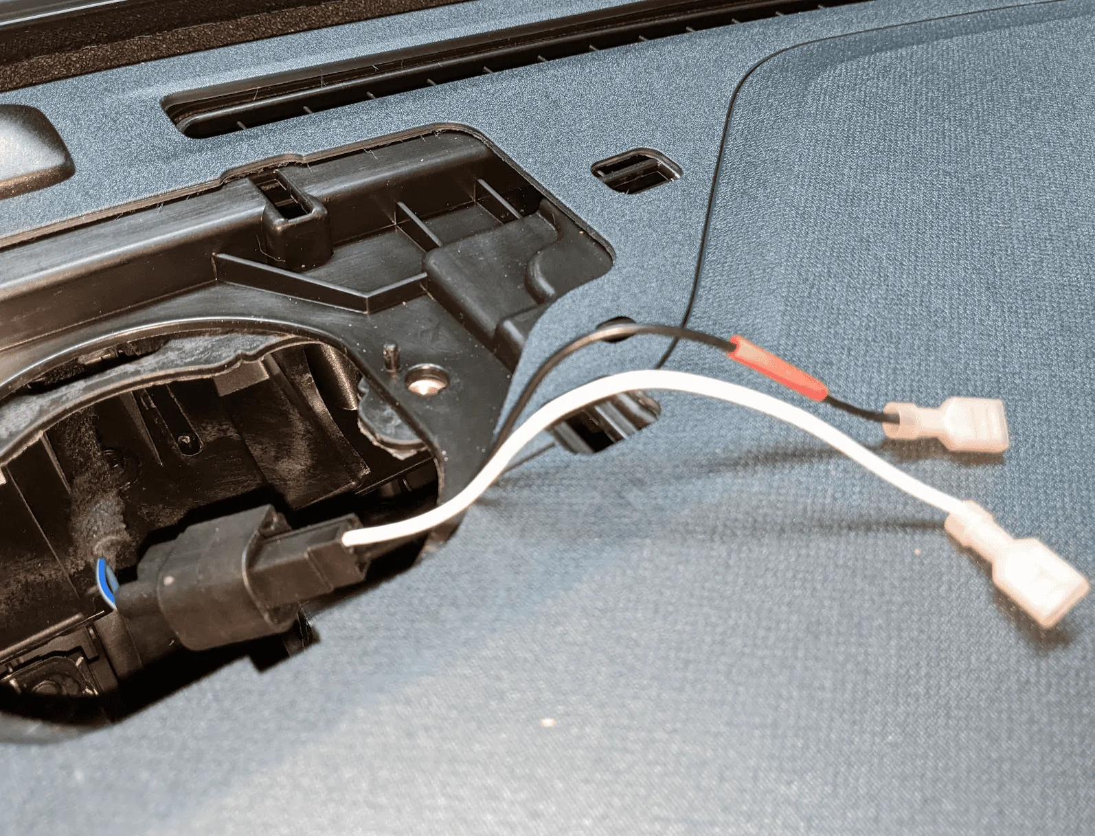

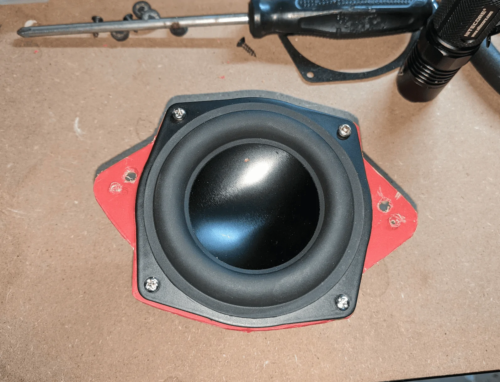

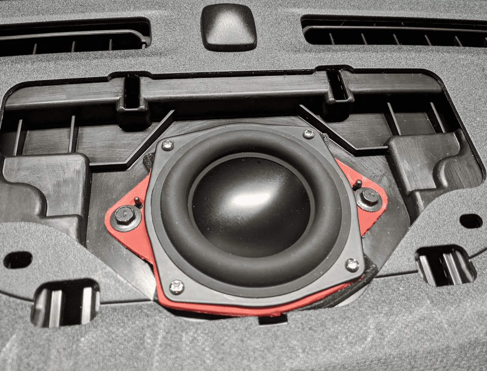

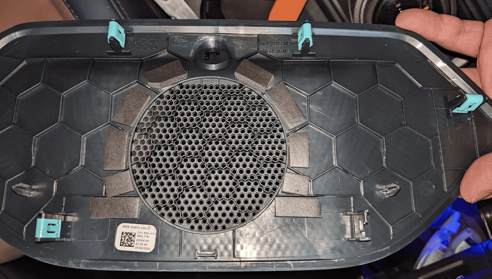

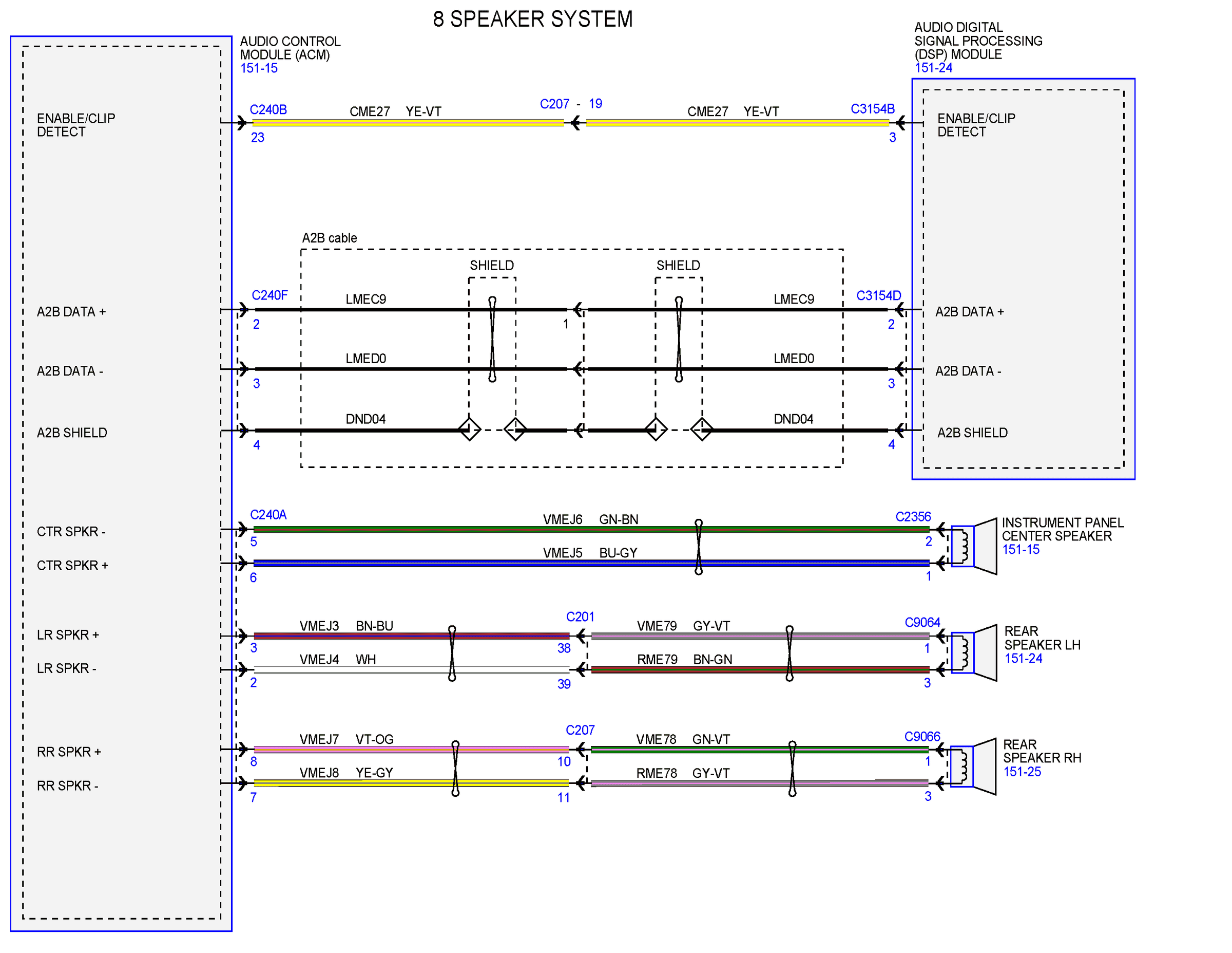

Ugh, just broke a tab pulling up the center speaker grill 😭 but 4 hours later, I got the Dayton Audio ND91-8 set up at least.. The 72-5600 adapter does work for this if you take off the fins and reverse the positive and negative sides. I wrapped the black wire with red tape to indicate positive here :)
From https://www.mavericktruckclub.com/f...for-remote-in-audio-harness.12949/post-258270
Ford Maverick Taco Truck + Prius = TruckPrius 1702886447325
Ford Maverick Taco Truck + Prius = TruckPrius 1702805392245
Ford Maverick Taco Truck + Prius = TruckPrius 1702805510977
Had some trouble mounting it because the mounting holes are like half an inch too narrow (is this because they're for home audio maybe?) I rigged up this adapter plate cut from a hard plastic tub I was getting ready to junk.
Ford Maverick Taco Truck + Prius = TruckPrius 1702805306126
Ford Maverick Taco Truck + Prius = TruckPrius 1702805466078
It's weird looking, but it works and completely non-destructive with this approach (other than the clips...)
Ford Maverick Taco Truck + Prius = TruckPrius 1702805494614
A little window insulation to push the cover up from the speaker's surround. (hope it's enough)
Ford Maverick Taco Truck + Prius = TruckPrius 1702805591700

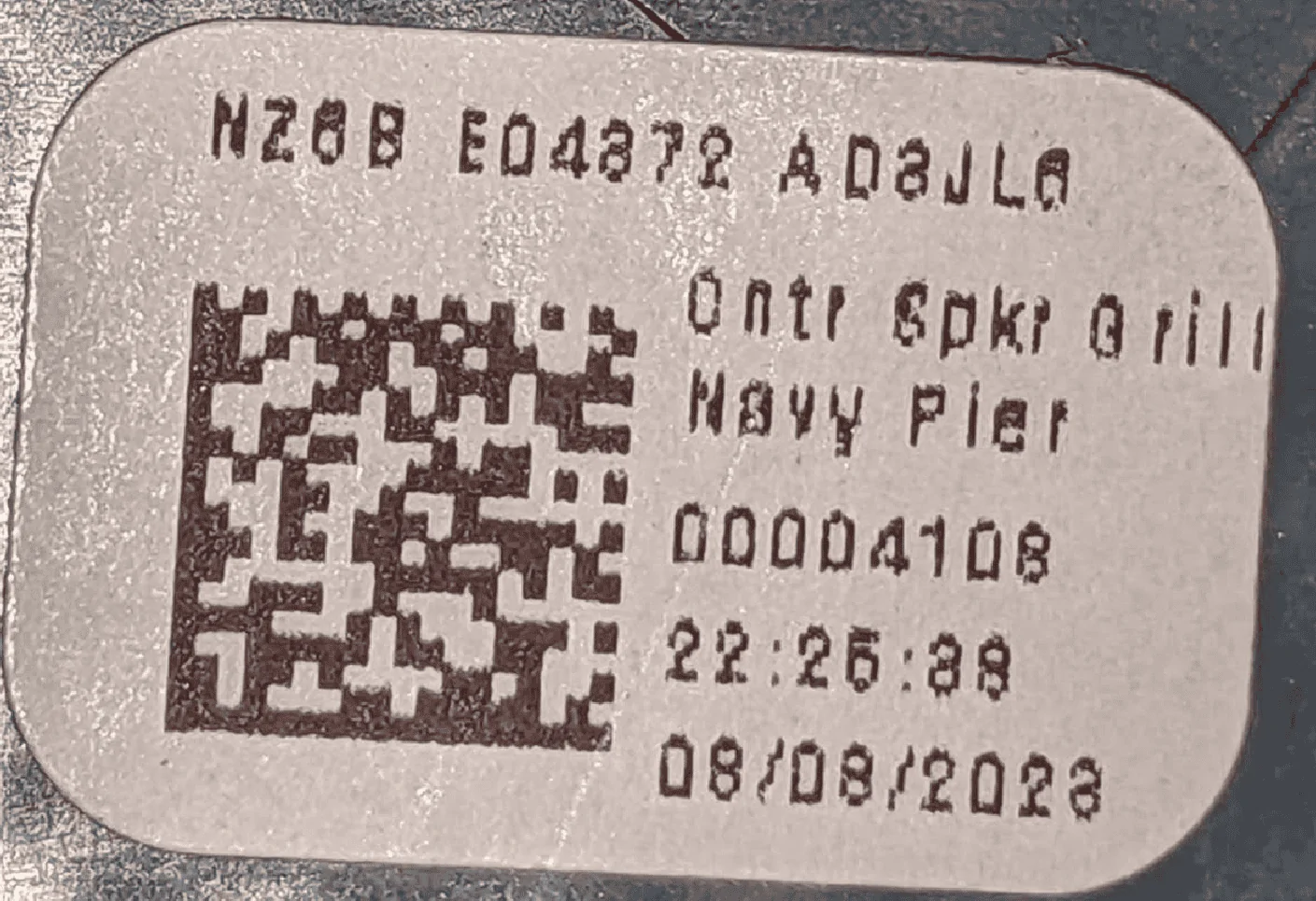

Having a hard time reading the part number for this.. Think it's "NZ6B-E04372-AD3JL6" ? Seems to be NZ6Z6004374AA
Ford Maverick Taco Truck + Prius = TruckPrius 1702805948375
This swap brought the volume of the center down a good bit and seems to have gotten rid of the tinniness. Nice that it was 8 ohms already so I didn't need to add a resistor.
