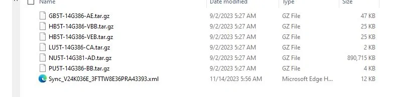

I have Ver. 3.4.22200, Ford.com says need to do Ver 3.4.23188. Downloaded file to prepare to do thumb drive update. Folder empty. Ford confirmed and said to wait or do WIFI.

That's strange that it was empty. I used the thumb drive method to update mine because the WiFi method never worked for me.

The file is corrupted. Same thing happened to me. Then, I was at the dealer last week and the same thing happened when they downloaded it.

Same here. Downloaded it. Go to open it like instructions say and it says nothing is there. Click on properties and it shows something is there.

Same problem here. Wi-Fi spins forever trying to find the update, so I downloaded from Ford for the USB method -- and WIndows says the zip file is empty (at over 800mb). My plan is to have the dealer do the update when I go in for the 23E09 recall in 4 weeks. (Yeah, Feb 13 is the soonest the dealer can do it.)
