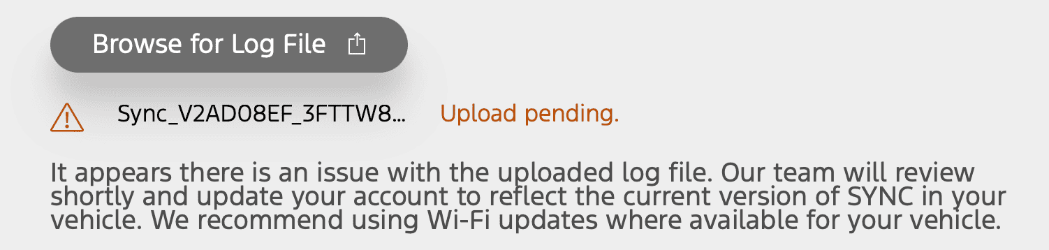

Even though it updated successfully and my Mac tells me so, when I try to upload the XML file to Ford so that they can update the record of what SYNC version I am running on their side, I get the below message. Im not too worried about it. I'd still rather do USB method. Updating over WiFi did not work for me the last time and it was also taking forever. This was quick and easy.
Same thing happened when I did the update via USB. Notified Ford by their Chat board and was told it would update down the road sometime when reporting to the Ford Server. There seems to be an issue with the upload file in original update instructions. Anyway I left them the info on my vehicle and I assume it uploaded the correct version sometime later.
