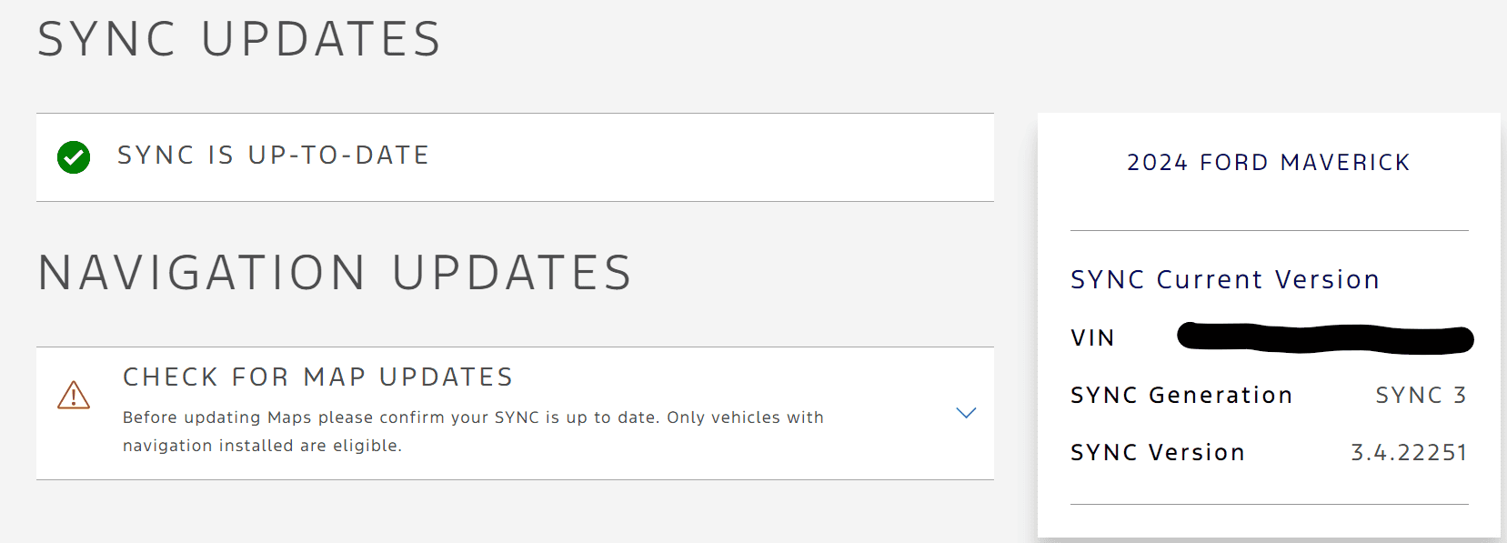

I just checked my Sync 3 and it said is was up to date with version 3.4.22251.
Any idea why it doesn't recommend that later version 3.4.23188?
Is the version specific to certain builds, perhaps?

It must be. I have a 23 Hybrid and you have a 24 Eco.
