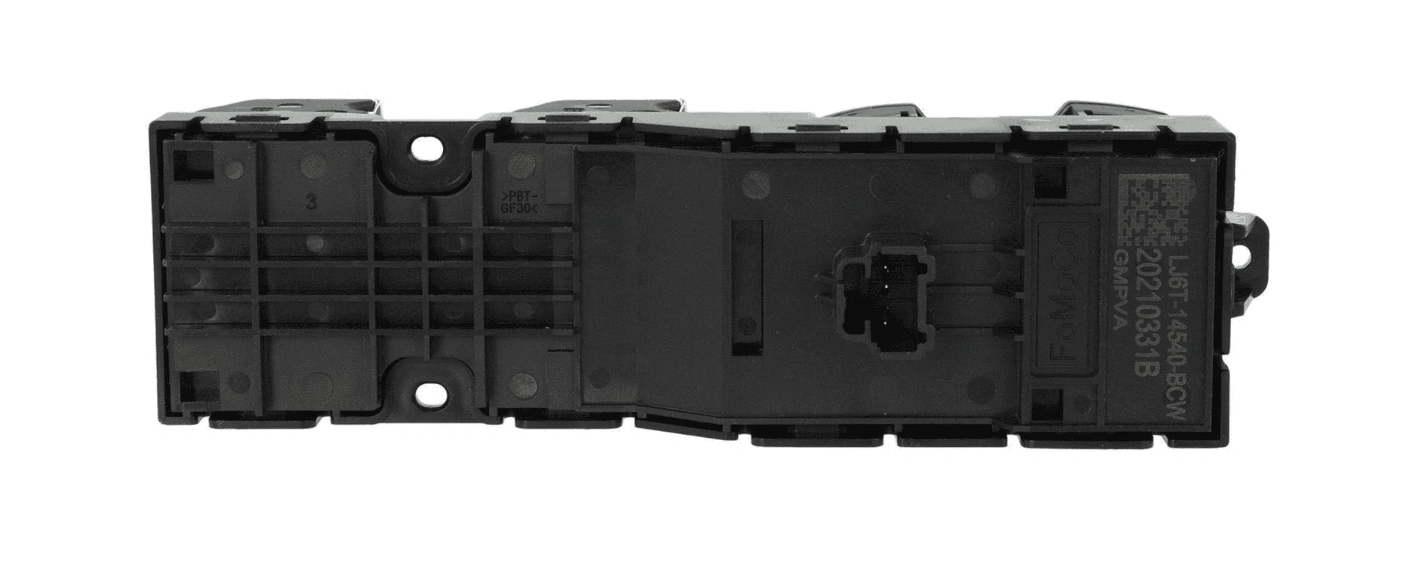

Went trolling the Ford parts since it feels silly my wife's Subaru, that cost us $6k less than my future truck will, has a dual direction, one-touch driver's window.
Motor assembly is different, part number on the motor ends in "BA" instead of "AA":
One touch, up and down:
https://parts.ford.com/shop/en/us/e...ctors/window-operating-motor-13359865-1?pdp=y
M1PB-14A366-BA
9923395
One touch, down only:
https://parts.ford.com/shop/en/us/e...ctors/window-operating-motor-13360703-1?pdp=y
M1PB-14A366-AA
9923395
Driver's switch panel: SW8562
No link on Ford's site, can find pictures and data on eBay and elsewhere.
All parts are currently out of stock, motor will run about $70, the switch around $30.
Switch is connected by CAN (see picture), will most likely need some FORscan tinkering to enable.

Oof, looks like the wiring is a lot more involved, I was assuming CAN control was also in play on the XL/XLT windows. The connectors are completely different, looks like the standard windows are controlled directly by the switches.
Sounds like as others have found, it's probably not worth the effort. :confused:
