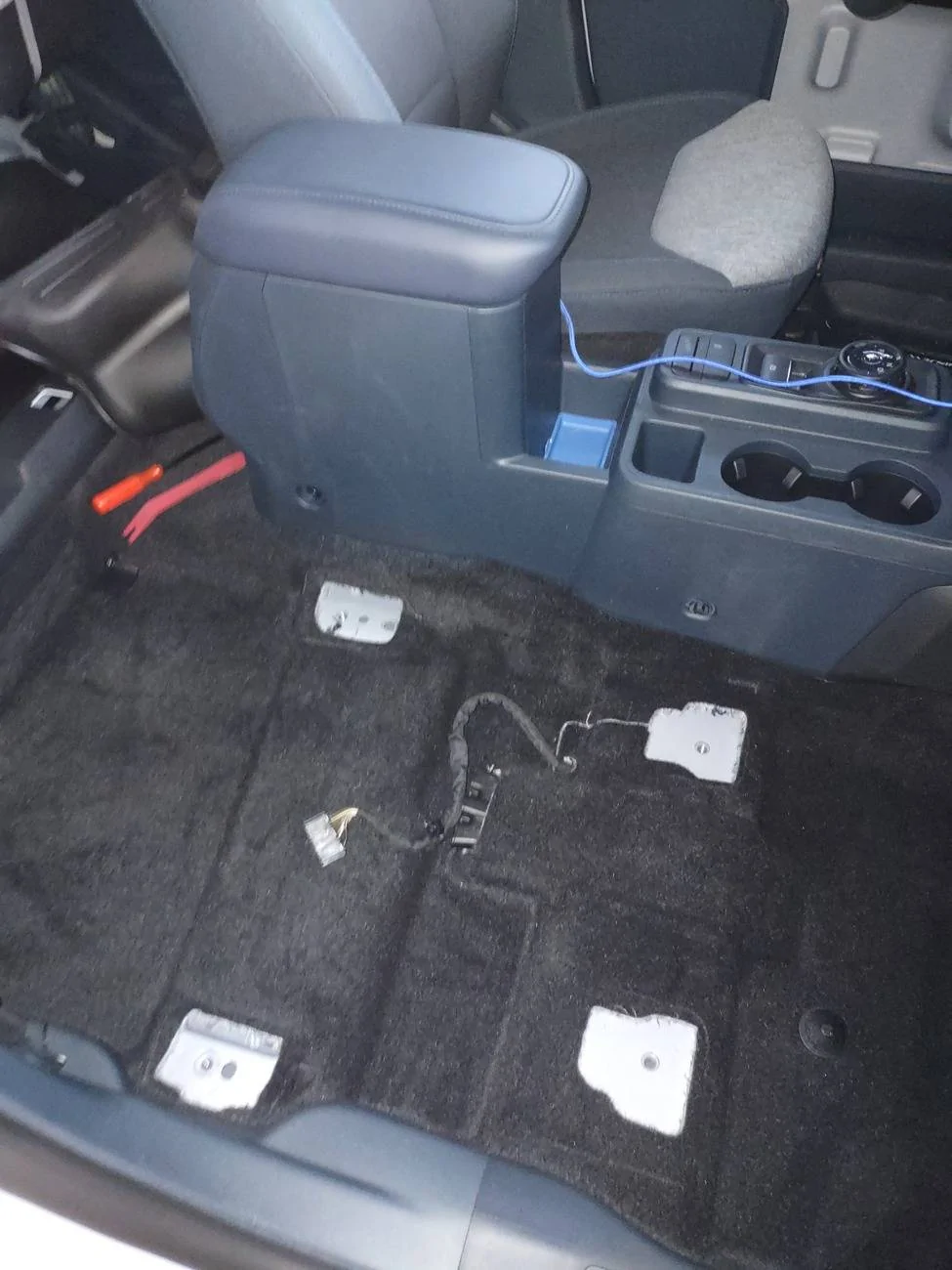

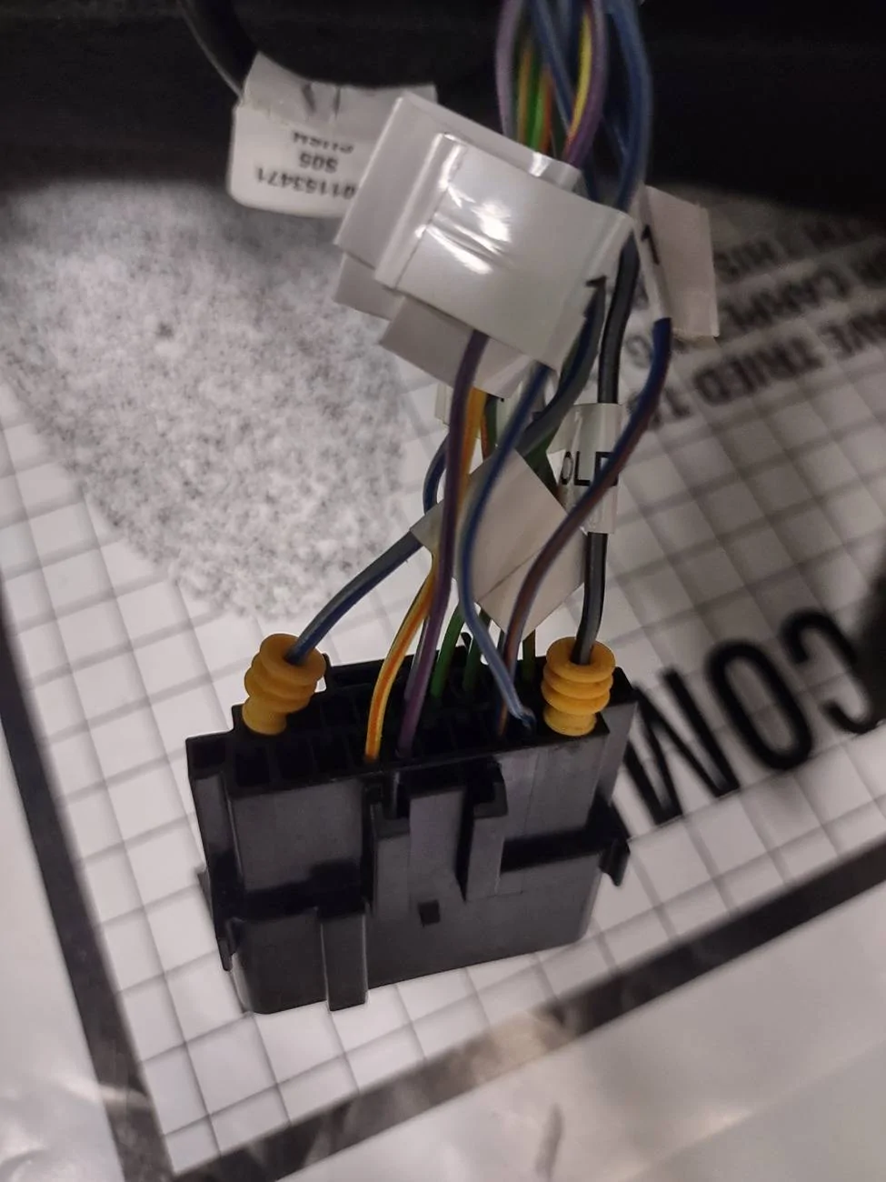

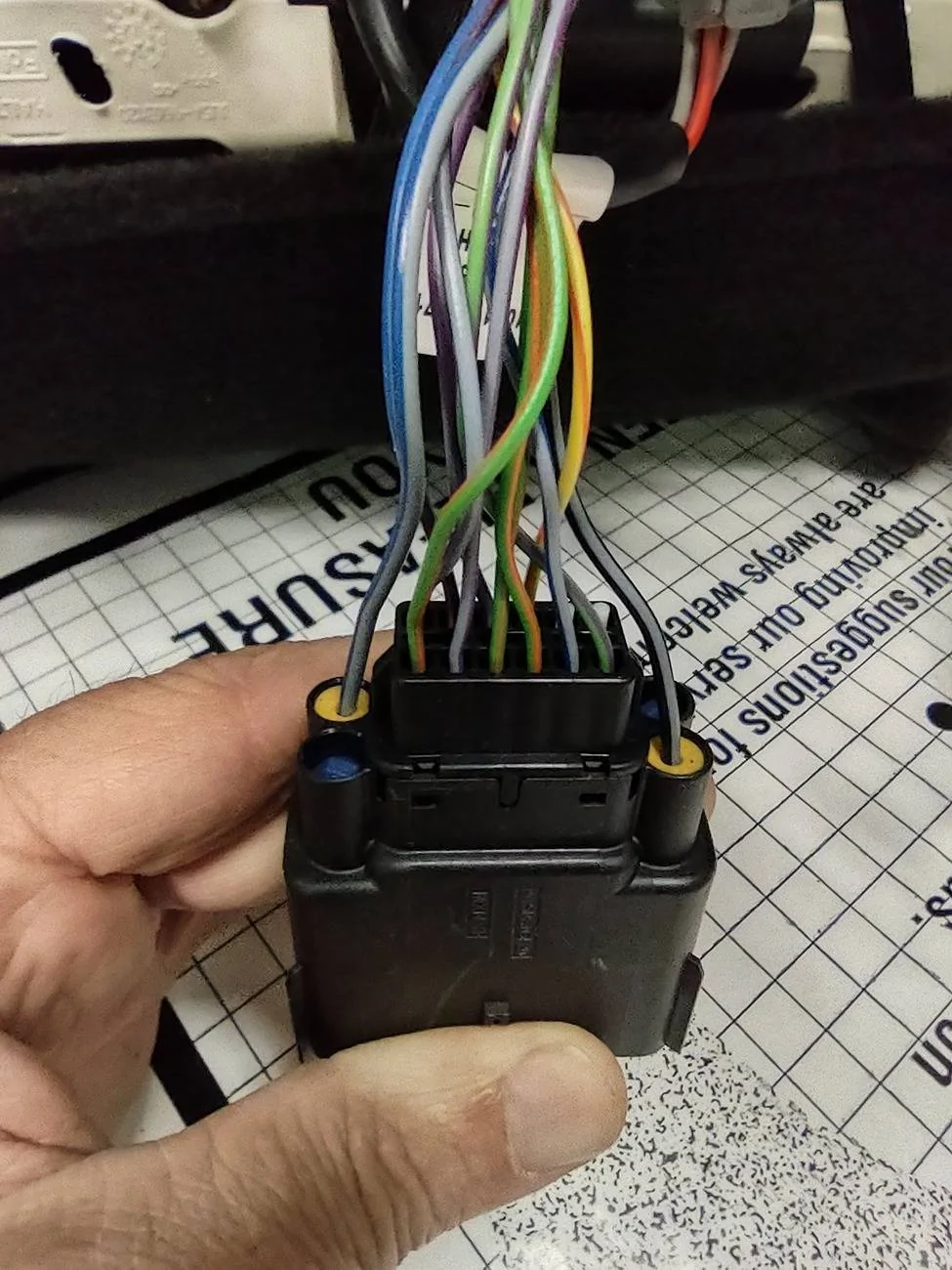

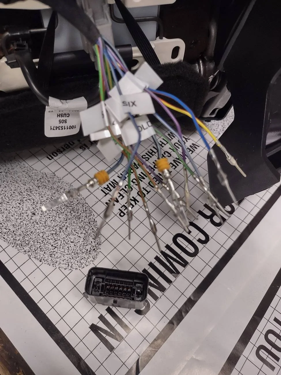

I got started on this project. I de-pinned the original connector under the '22 passengers seat and installed them in the '25 connector. I got lucky and the pins themselves fit the new plug with out having to redo every pin, even the two bigger pins fit in the bigger slots on the '25 connector.

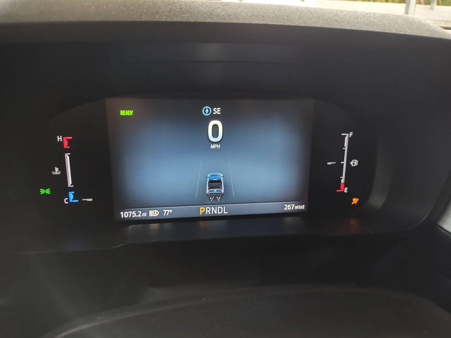

Swapped the seats out, and plugged everything in. Started the truck and got a seat belt fault on the passenger seats air bag. I went back under to verify the wires were in the right pins, the colors matched, and were not reversed. I unplugged the connector to verify none of the pins got bent also. Everything else worked, the seat belt sensor, the passenger air bag 'on/off light etc. The connector is wired correctly. The only wire not in the correct pin is '22 #9 is in '25 #10 because of its size. I noted this on my wiring diagram so when I bring the power wires for the heated seat that I bring it to #10 vice #9.

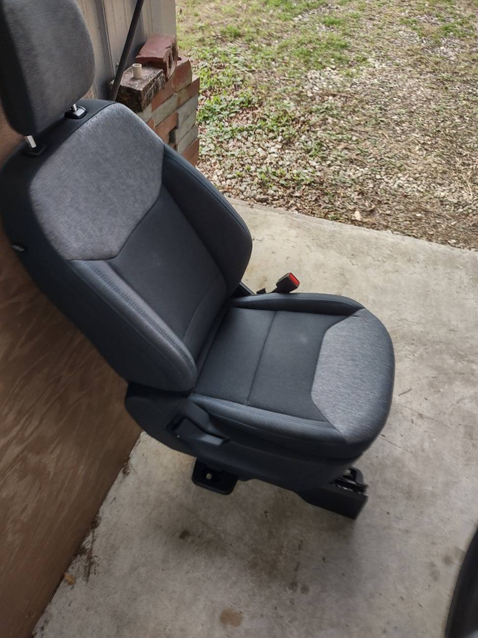

Anyone have any insight on why the airbag fault? other then the seats are from a crashed Maverick. The airbags didn't deploy and the seats look brand new.
@BlueSpec1 any ideas, can I just clear this? The fault already has been reported to Ford and I got a notification on my phone.
