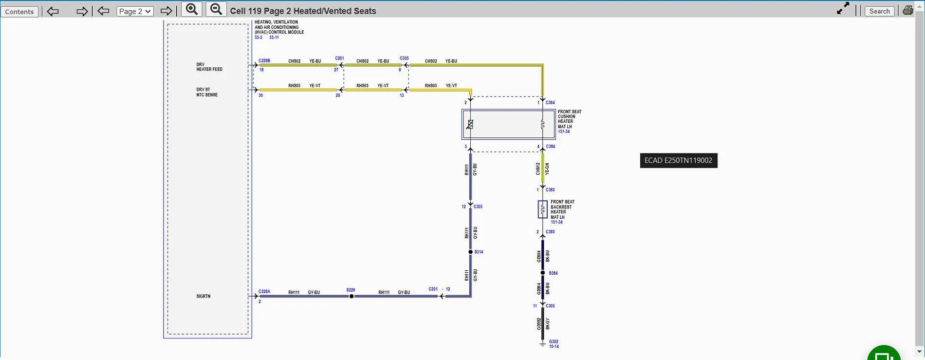

DARNON: You seem to be able to get schematics of plugs, is there anyway you can get them and post for both the main plugs under the front seats. I'd like to know what each pin is supposed to be wired. for? Thanks in advance.
BlueSpec1
Gene
Jul 10, 2022
779
796
23 F150 XLT Powerboost, 22 Escape Plug-In, 23 Bolt EUV

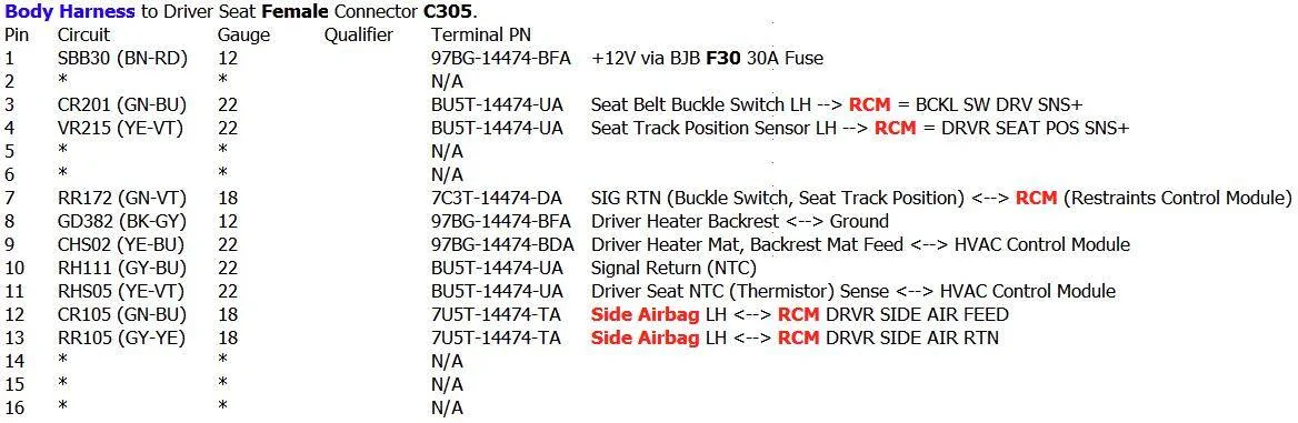

Driver Heater Feed @ Seat
C364 Pin 1--->Front Seat Cushion Heater Mat LH<-->C364 Pin 4<---->C365 Pin1---Front Seat Backrest Heater Mat LH--C365 Pin2--> G302 Ground
Driver NTC Sense @ Seat = C364 Pin 2-->NTC-->C364 Pin 3--> SIG RTN (HVAC) Control Module
Passenger Heater Feed @ Seat
C334 Pin 1<--->Front Seat Cushion Heater Mat RH<-->C334 Pin 4---->C335 Pin1---Front Seat Backrest Heater Mat LH--C335 Pin2--> G304 Ground
Passenger NTC Sense @ Seat = C334 Pin 2<-->NTC<-->C334 Pin 3<-->SIG RTN (HVAC) Control Module
C334 ( Pigtail Kit WPT-1076)
Pin, Circuit, Gauge, Circuit Function, Qualifier
1, CHS07 (GY-BU), 16, CTRL MOD. - HOT/COLD SEAT # PASSENGER CUSHION HEATER +, manual seat
2, RHS10 (BU-OG), 20, CTRL MOD. - HOT/COLD SEAT # PASSENGER SENSOR CUSHION TEMP., manual seat
3, RH111 (GY-BU), 20, CTRL MOD. - CLIMATE # DOOR POSITION SENSORS
4, CHS12 (YE-GN), 16, HEATER - PASSENGER CUSHION / BACK
C335 (Pigtail Kit WPT-1809)
1, CHS12 (YE-GN), 16, HEATER - PASSENGER CUSHION / BACK
2, GD382 (BK-GY), 16, GROUND - CROSS MEMBER MIDDLE DRIVER OR LEFT, manual seat
C364 ( Pigtail Kit WPT-1076)
1, CHS02 (YE-BU), 16, CTRL MOD. - HOT/COLD SEAT # DRIVER CUSHION HEATER +
2, RHS05 (YE-VT), 20, CTRL MOD. - HOT/COLD SEAT # DRIVER SENSOR CUSHION TEMP.
C365 (Pigtail Kit WPT-1809)
1, CHS12 (YE-GN), 16, HEATER - DRIVER CUSHION / BACK
2, GD382 (BK-GY), 18, GROUND - CROSS MEMBER MIDDLE DRIVER OR LEFT

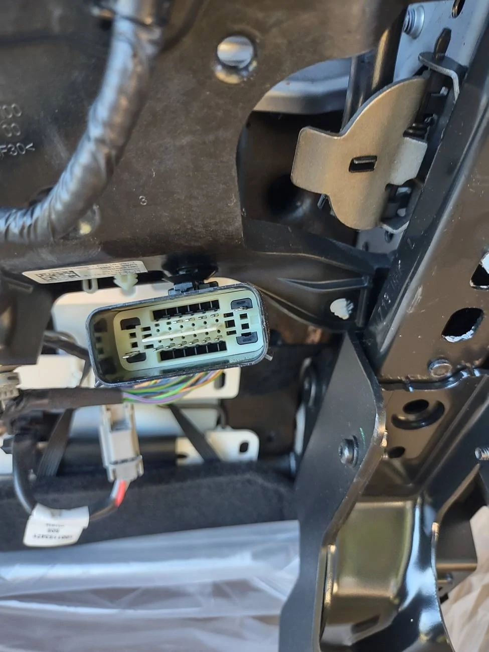

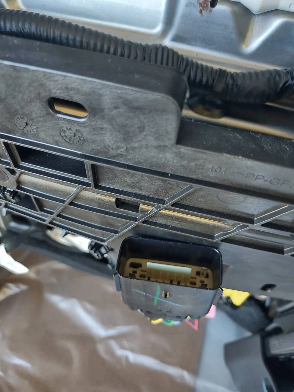

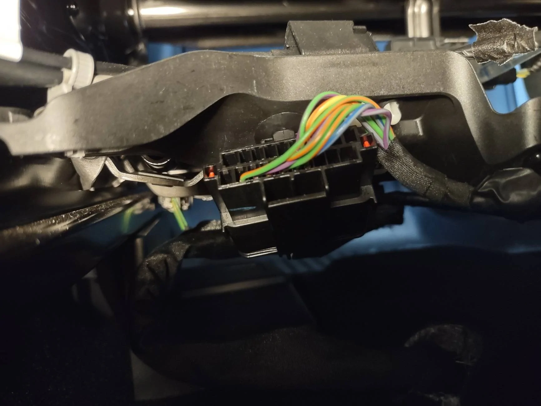

Here is where I stand with this swap.
The 2025 with all manual seats has a completely different plug for C305. The main plug under the seat. I want to leave the wiring harness in my truck stock. I am going to have to buy 2 more of the plugs from the 2025 seats and unpin and rewire the plugs under the 2022 power/heated seats. I am looking for the part number for the plugs. I'm working on where to get the power from for the heated seats and power drivers seat.
If you have a 2022 -2024 XLT without the Lux package there is a possibility that your Maverick is already wired correctly at C305 under the seat and this swap would be much easier. All you would need otherwise is the HVAC control panel from an XLT with LUX package, and swap it out also.
Ford Maverick Swap power seat into manual truck Driver 25
2025 Drivers seat C305
Ford Maverick Swap power seat into manual truck Pass 25
2025 Passengers C305
Ford Maverick Swap power seat into manual truck Drivers 22
2022 Drivers power/heated C305
Ford Maverick Swap power seat into manual truck Pass 22
2022 Passengers C305

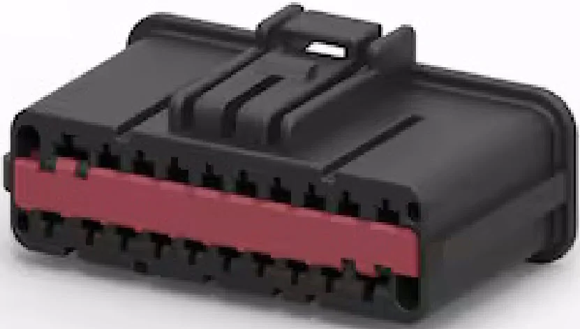

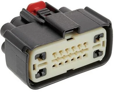

From the 2025 connector picts, look like TE Connectivity:
1.5/2.8 CONNECTOR SYSTEM, RECPT AND TAB
- https://www.te.com/en/product-CAT-A11-T273.html?r=2&compatible=1326359-1
2098377-1
https://www.te.com/en/product-2098377-1.html
https://www.mouser.com/ProductDetail/TE-Connectivity-AMP/2098377-1?qs=%2BD5sUuPmlArLoUm7oXbSgQ==
Description: Automotive Connectors 20P PLUG ASSEMBLY UNSEALED HYBRID A-KEY
Number of Positions: 20 Position
Ford Maverick Swap power seat into manual truck TE 2098377-1 20P PLUG ASSEMBLY UNSEALED HYBRID A-KEY - Housing for Female Terminals
Picts: https://connectorexperts.com/i-31643830-cet2028f.html
2098380-1
https://www.te.com/en/product-2098380-1.html
https://www.mouser.com/ProductDetail/TE-Connectivity-AMP/2098380-1?qs=kTKVN3NWb5EdqxRgKDWt9w==
Description: Automotive Connectors 20 POS HYBRID UNSEALED CAP KY-A STD CLIP
Ford Maverick Swap power seat into manual truck TE 2098380-1 20 POS HYBRID UNSEALED CAP KY-A STD CLIP - Housing for Male Terminals.jpg
Picts: https://connectorexperts.com/i-31643831-cet2028m.html

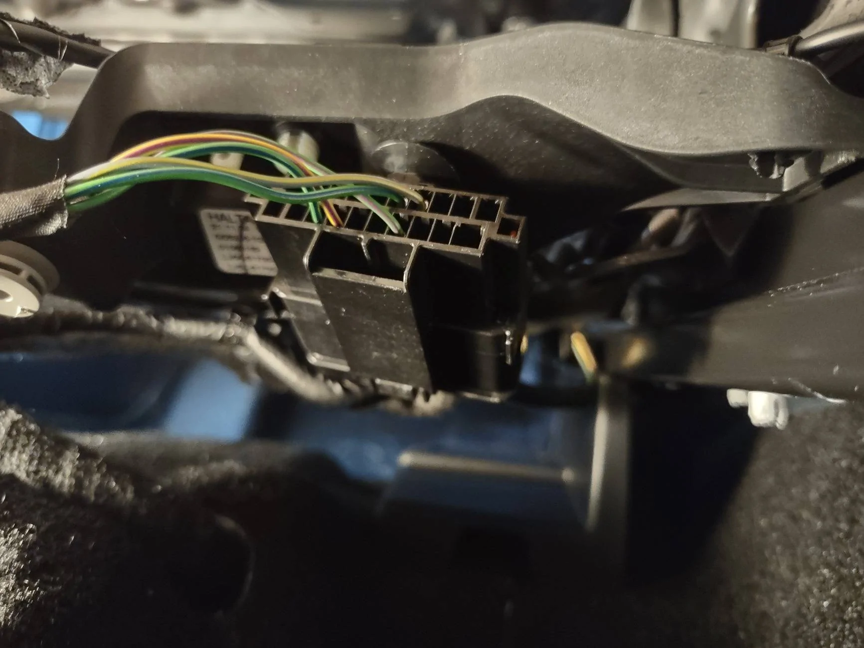

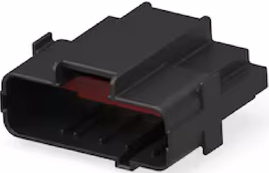

The 2022 connector picts, look like Molex MX150 Hybrid:
https://www.molex.com/en-us/products/part-detail/349861601
Part Number: 349861601
Engineering/Old PN: 34986-1601
MX150 Hybrid Mat-Sealed Male Connector Assembly, Dual Row, 16 Circuits, Keying Option A, without Connector Position Assurance, Black
Product Family: MX150 Connectors
https://www.mouser.com/ProductDetail/Molex/34986-1601?qs=0kFKDc1CZSkdv868Y0x/BQ==
Ford Maverick Swap power seat into manual truck 1740549557534-sd
https://www.molex.com/en-us/products/part-detail/349851601
Part Number: 349851601
Engineering/Old PN: 34985-1601
MX150 Hybrid Mat-Sealed Female Connector Assembly, Dual Row, 16 Circuits, Keying Option A, Black
https://www.mouser.com/ProductDetail/Molex/34985-1601?qs=jVq0LXptKgm6Lp/VFMBTOw==
Ford Maverick Swap power seat into manual truck 1740549581459-2

I have ordered 2 male connectors to put under the '22 seats, and the pins that go in them. I have worked out the wire location from the '22 seats to the '25 plug.

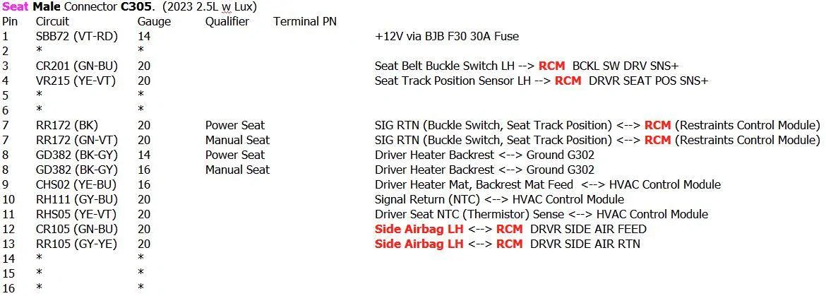

Here is the decision that I am having: Do I try to do everything thru C305 (drivers) and C331(passengers plug? or by pass the plugs all together and bring power straight to wear it is needed.
DO I try to wire the connectors for everything? or do bring power straight to the drivers seat at the the control switch pins 10 (+) and 11 (-)? same for the heated seat Bring the (+) to C365 pin 1, and (-) to C364 Pin 2 and call it complete.
Currently when I swap connector the under the seat male connection (C305):
Pins '22 to '25
1 Move to Pin 10 + for power seat
2 Empty
3 CR201 - Pin3 CR301
4 VR215 - Pin 4 VR215
5 Empty
6 Empty
7 RR172 - Pin 7 RR172 *color doesn't match
8 Move to Pin 11 main ground for heat/power
9 CHS02 - 9 power for heat
10 RH111 - Move to pin 12
11 RHS05 - move to pin 13
12 CR105 - move to pin 16
13 RR105 - move to pin 17
The problem is I'm not sure what to do with the "sense" circuit from the HVAC control unit? See attached heated seat wiring diagram. I will have to have an external switch. Power will go from the BCM to Switch to Seat, I will have a Power (+) wire and a ground (-) back to the switch.
Ford Maverick Swap power seat into manual truck 25 Heated seats C305
BlueSpec1
Gene
Jul 10, 2022
779
796

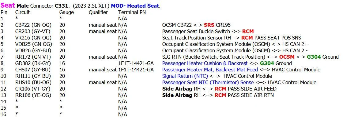

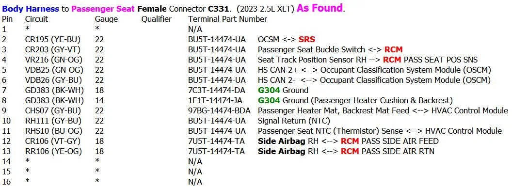

Don't need to wire NTC Sense and NTC Return since no wires back to the HVAC Control Module.
The seat bottom heat pad has the NTC Thermistor sensor.
It would give temperature feedback to the HVAC Control Module so it can adjust the voltage going to the seats to control temperature.
Power seat wiring going thru C305 on 22-24 use the larger size terminals at #1, #8.
If wired thru the 2025 connector I'd want to use the 2 larger pins (2.8mm) it has, otherwise I'd go straight to the power seat.

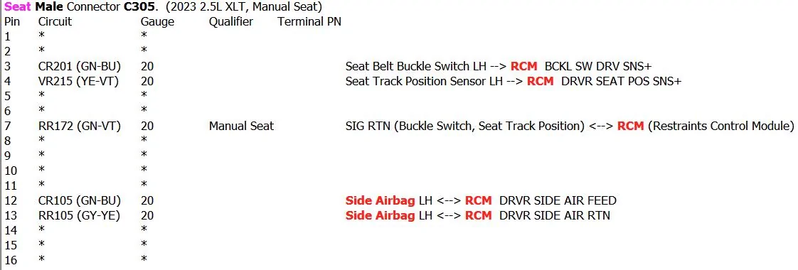

My 2023 XLT w/o power or heat:
Female C305 - As Found
Ford Maverick Swap power seat into manual truck 1740704585233-d9
Male C305 - As Found
Ford Maverick Swap power seat into manual truck 1740704639857-5l
23 manual does show the RR172 is BLACK color if have power/heated seat on C305 Female.
Ford Maverick Swap power seat into manual truck 1740704184369-n6
Ford Maverick Swap power seat into manual truck 1740705083779-aa

I see what you mean about the "Sense" circuit. I'm not sure why I got it in my head that they are connected. (like, no sense, no power).
I'm inclined to try this thru C305 using your last wiring diagram because the seats I got are out of a 2022 XLT with the LUX package. Only difference would be being no wires in #10 and #11, no sense circuit needed. Pin #7 is GN-VT for a manual seat but should still function for the buckle/Track Position. Does the same function just different color wire.
Round up of wires needed: Female side of C305
14 gauge ,+12V, 30A fused - power seat

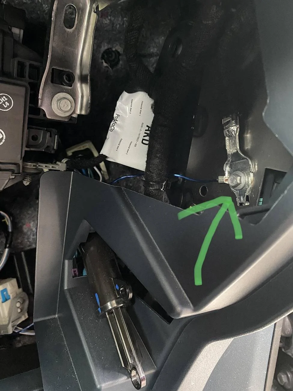

14 gauge, - ground. Thinking about from behind glove box similar to some of the after market heated seat installs threads on the forum. This grounds both the power seat and heated seat but not my external switch. Where too?
16 gauge heated seat feed ('22 pin 9). From external switch.
16 gauge external power switch heat ground. Will this work if I bound both grounds at the same point (see picture)? I think so, similar to how the one ground does both functions in the '22.
All wires would need to be moved from the '22 plug to the '25 plug. If mine were wired like yours this would be so much easier.
As you mention I'm not required to follow the '25 pin destinations. I can use any pin numbers I want., but since the largest wire gauge is 14 I am going to try an stick to the pin numbers as closely as possible. If the power and ground don't fit, I'll use the larger pin connections.
It's interesting how the wire gauges are bigger on trucks like yours without the power seat, then those with the LUX package. Seems like there was planning ahead for people to add power or heat?
Where do I find information/video on tapping the BJB? How are wires brought outside the BJB? I've seen how people get thru the firewall with other mods, not the BJB.
Ford Maverick Swap power seat into manual truck Heated seat Ground
