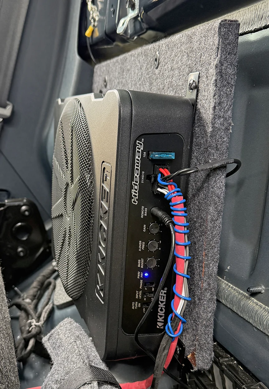

I recently added a Kicker 200.4 amplifier, which I ordered with the PlugNPlay kit that featured the subwoofer harness cabling. The subwoofer recently arrived so I thought I would go ahead and install it.

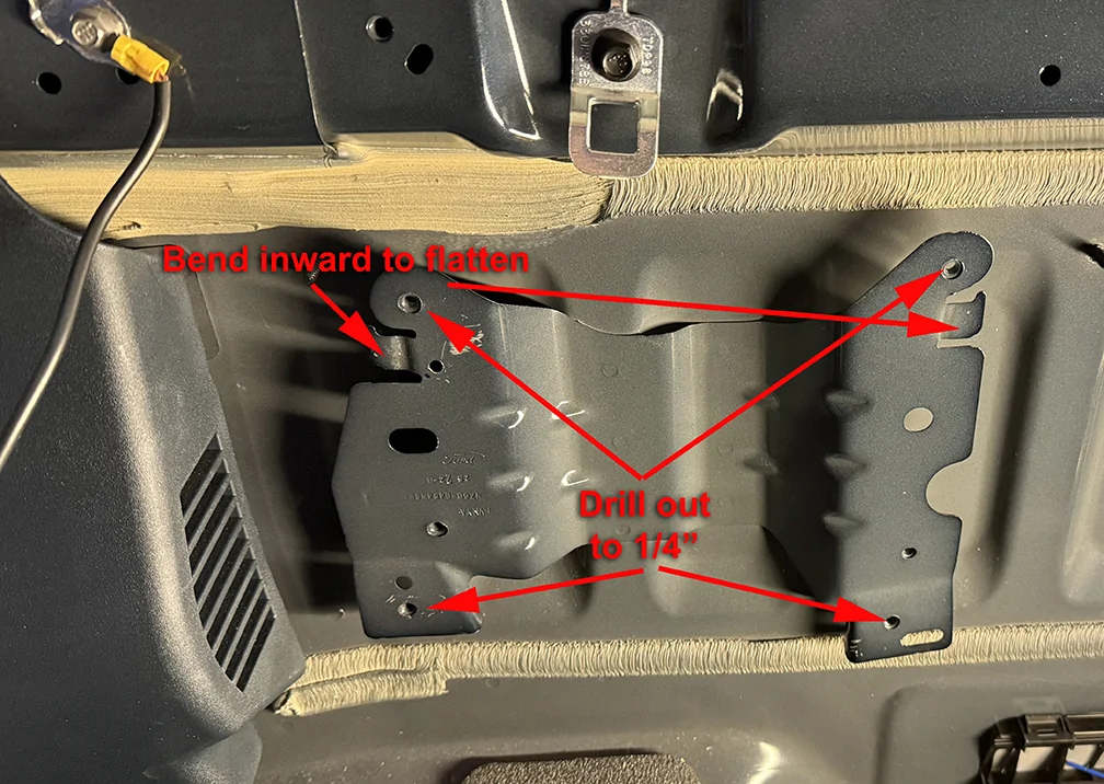

I'm not sure why some folks are cutting/removing the factory bracket that is used for the Lariat amplifier, the bracket worked perfect for my installation. The only thing I really had to do is bend the tiny upper side brackets so they were flat, really easy to do. I also bent the bottom tabs inward a bit to that the 4 mounting points were flush. I drilled out the 4 holes shown with a 1/4" drill bit. Tip: rotate the drill back and forth in a circular motion to slightly enlarge the holes, it will make it easier to slide the 1/4" bolts through.
Note: The bottom two mounting holes had a nut welded to the back, I just drilled right through the nut. The mounting bolts I bought would not fit into these existing nuts.
Ford Maverick Kicker 51HS10 Subwoofer install - 2022 Maverick XLT HS10_01

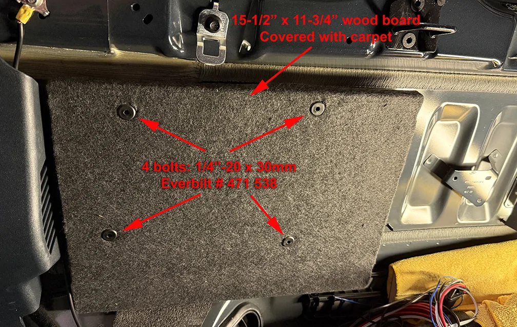

The 1/2" piece of plywood that I used I just happened to have laying in my garage wood stash, I used it the size it was which happened to be perfect. I mounted the board so it was flush to the piece of factory foam on the bottom below the bracket.
I used a paper template to mark the 4 bolt holes, and drilled them with a 1/4" bit, then I glued a piece of carpet to the board.
The bolts I found at Home Depot, I wanted ones with a flat top and these were marked as designed for furniture use. They are designed to be used with a "sleeve" type nut, but I just bought 4 quarter inch nuts.
Since the nuts cannot be reached in the back to hold them for installation of the bolt, I simply used some very strong packaging tape and taped them to the back of the screw hole, then carefully screwed each bolt to the nut. No problem tightening them, the nuts did not slip.
Ford Maverick Kicker 51HS10 Subwoofer install - 2022 Maverick XLT HS10_02
I mounted the sub to the board with the screws that were supplied with the subwoofer. It's best to drill pilot holes for those screws in advance of mounting the board to the vehicle bracket, as once the board is mounted it's hard to get a drill in the tight space to drill the pilot holes for mounting the subwoofer.
Note: Install the 2 lower Subwoofer brackets that are mounted to the back of the subwoofer so that they are at a 90 degree angle, this allows the subwoofer to be mounted at the very bottom of the backing board.
To give the subwoofer a little more "cushion", and to keep it slightly away from the four flat mounting bolts (so as to not scratch the back of the subwoofer), I attached four 1-inch round "peel & stick" "Gorilla H147 Pads" (Furniture Gripper Pads) to the back of the subwoofer. They are made of rubber (vs felt) which was ideal.
Finished result. The sub is mounted very securely, you can push/pull on the mounting board and it doesn't have any give at all:

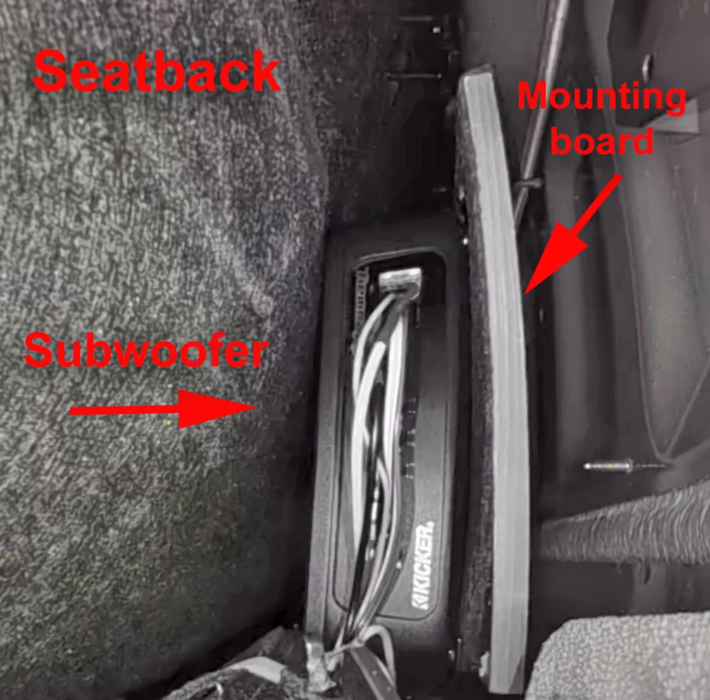

I was trying to figure out a way to determine how much room exactly there was between the subwoofer and the seatback when the seatback was fully closed... then I thought of using one of my low-light Ring camera's... I placed the camera behind the seatback and locked the seatback into position. As seen in the photo, not really any room left, which shows the importance of mounting the sub as low as possible.

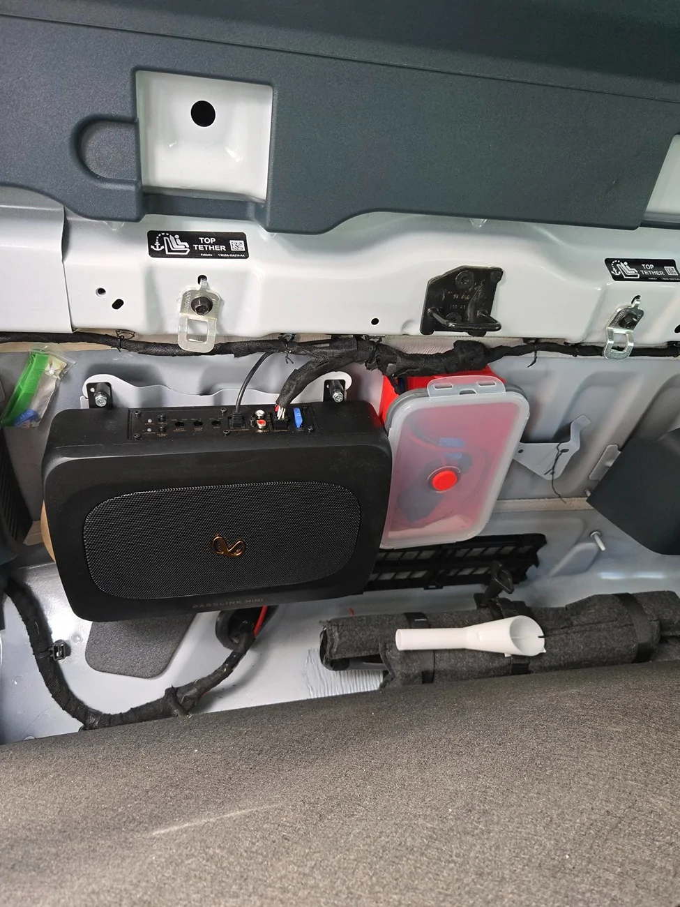

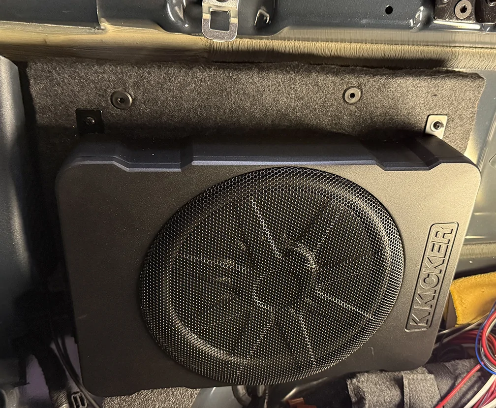

Did basically same thing using that built-in bracket using the top to holes for direct amp mounting brackets from amp.
Then i put a board in lower 3 built-in bracket holes to handle lower amp brackets into wood.
Seat not affected at all.
I even mounted a red piece of Tupperware to hold the fuse block for amp so it was no dangling as i just got around to cleaning up the wires after a year of listening.

Seat clearance no problem, see last photo in my thread above.
Looks very nice. CLEVER idea with the Tupperware!

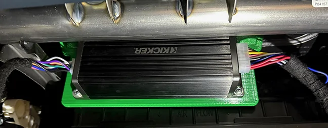

You said that you have a kicker amp. Where did you mount that?

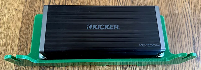

Above the glovebox, using the 3D printed bracket.
Ford Maverick Kicker 51HS10 Subwoofer install - 2022 Maverick XLT Amp_02
Ford Maverick Kicker 51HS10 Subwoofer install - 2022 Maverick XLT Amp_03

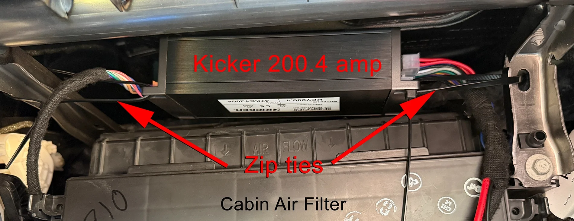

However, for those that don't want to bother with the bracket, you can simply attach the 200.4 with zip ties to the metal frame pieces as shown in the pic below. I did this temporarily while I was awaiting delivery of the 3D bracket. It's surprising how secure the amp is with the zip ties.
