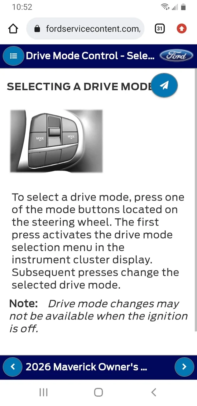

Here is the the page from the manual for the 2026
Ford Maverick Stuck in Slippery mode. Is it normal that you can't get out of slippery mode while driving? Screenshot_20260714-105228_Chrom

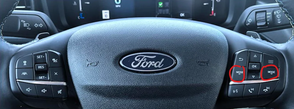

The drive mode selection menu does not "loop around". I believe you need to use the left and right drive mode buttons (arrows) on the steering wheel to cycle through the menu. Have you tried this?
That worked.
Thank you.
