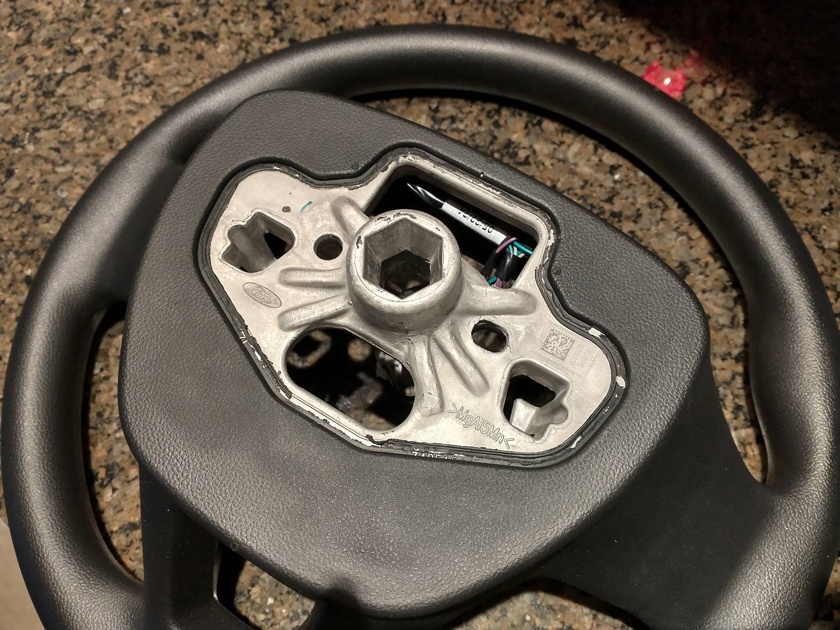

The steering shaft is hexagonal where the steering wheel bolts on, so there are only 6 possibilities, 60 degrees apart. There's not much chance it was mounted 60 degrees off center at the factory.

You can't do that. As I stated earlier in the thread, the steering shaft is hexagonal. Your only options are 60 degrees off.
The tie rod ends must be set for correct toe angle to center the wheel.
