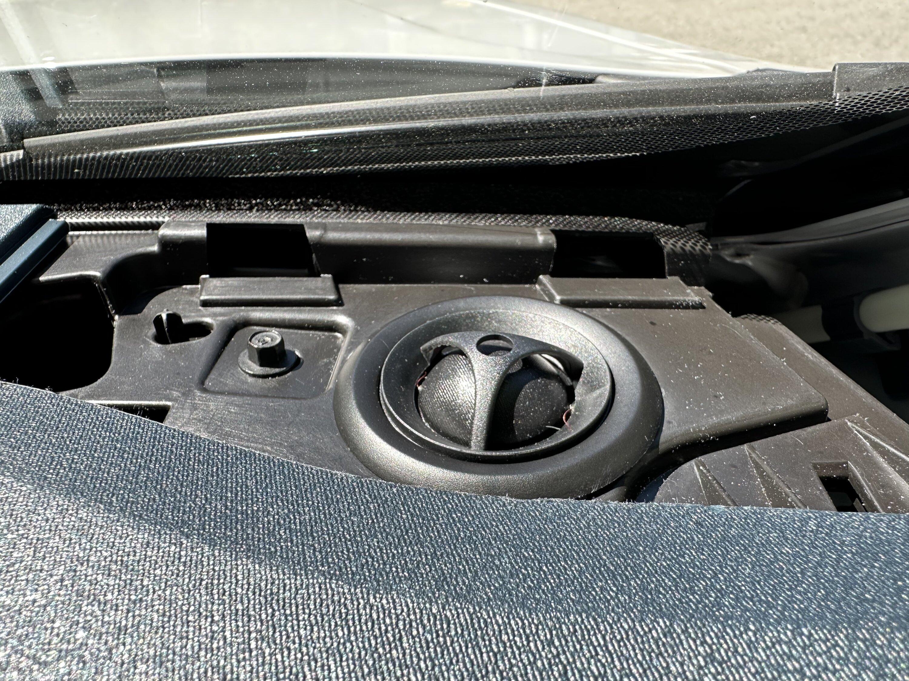

Tweeters next.
As others have experienced, these were a pain to install when compared to some of the drop-in options from Focal or Powerbass, as they required some serious dash butchery. But I really wanted Morels for this build.
Tweeters installed. The mounting bracket has a perfect friction fit, so just a couple dabs of cyanoacrylate super glue to lock everything down, and the end result looks so nice I wish I could do some kind of custom removable grille.

snowkarver, would you consider mounting the tweeters on the pillar or small black plastic triangle shaped door trim to mitigate the windshield reflection? How much do you think is left on the table having them in the stealthier/factory location?
snowkarver
snowkarver
Sep 13, 2022
237
453
BC, Canada
Volvo XC60, XLT Tremor
There really isn't a ton of room behind that door trim piece - I don't think any decent tweeter would have enough clearance. Same thing with the A pillar - I took off the trim as part of the install and most of the prime real estate is reserved for the airbag. So without some serious fabrication, I don't think either is feasible.
