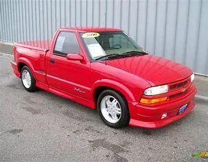

Yeah but I was thinking for the lowered speedy look, a proper ST Maverick will drag plastic as much as a 2000 S10 Extreme.
