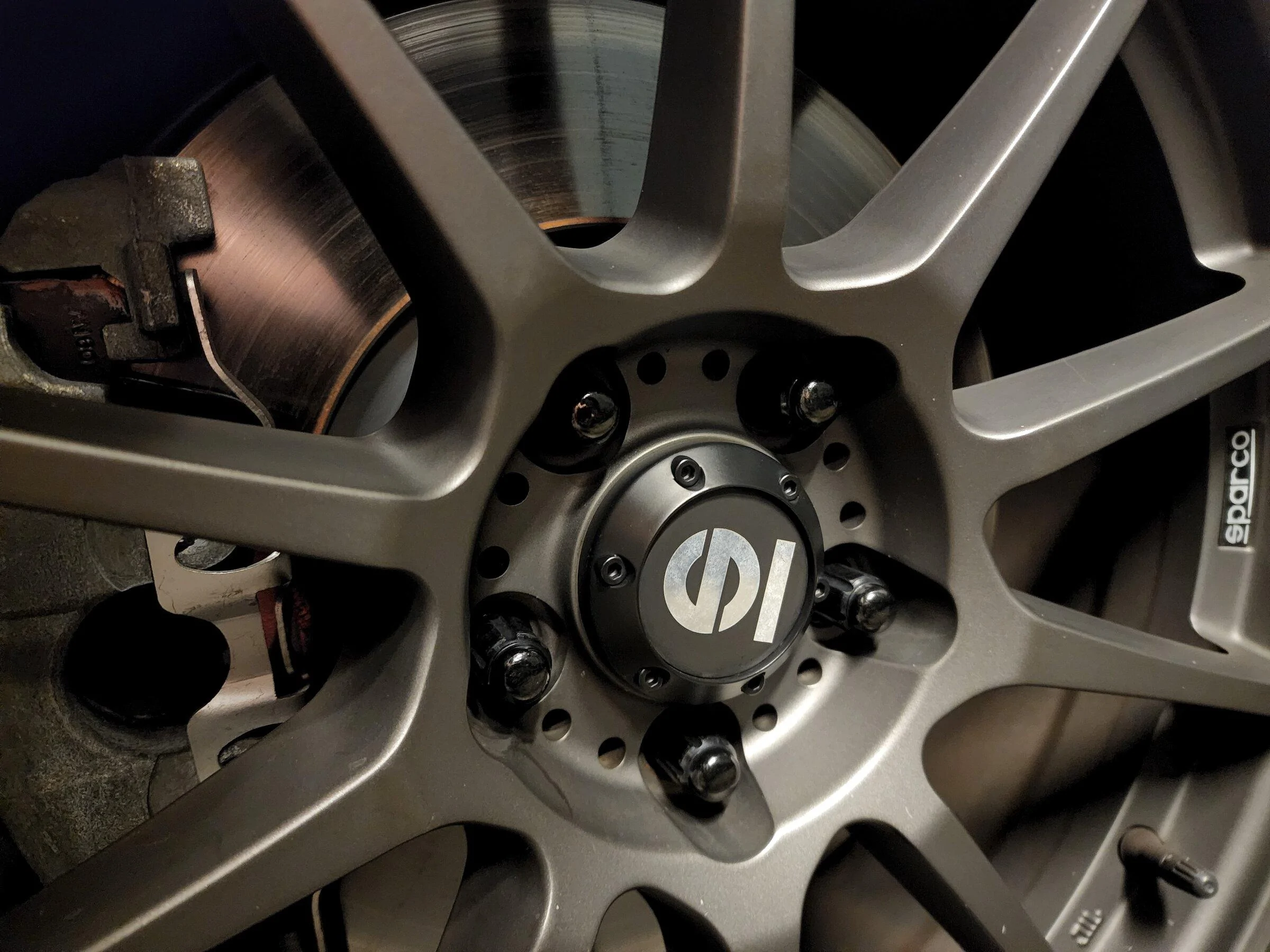

I'm looking for feedback from people that have replaced the OEM two-piece factory lug nuts. I haven't received my truck yet to verify this for myself yet and a forum search didn't return what I was looking for. I'm guessing that a 60° conical seat, 14x1.5 threads, 1.4" length, 3/4" hex lug nut would be the correct replacement specs.
I'm thinking these Gorilla nuts: https://tinyurl.com/y9q29let
