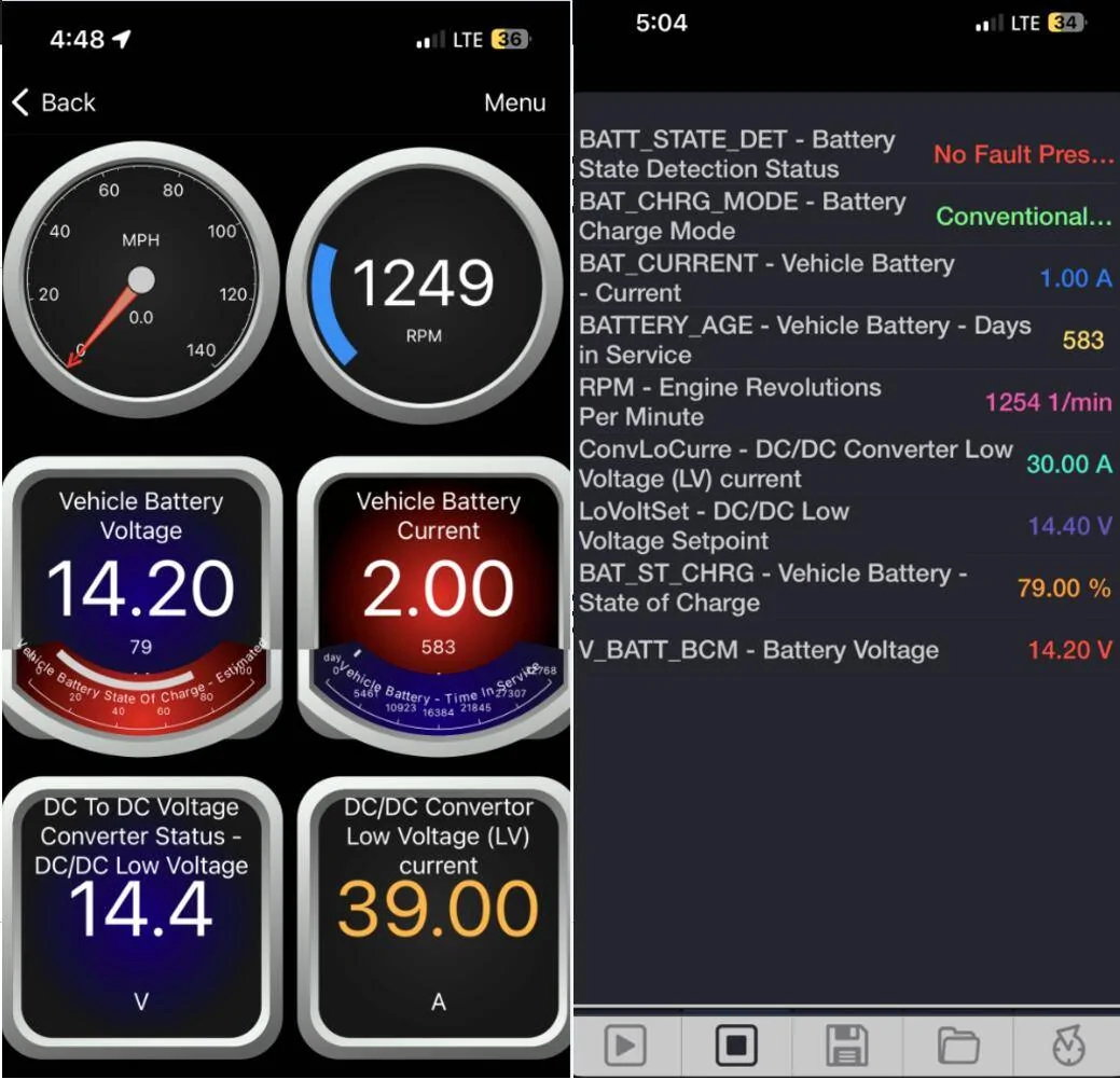

Has anyone been checking the voltage of the battery to see if its slowly going down between drives? I'm pretty sure a voltage drop was something occurring on the prior years hence leading to the batteries going bad.
I have a volt gage in the power outlet (cigarette lighter). I see it as high as 15.3 volts, is this what is cooking batteries and causing issues? In the real world 14.3 is highest charge voltage. Remember there is no 12 volt starter so no high current draws to run a battery down quickly.
I've found 3 models of those power adapter V meters get more inaccurate the higher they are.
At resting voltage the question was asking about (don't turn system to On or Started or you get charging Volts), I've gotten the best model as reading 0.2 V higher than tested in the port.
With system On or Started - 0.4 V higher reading than tested.
So your 15.3 could easily be 14.9 which is indeed seen on hybrids according to the system PIDs.
There is no cooking of batteries though - as there is barely enough amps going to it.
That's the problem.
14.9 V, 1 amp or less.
Ain't cooking, or charging, much of anything.

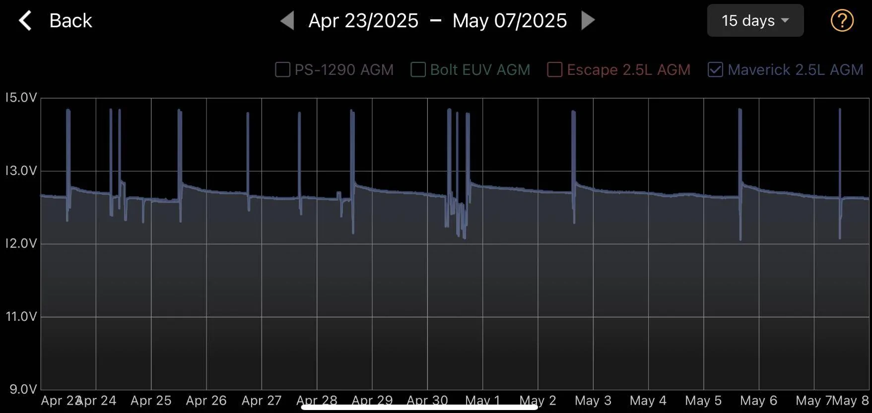

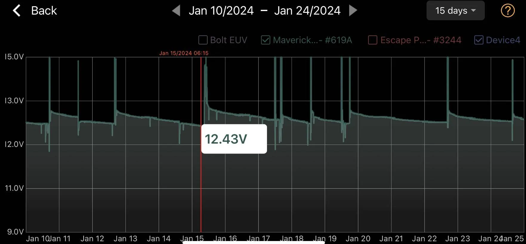

On my 2023 I'd see the 15 volts more in the cooler months than warmer.
This is an AGM I installed about a month after getting the truck.
The monitor is at the jump post, so it's closer to the DC/DC than the 12V Battery.
Ford Maverick Specific 2025 Hybrid Questions 1751661339301-8o
Ford Maverick Specific 2025 Hybrid Questions 1751661414994-qx
Couple of days ago comparing OBDLink app and Forscan Lite app with my OBDLink MX+.
Ford Maverick Specific 2025 Hybrid Questions 1751661639675-9o

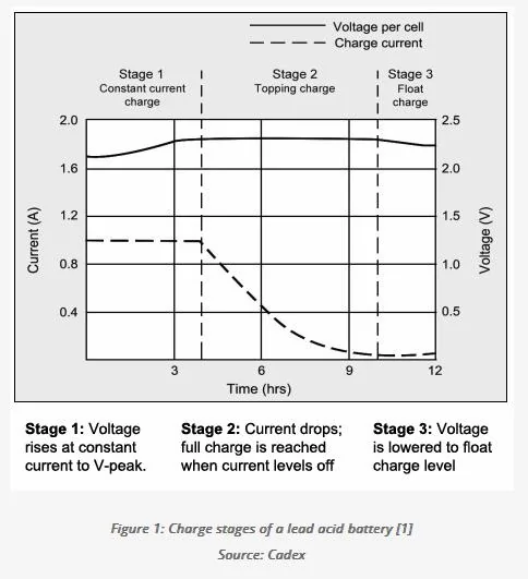

Ya, this:
https://batteryuniversity.com/article/bu-403-charging-lead-acid
Only Ford engineers read hours as minutes in the graph. No really, that's about how long the higher amps are used.
