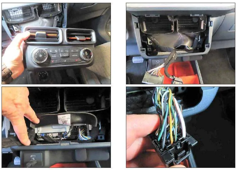

2022-2024, the wiring harness was actually below, under the hvac control panels. I'm not 100% on the 2025 yet, since they changed the screen and hvac controls.
This T harness should make your life easier for wiring

Thanks Aaron. I'll be getting all of the equipment from Crutchfield. They are the best! I've been using them for many years. And thanks for the pictures! They recommended the T harness also. I have everything in my cart. They don't yet have the master sheet for the 2025. I'll wait a few more weeks and if they still don't have it I'll have them send me the 2024 master and hope for the best. Thanks again!
