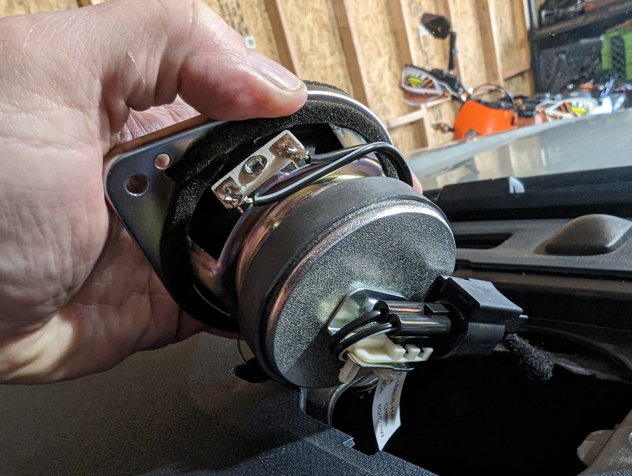

I thought the B/O center was a plug n play swap to the infinity- But the OEM has a soldered connection and a Molex lead and now it appears it needs an additional resistor added ? Hmm

Literally every speaker in the Maverick has some kind of connector that literally no aftermarket replacement will have.
So if you aren't holding an adapter that someone has already confirmed to be the correct fitment for that particular speaker, you should always expect to either cut the factory plug off ,or if it's feasible, you might be able to remove the adapter off the factory speaker to re-use it.
I nearly always cut the factory plug off the speaker wire.
Regarding the resistor that's discussed above as well as other threads. Others say it does work at 4 ohm. Personally I'm going to add a resistor to take it at least to 8 ohm because I don't want the center even more prominent or to clip at high volume. It's not uncommon for me to play my system at 25-30 volume, but if you play it under 20, clipping probably isn't a concern.
