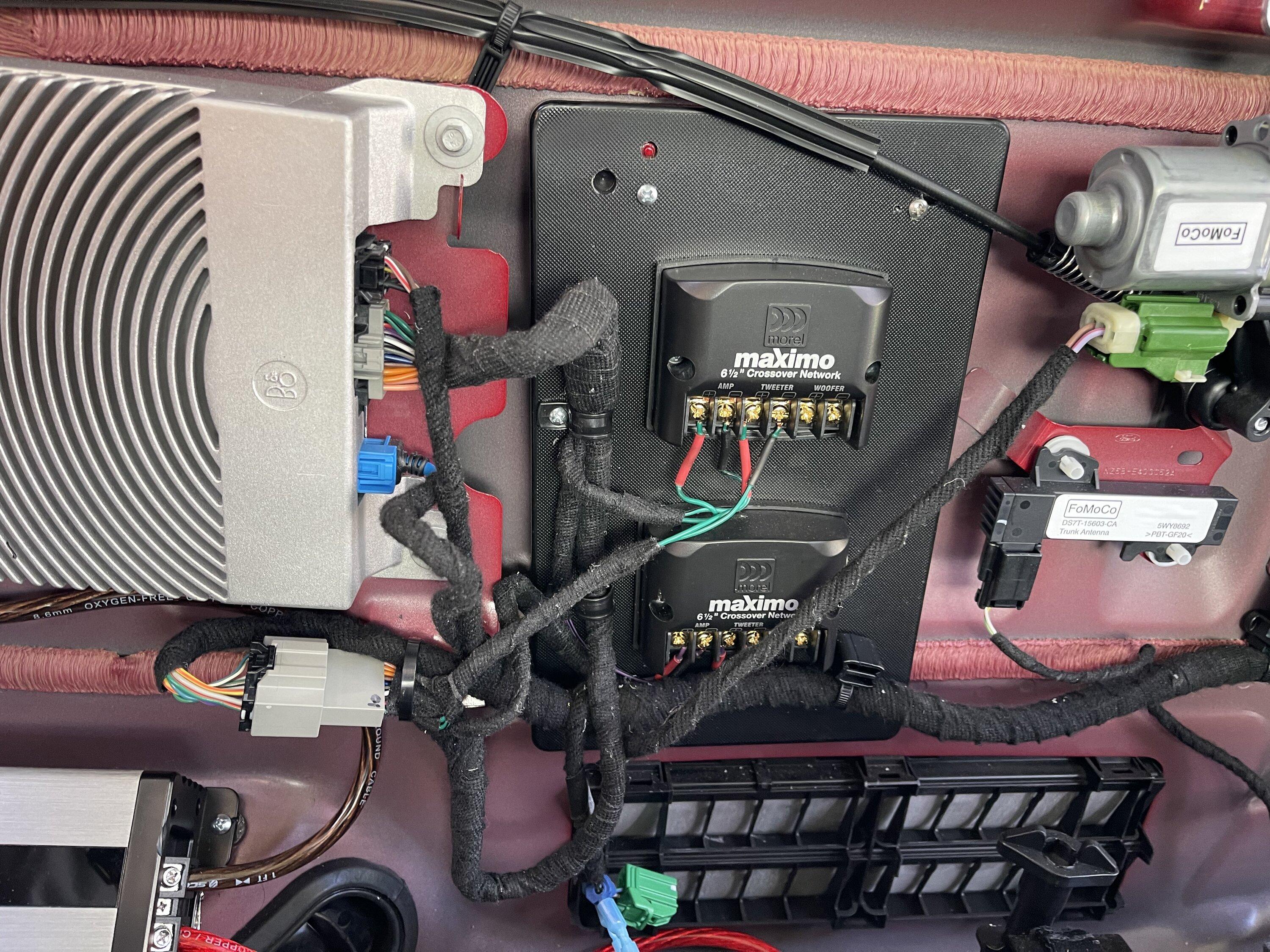

I have upgraded my B&O system front speakers to the Morel components. So far just the door speakers and doing the tweeters next. I have wondered myself if a resistor on the center channel speaker would pull it down some? Seems like the assignment of frequency and volume would be in the head unit as it is the one powering the center and rear speakers. Is it possible these settings could be in forscan? I’m hoping my Morel tweeters will be more efficient than the B&O tweeters and help the imbalance situation. I actually like the surround setting despite the center emphasis because I like live music and it makes it sound more ā€œliveā€. Just a preference. I’m also using the Alpine sub setup that colinl uses with great results. I purchased adapters that are supposed to be specifically for the Maverick dash speakers and hope they are the right ones. We’ll see.

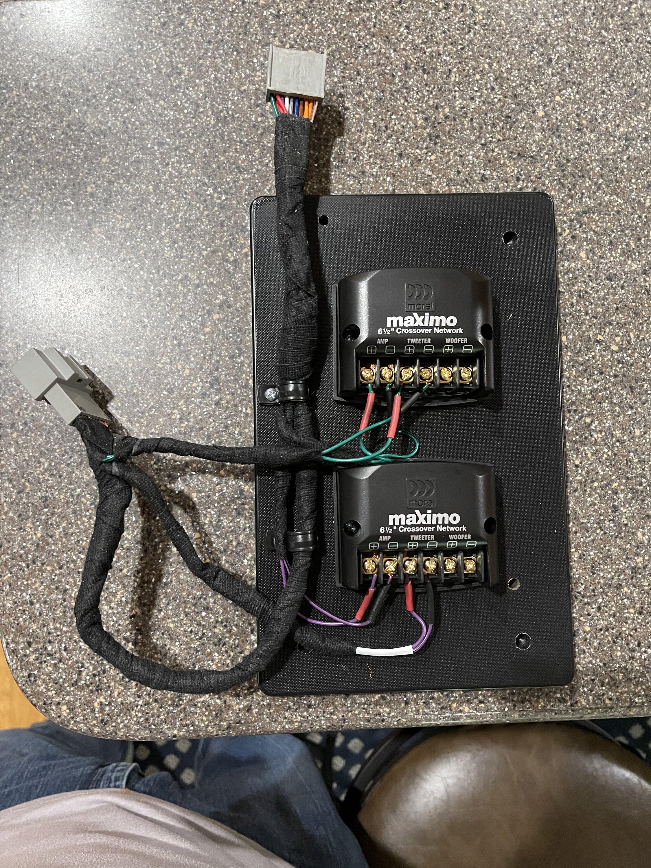

I ordered those 4 ohm resistors thanks. I’m going to wait to see how efficient the Morel tweeters are and then decide whether to add the resistor to calm the center down some. I prefer the resistor to an L pad as most every L pad I’ve experienced through time gets dirty and noisy. I had to remote the Morel crossovers to be behind the seat with the B&O amp because they would never fit in the dash Lol. I do think their quality would be better than just a bass blocker. I think it was you that said you used a cutting board for mounting an amp? I used it for mounting the crossovers and modified the PAC APH-FD02 bypass harness to allow me to intercept the tweeter feeds from the B&O amp without cutting into the factory harness. It works like a champ.
