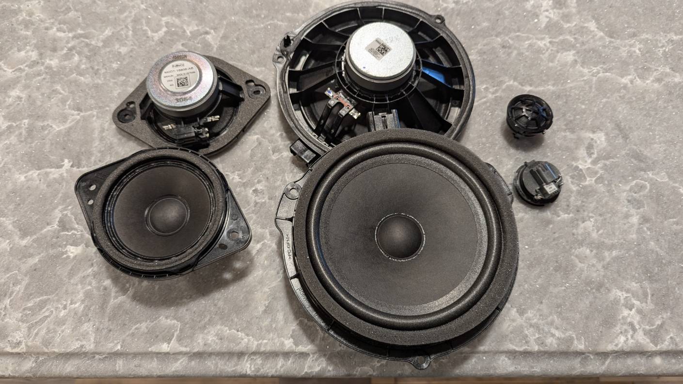

These are the OEM drivers. As you can see they are typical paper cones, The 4" rear pillars sounded particularly bad and with no coax tweeter you can see why. The drivers that are the most respectful are the dash tweeters, they appear to be silk dome tweeters.
