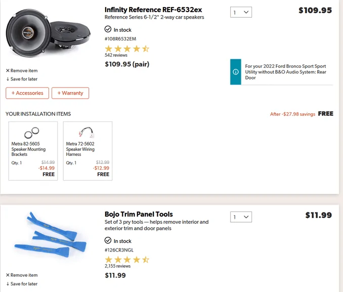

Crutchfield shows Metra 72-5602 speaker wiring harness, but I certainly no authority nor have any idea. Example screenshot below:

Those are for the 6.5/6.75 inch door speakers
the 72-5600/5601 are for the tweeters and c column (I’d go with the 5600 for both and just make sure the black (ground) and white (+) line up accordingly with the speaker leads and the same color to lead (gray/purple is the negative)
