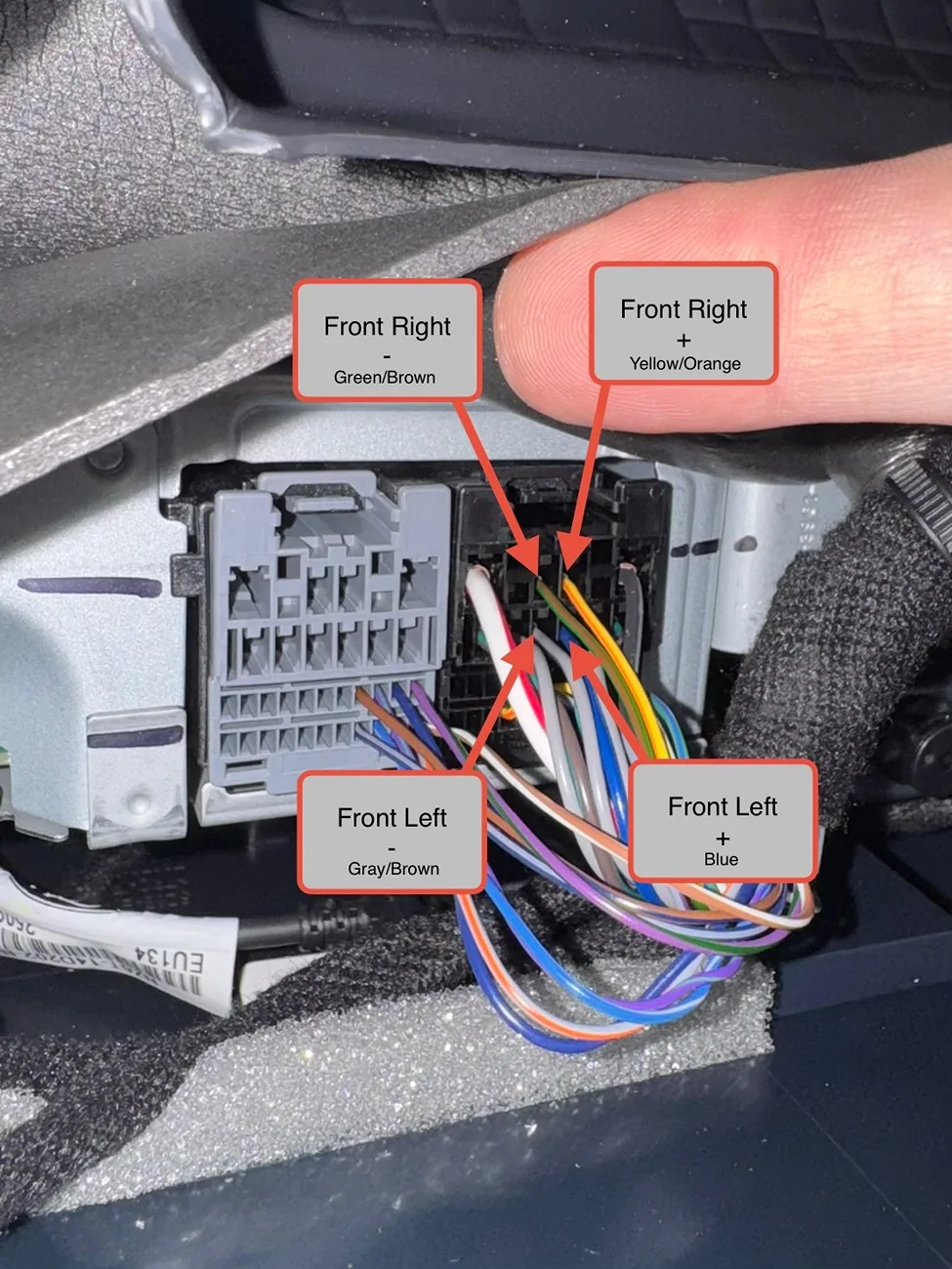

I've seen a couple people online try to use the same colors stated for older models to tap into without an audio signal. Has anyone tapped into their front speaker wires for an audio signal to their sub in the 2025 model?

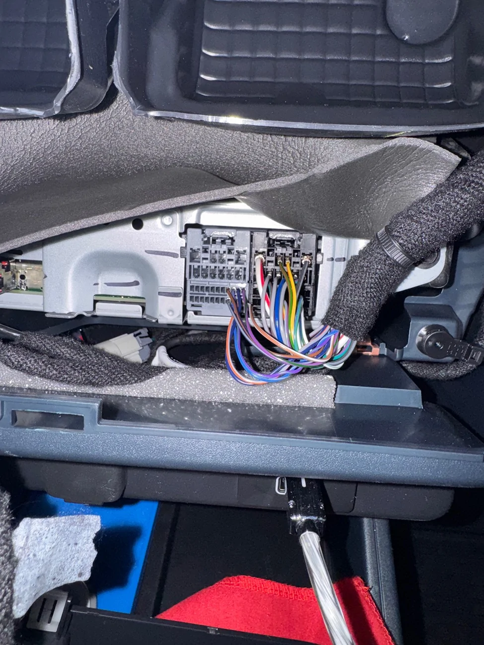

I tapped the front speaker Left/Right wires up at the ACM. Took this photo at the time:
Ford Maverick Speaker wire colors to tap into for the 2025? IMG_0363
Ford Maverick Speaker wire colors to tap into for the 2025? IMG_0362
