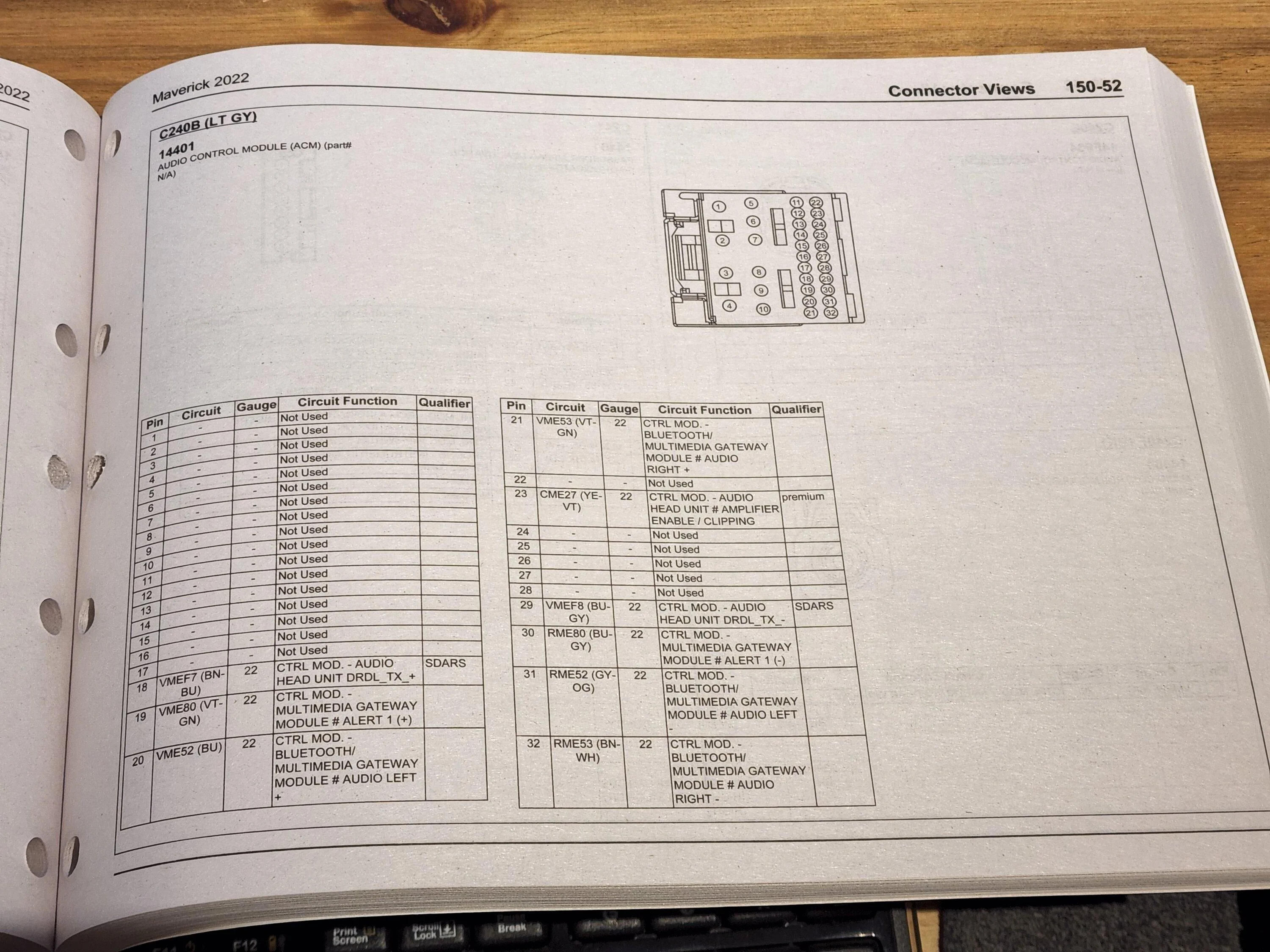

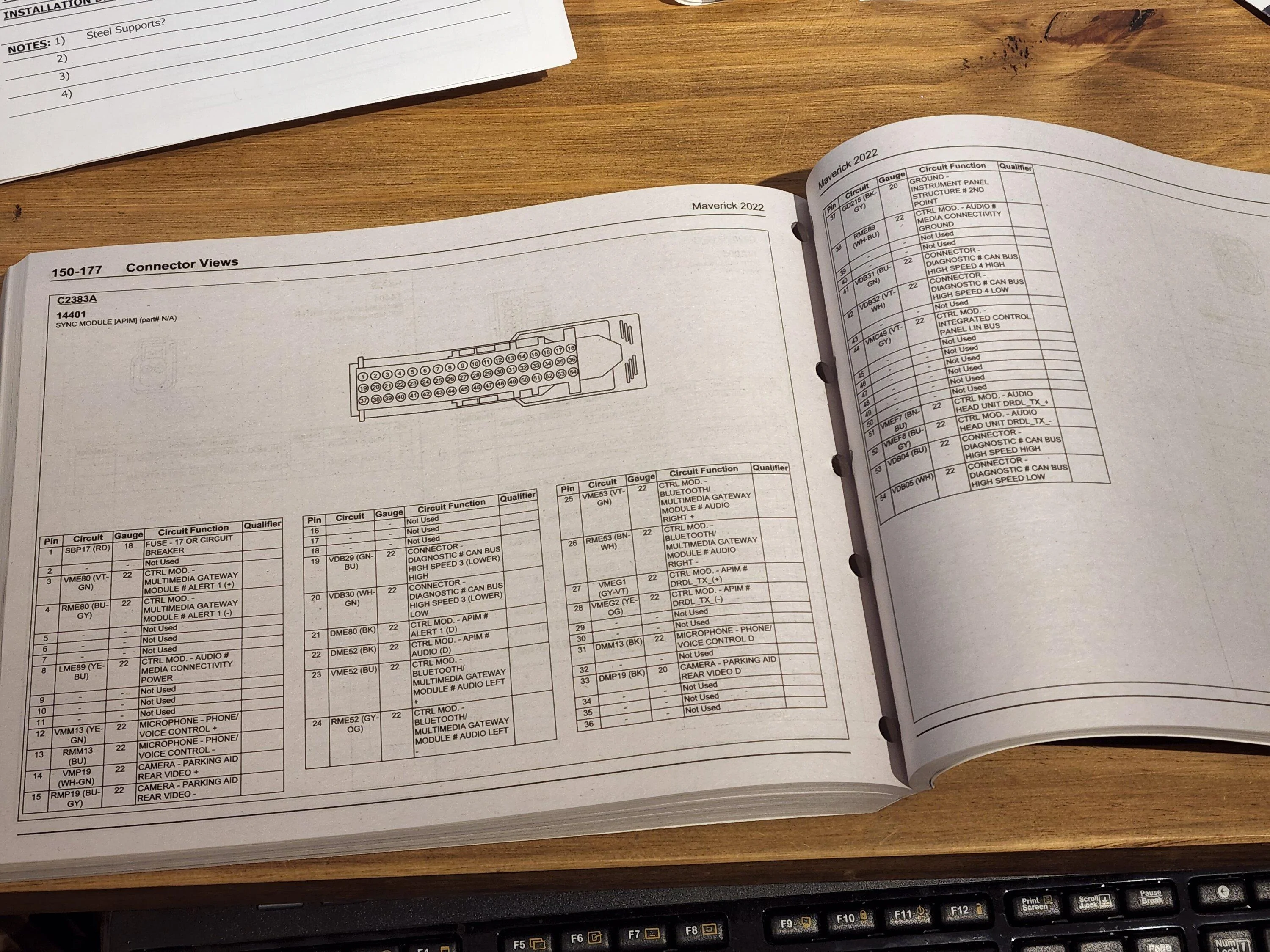

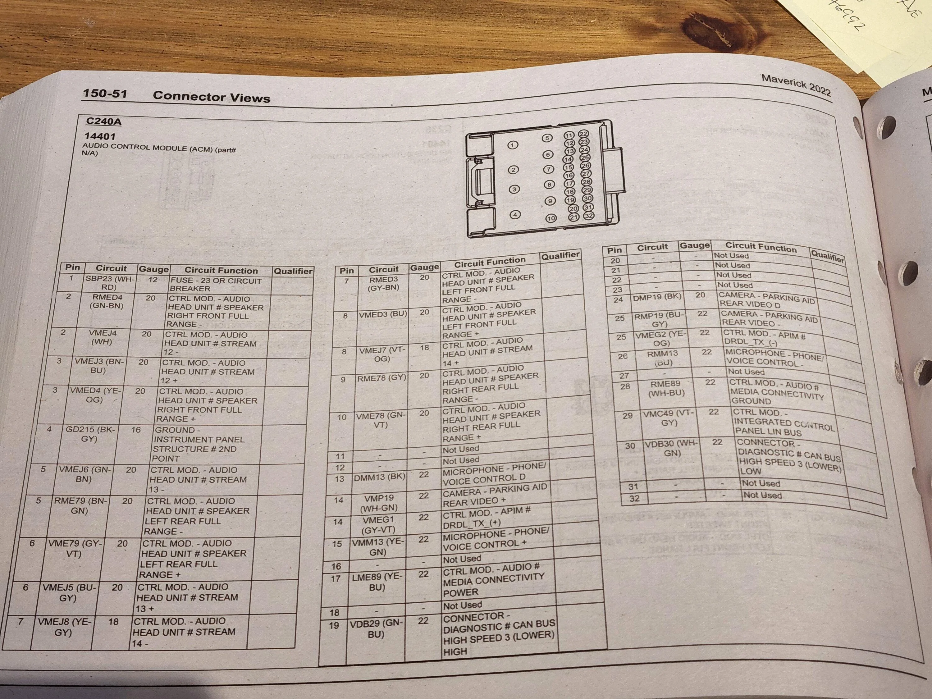

I finally got the wiring diagrams
Ford Maverick What is the correct wire to splice into for remote in audio harness? 20220818_173825
Ford Maverick What is the correct wire to splice into for remote in audio harness? 20220818_173858

Hey all. this weekend i put a 12" fosgate shallow sub in with boss 1100 amp. everything works alright. ( Stock speakers need to go at some point) anyway, i spliced the remote from the amp into the red and white hot wire on the radio harness. assuming it was Ignition hot, but its actually a battery hot and the amp stays on all the time when the truck is off. ive been searching around and trying to find out what people are using as a remote hot, but all ive found was that i need to get a factory service manual. been trying to down load the 72 hour liscense but my order gets locked up on the processing screen. anyway. hopefully someon here whose done the splicing method can help me out

I tapped into fuse #6 for a remote turn on for my sub amp and it works perfectly.
