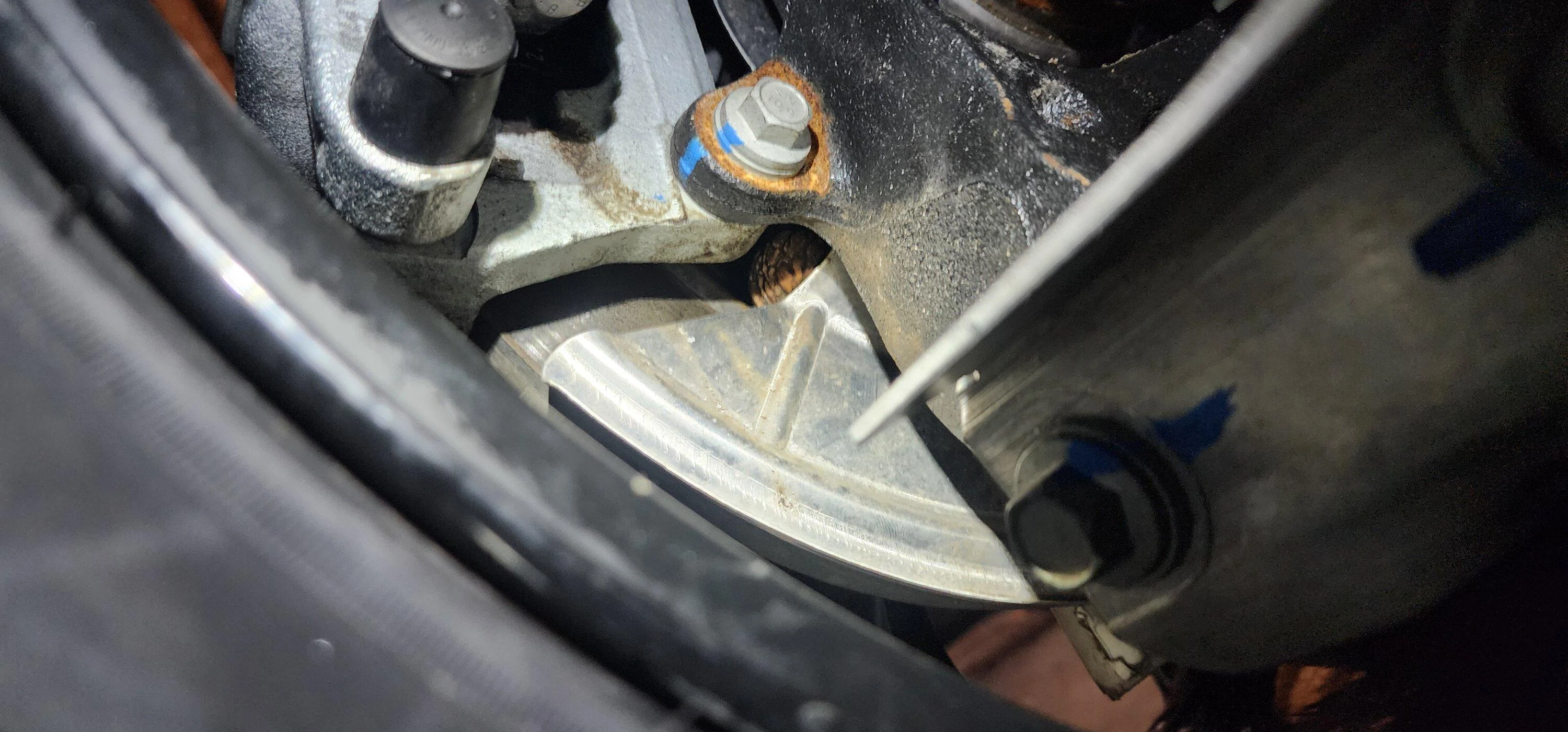

Noticed this sound about 2 weeks ago, seems to kick off when i hit bump or take a sharp turn, and continue until i park vehicle. Sounds like tin cans dragging behind me. Nothing dragging on ground or vissibly loose. I dont have a garage and its wet, snowy and zero degrees so i cant really deep dive into it.
I havent done any hard driving at all, mostly just commuting to work in town and maybe 3 short trips out of town.
Dealer cant look into it for 2 weeks yet, but i have an appt.
Wonder if anyone here has any ideas?

Definitely something stuck behind rotor dust shield. Can feel it but too big to come out. I will try sincerely when my wife gets home and share results.

At least u found it and it wasn’t anything major

Ot looks like a peach pit or a nut of some sort.i have no i
Ford Maverick Sounds like i just got married... 20240131_202144
dea how to remove it. I also have no idea how it would get where it is.

Jack it up and pull off the wheel then the caliper and see how u can get to it after.
