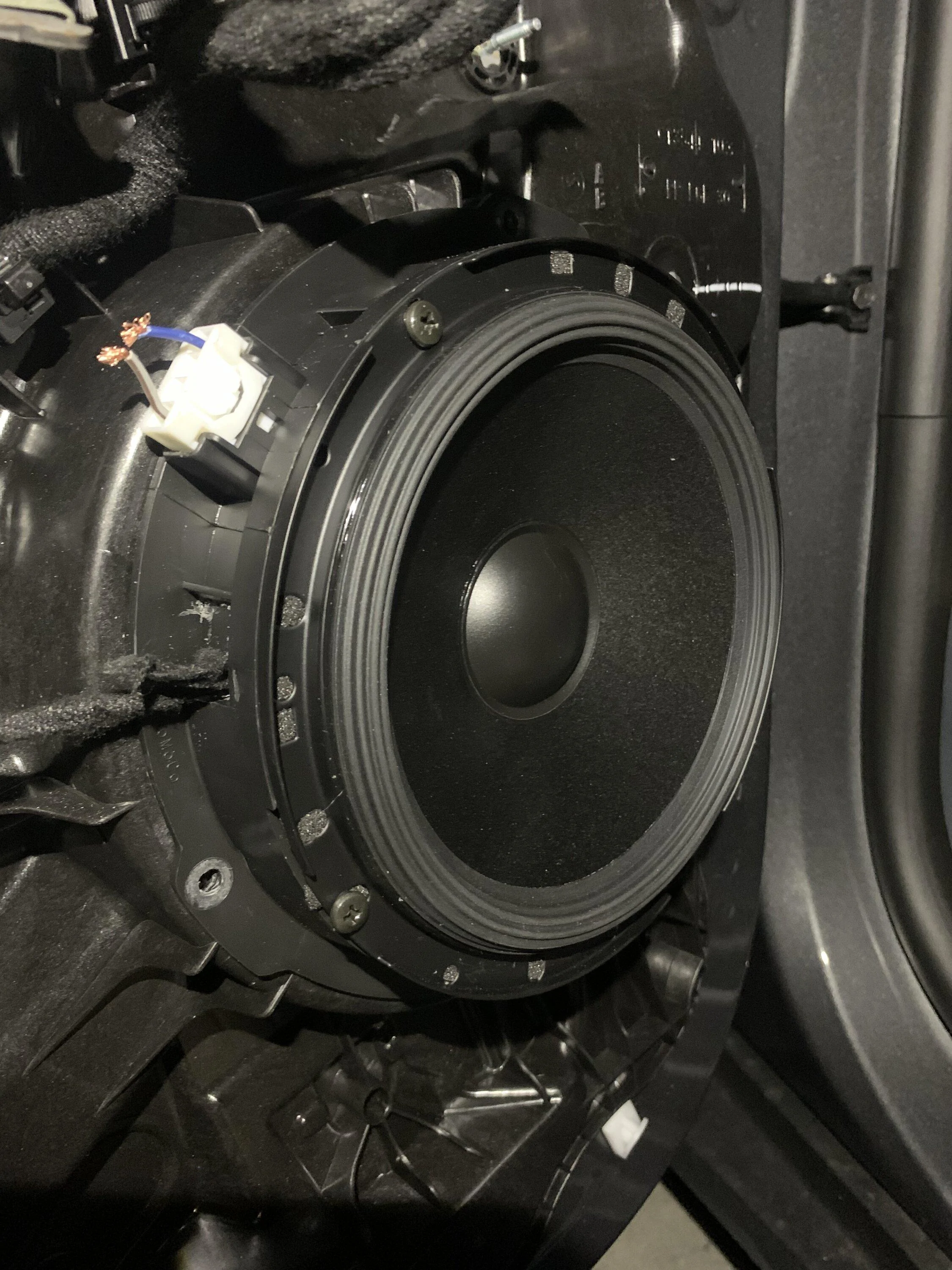

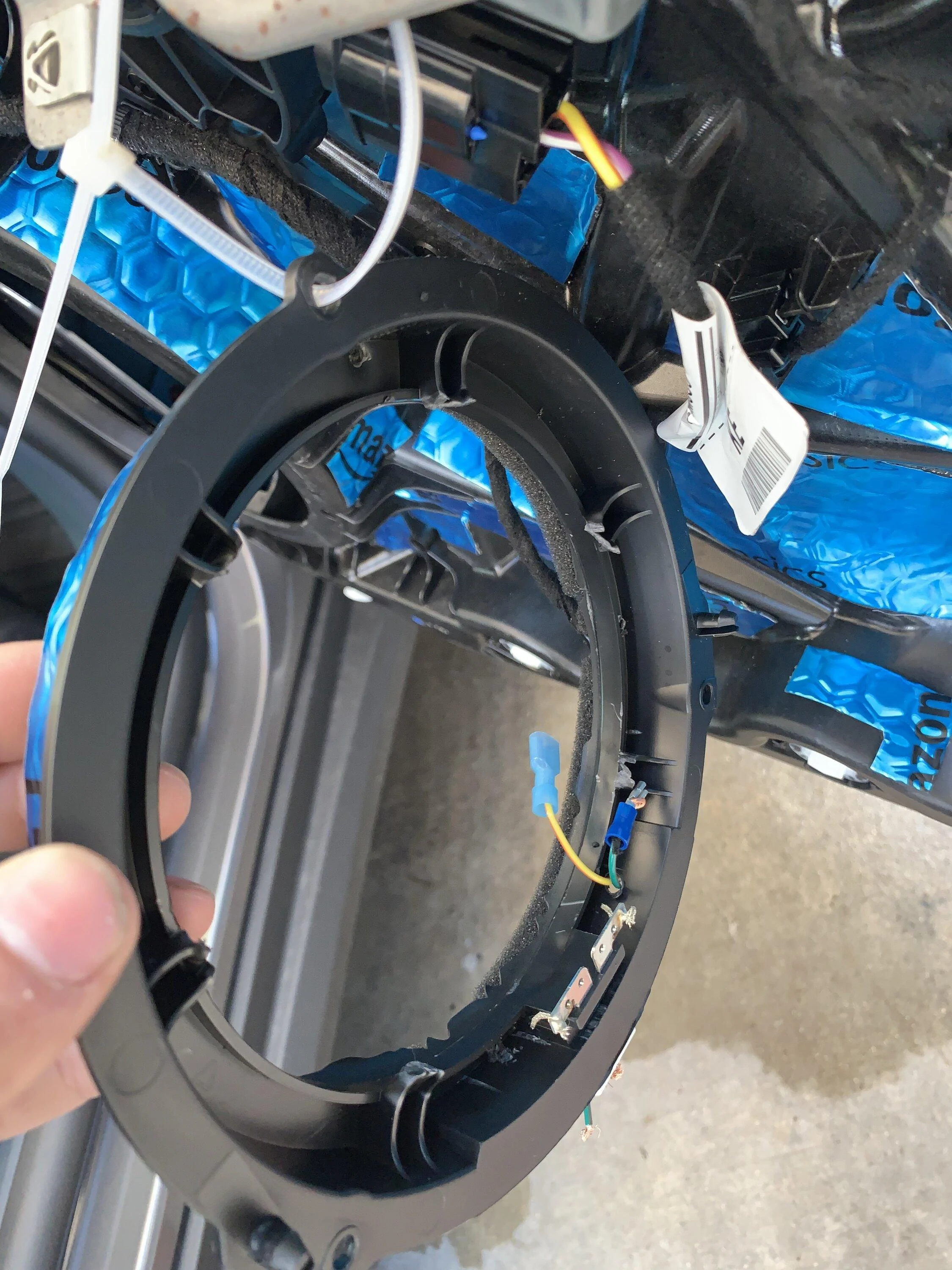

Oh, also assuming you got these, I'm a little curious why crutchfield lists them as not fitting and what your shop may have done to get them in. https://www.crutchfield.com/p_500SS65C/Alpine-S-S65C.html
Here is how they installed the speakers which crutchfield lists as not fitting the maverick. Looks like they cut up the stock speaker and used the old speaker as the mounting bracket for the new ones 😳. Not sure how I feel about that but I guess if it works it works. Clearance to the speaker grille is good, the rings on the door panel just barely clear the speaker
Pretty normal thing to do for a shop. The cut plug is ugly but of course isn't visible or going to cause any issue.
