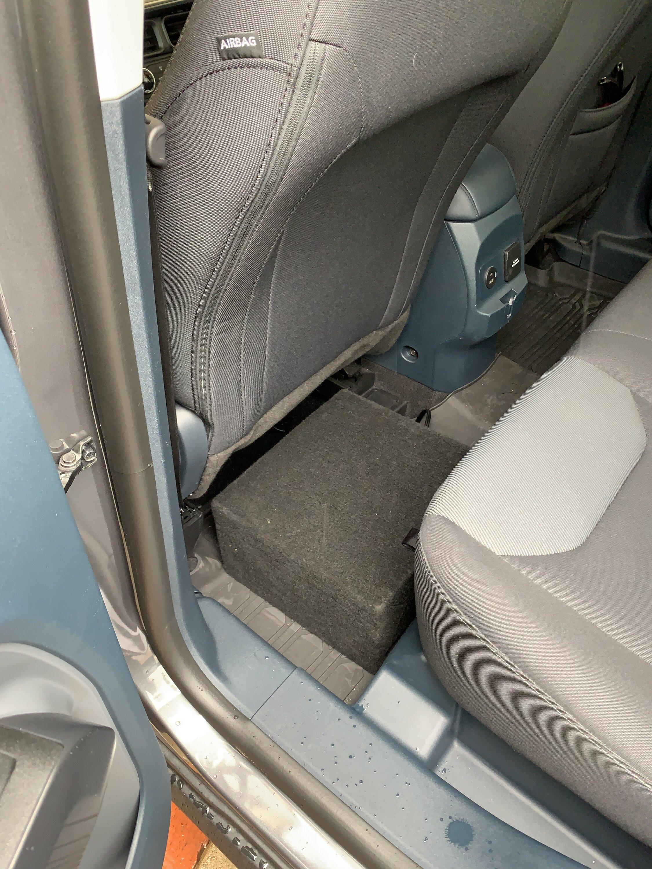

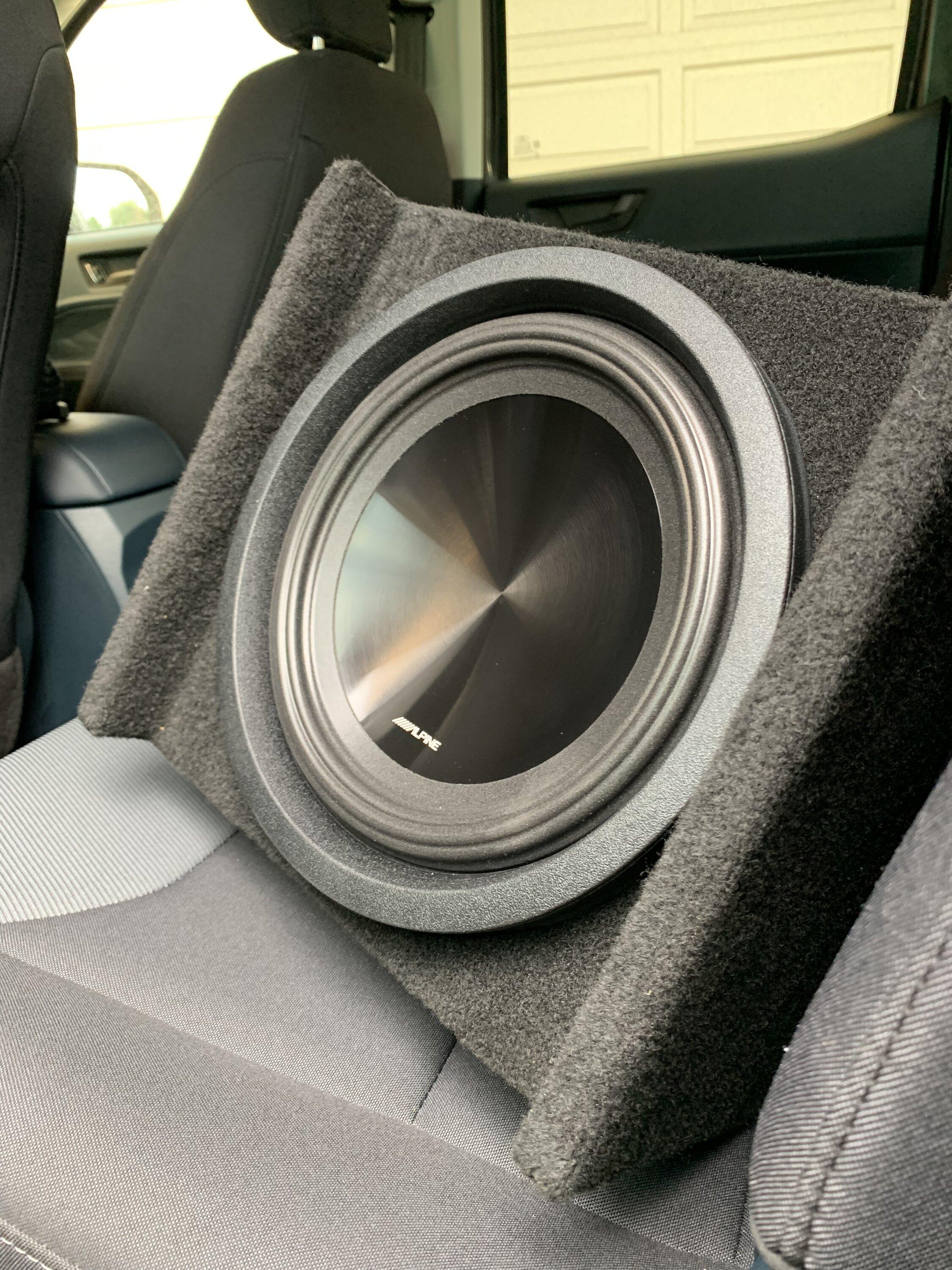

That's not bad for everything you listed. Any pics of the sub enclosure?
Oh, also assuming you got these, I'm a little curious why crutchfield lists them as not fitting and what your shop may have done to get them in. https://www.crutchfield.com/p_500SS65C/Alpine-S-S65C.html
Yep those are the ones I have. I noticed that on crutchfield too, not sure what they did. I’ll update here when I take the doors apart to add the deadening. I just went with a small downfiring box on the floor behind the front seat. Didn’t want to lose the tubs under the back seat.
