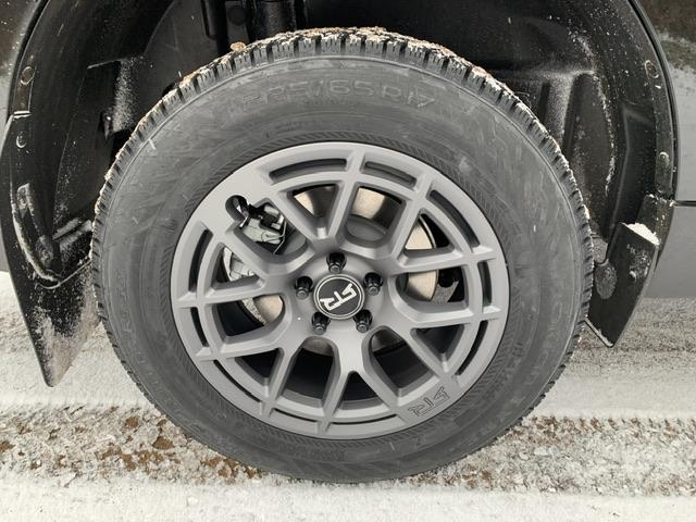

The same 225/65R17 is what’s stock on my XLT hybrid. I bought another set of alloy wheels and Nokian Hakkapeliitta R5 snow tires to go with them. Then I got new OEM TPMS sensors/valve stems off eBay (that auto-registered to the truck). These Nokians and Blizzaks are my favorites!

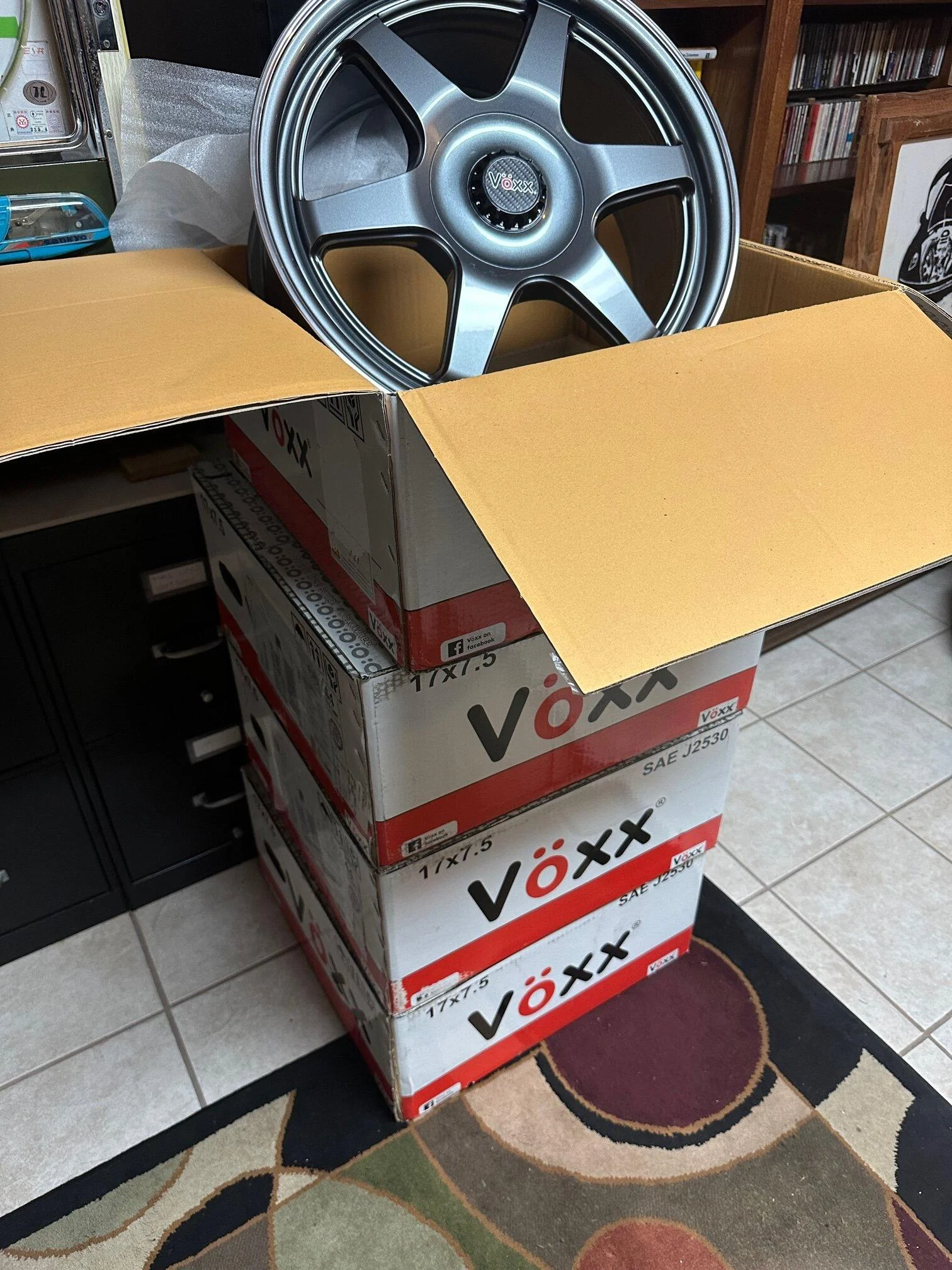

You are correct. The smaller diameter wheel with a taller tire will equate to the larger wheels you have and work better for snows. I bought some brand new 17x7.5 five spoke rims for winter but can't use them because I have larger brake calipers. For sale for $600 plus shipping if you are interested. In Iowa.
