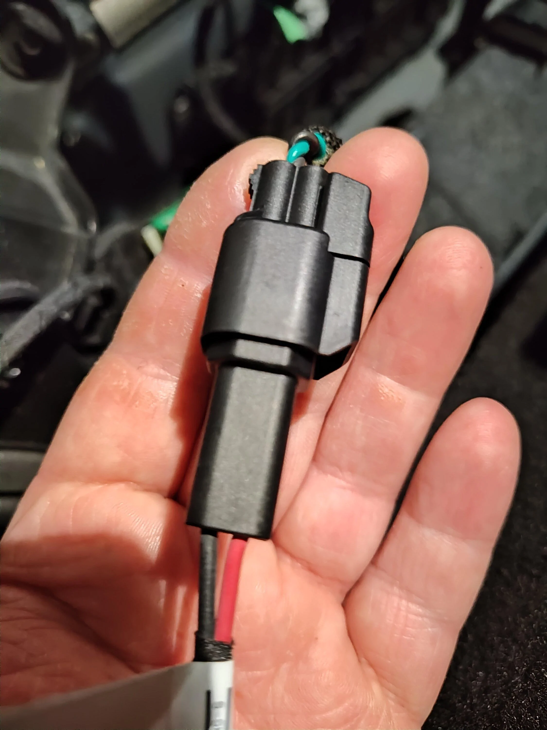

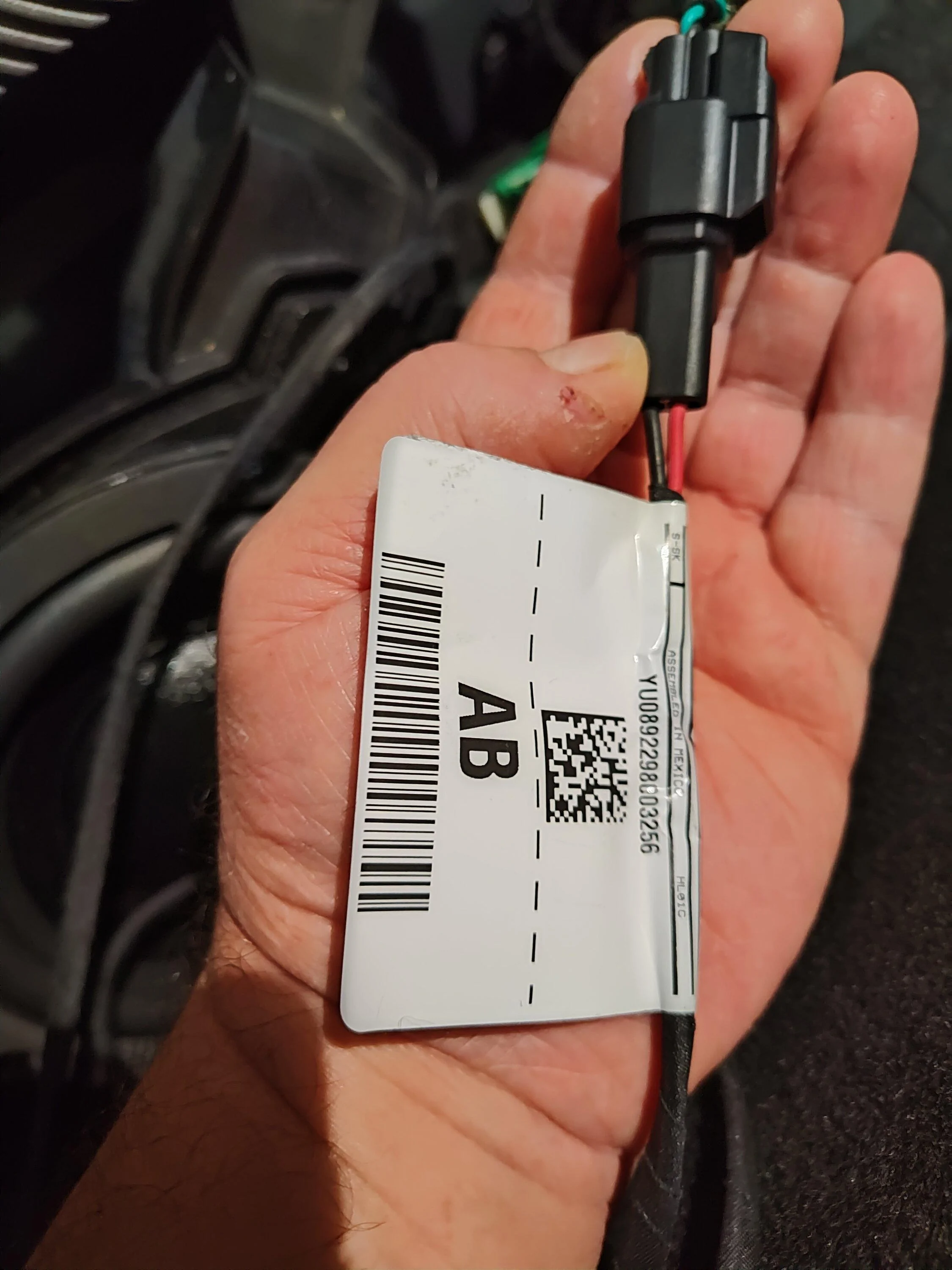

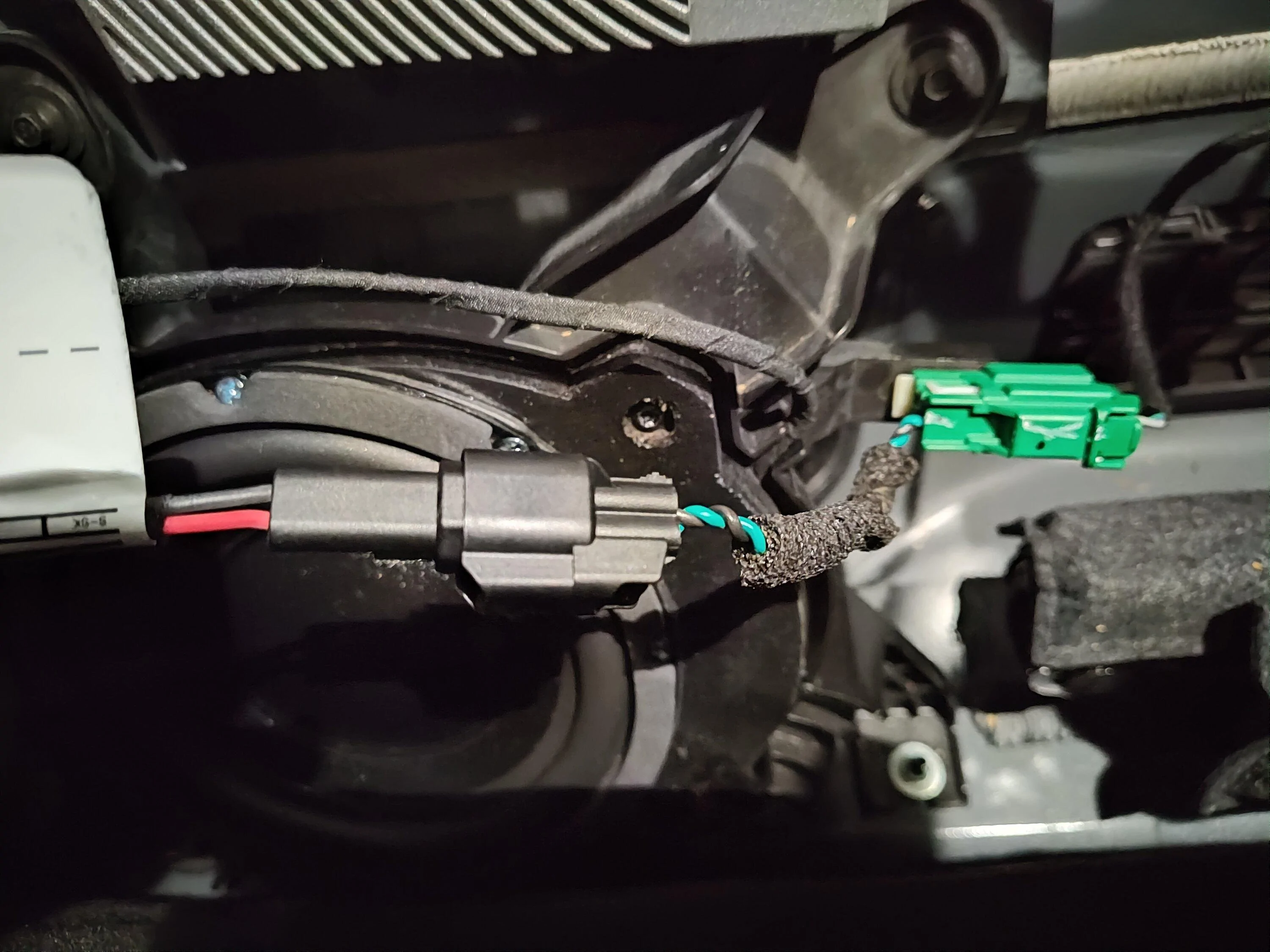

The Maverick comes with a wiring harness for bed customization that also works with the subwoofer plug for the amp. It plugs in inside the enclosure.
I want to see how you did this. I have an old 8 inch sub from my Focus that I would love to put in place of the B&O "sub". If I can do that for under $50 for an adaptor plate. I would call it a win lol. Can you provide photos of how you wire that harness into the amp??

There's not much space to work with, and I do not know if an 8" would fit or if the amp can handle an 8". But if it works I would love to know. Inside the sub a harness plugs directly into the speaker. That harness couples perfectly and is an exact match to the extra harness the Maverick came with for bed customization. The other end connects to the sub quick connectors. I'm not going to take my sub back apart to show that, but here's the other end
So if I'm understanding correctly, you have the red and black leads hooked to the sub? Thank you for the pictures showing it connected to the rest of the harness. I'll post back if I find a good adaptor to use and do the swap.

Yes... Black and red connect to the sub.
