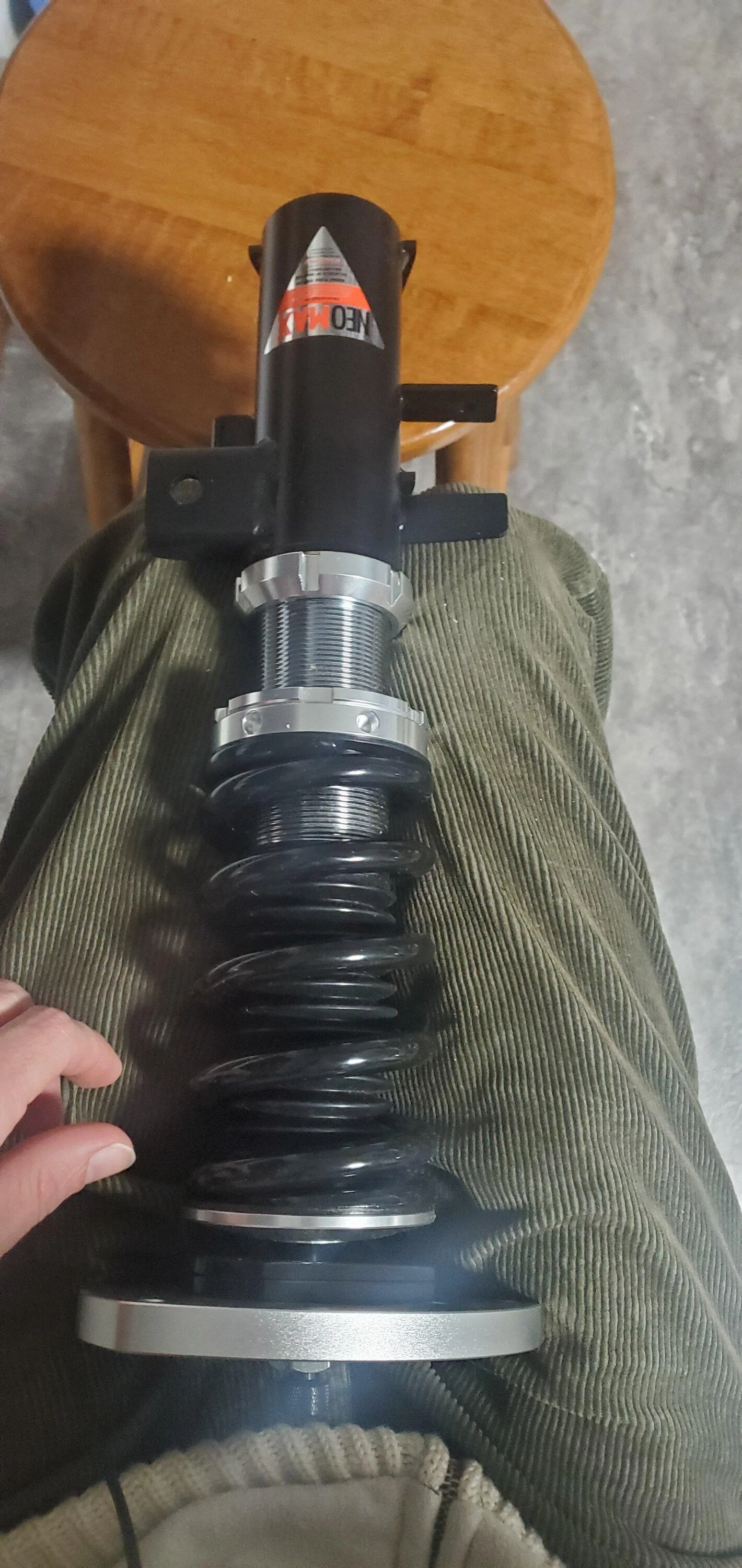

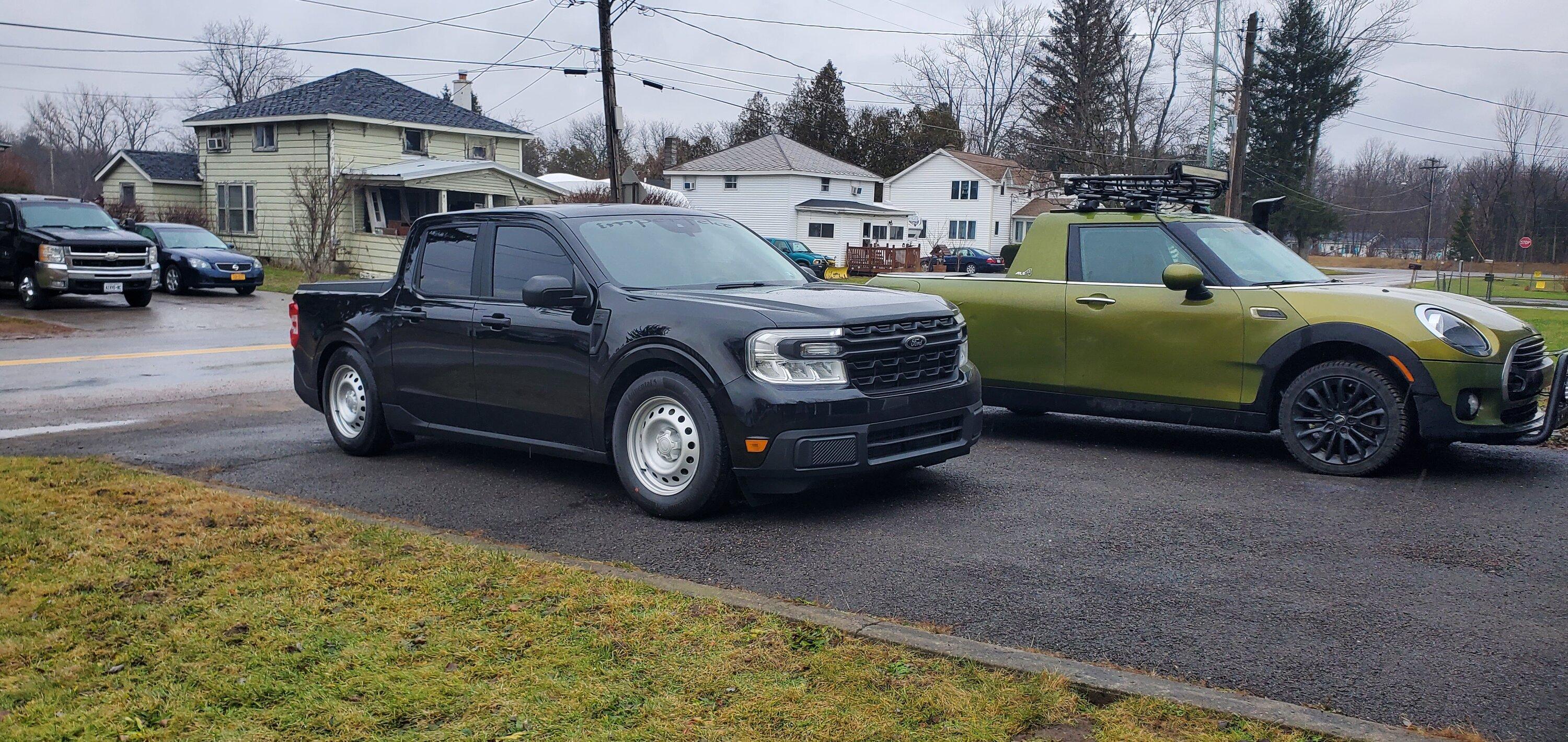

Here is the image I posted in my photo thread; the Silvers kit with the "superlow" option. The install was really easy; even if you have never tinkered with suspension before, they have a YouTube video to walk you through.

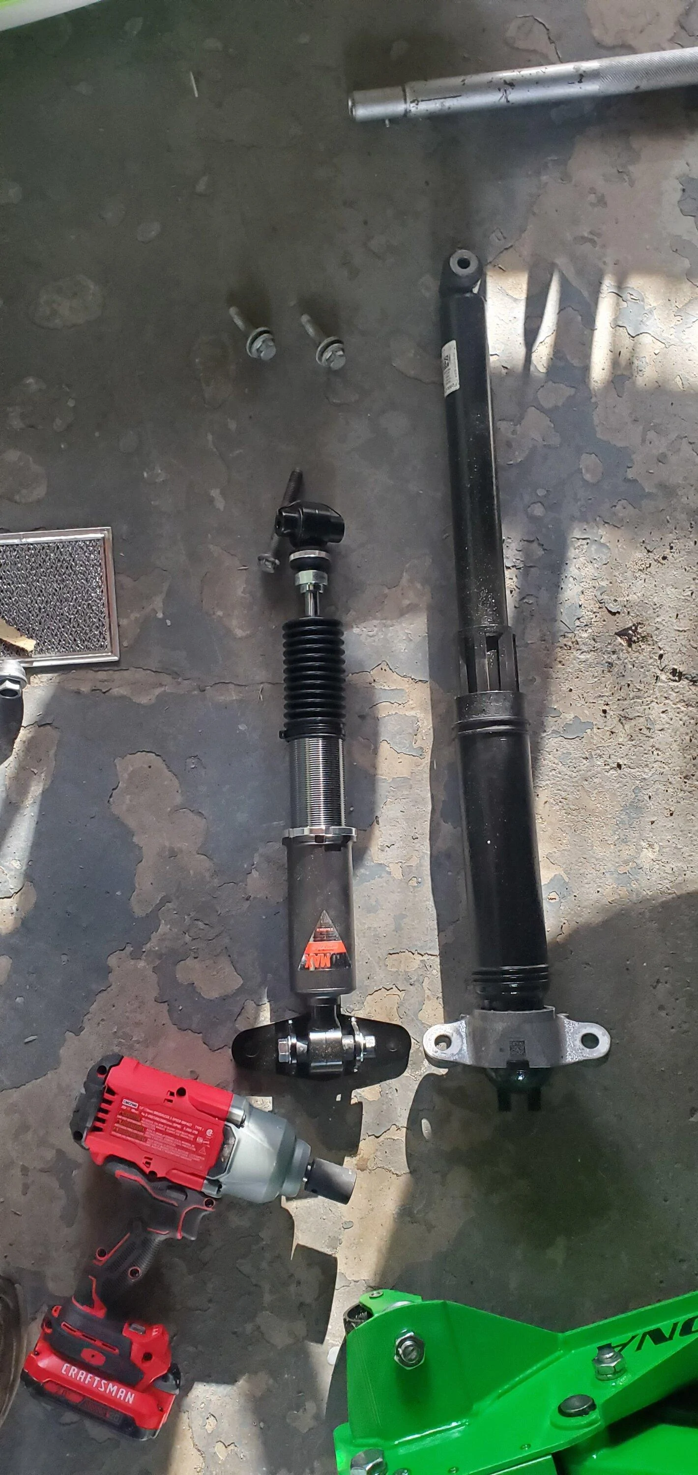

Being the "superlow" version of their kit, this was about as high as I could get the rear to sit without the springs being loose/wiggly. When I unboxed them, they looked TINY, I mean the fronts were as long as my thigh and well, here's the rear struts compared to the stock ones...
As far as the stiffness adjustability, I set everything to exactly "middle" and it's definitely a lowered vehicle stiffness without it being jolting but it's definitely not "new truck" feeling; I'm going to try and set everything to "soft" and see if there's any improvement.
This is currently the only picture I have of it since I did the lowering. The only other pic I have of it is at the dealership while I was buying it, lol. I'll get more soon, and update when I adjust the stiffness...

Okie, so I changed the stiffness on all four corners to medium-soft and drove to Dunkin' ... decided not to go full-on softie yet. Full-soft minus 6 clicks (because 12 is middle).
Slightly improved ride, still noticeably stiffer than stock though. Will try full soft next and report back.

Did you get a chance to try your suspension at full soft?
Yes, sorry. I find it more bearable at full soft; though I suppose with "superlow" coilovers, what kind of comfort can one really expect? :)

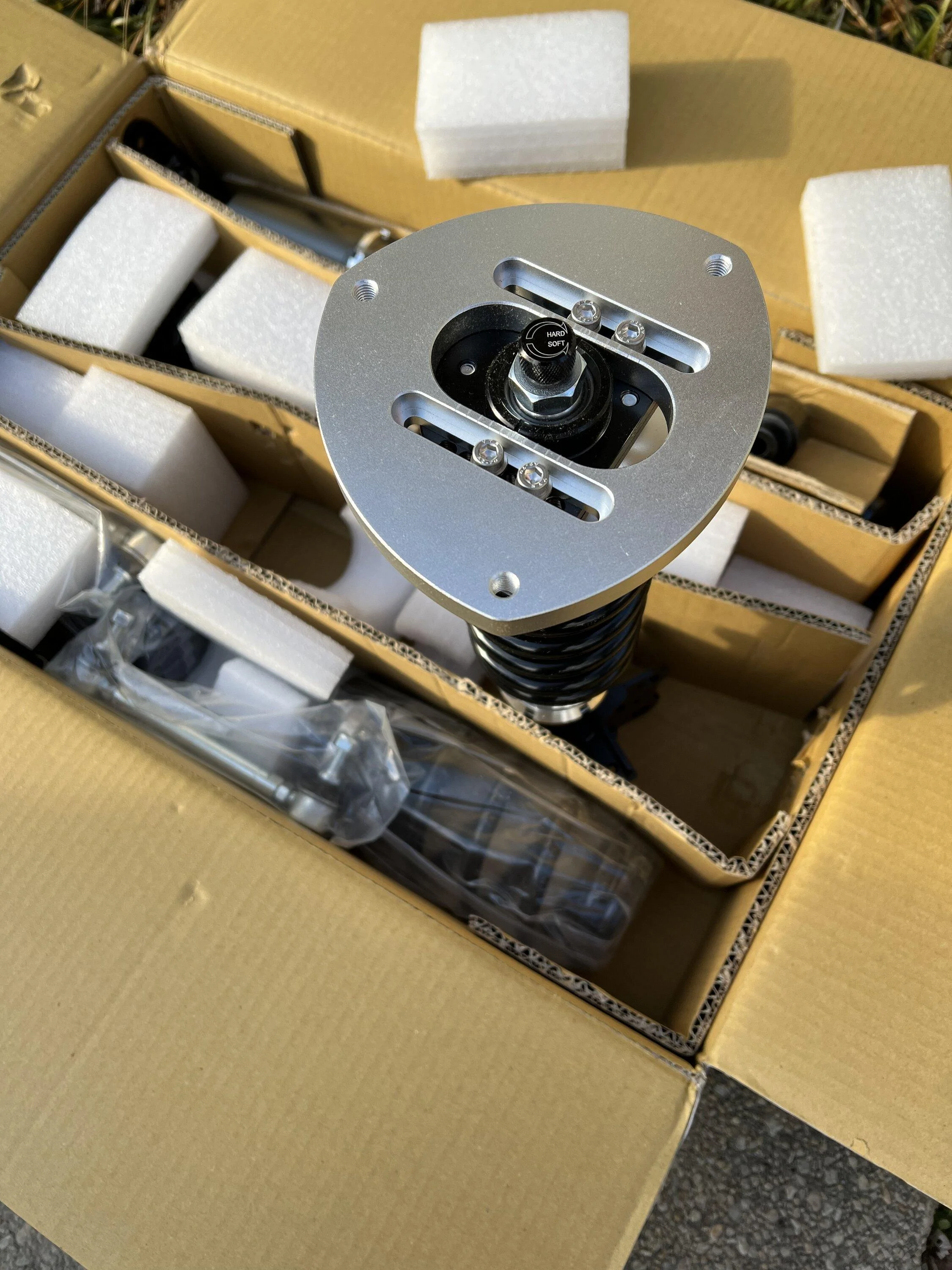

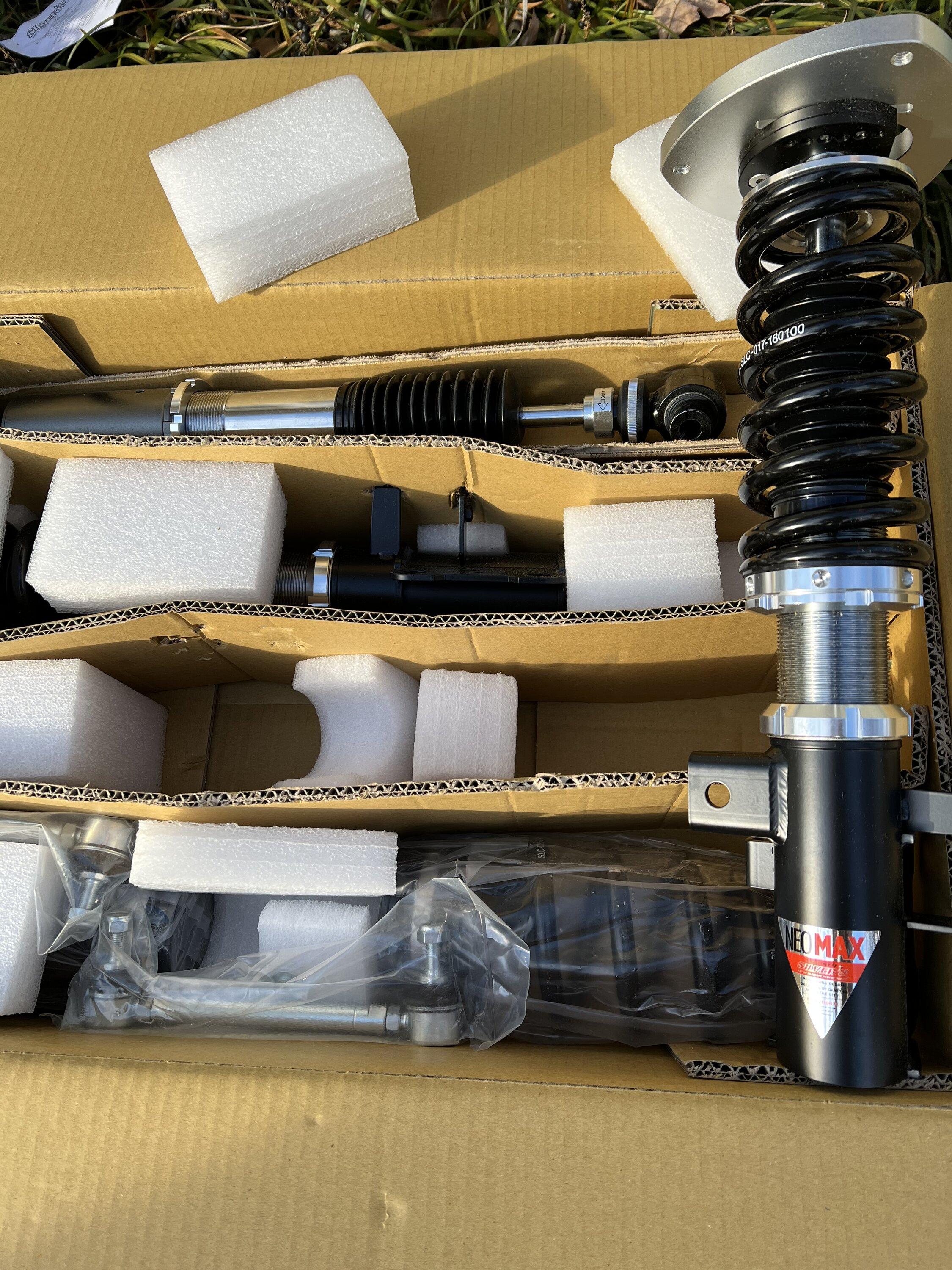

Received mine today

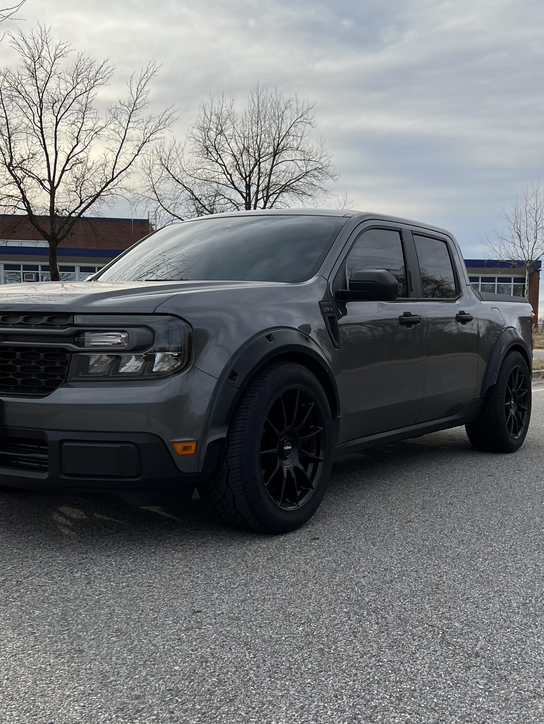

Silvers are on, still have to dial them in

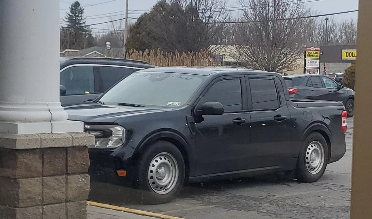

Ummm, is no one going to mention the Mini Truck? Do you have any more photos of that awesome looking machine? I love it.
