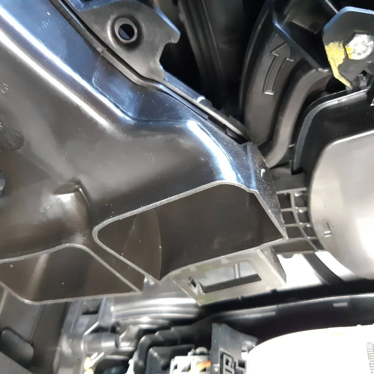

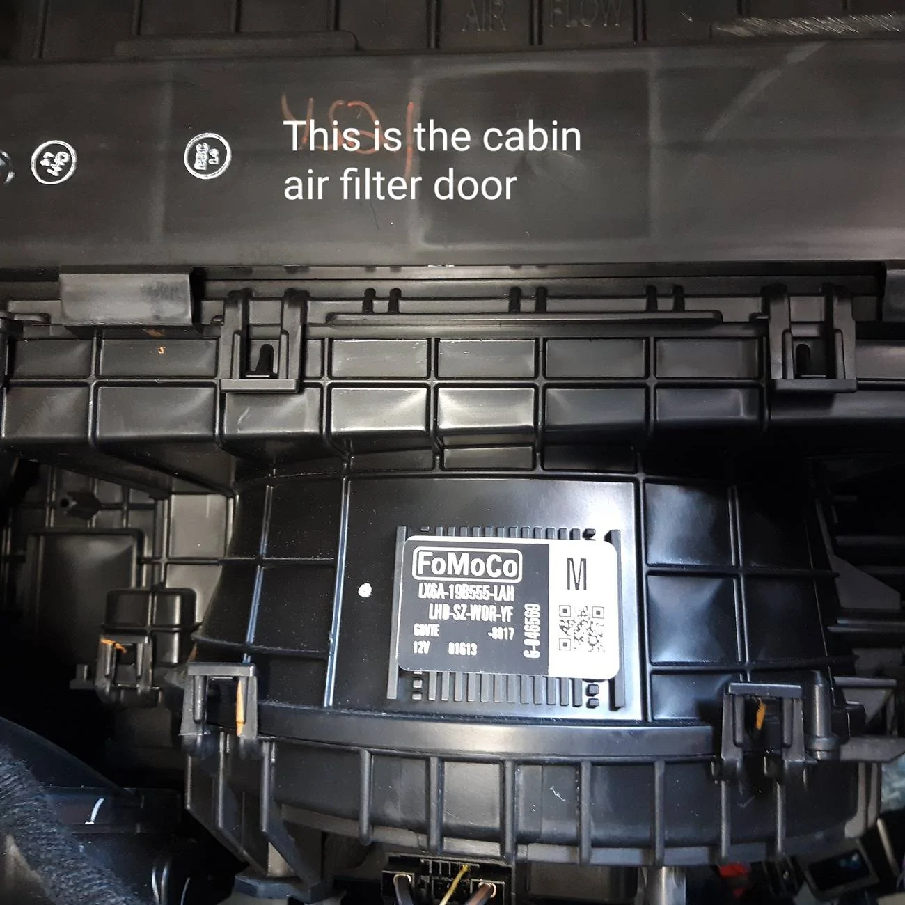

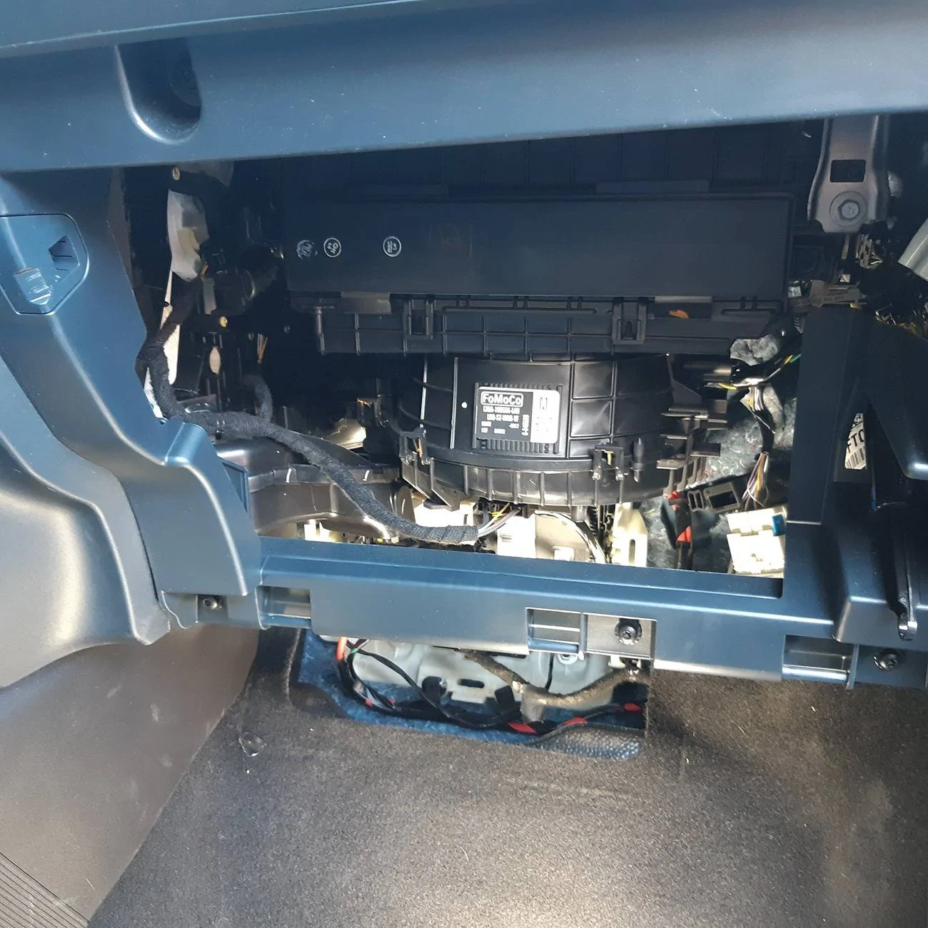

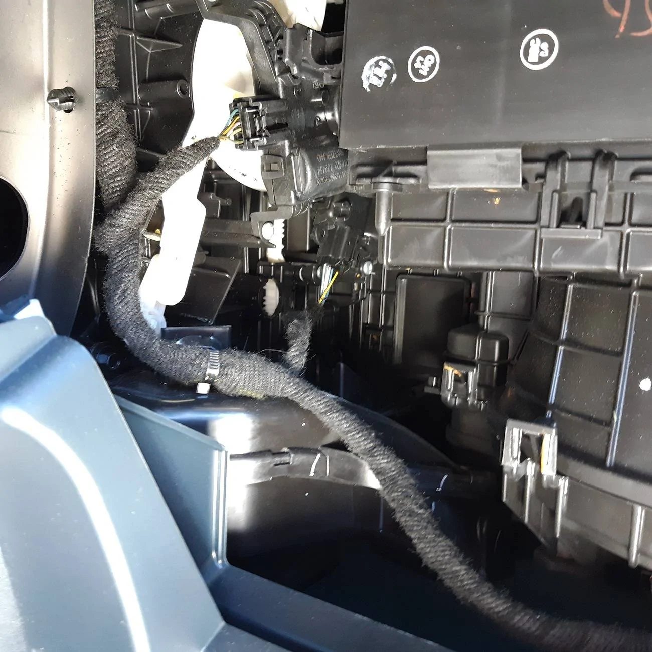

I know you aren't the OP in the situation. You mentioned the blower.
I thought I would post a few pictures of what's underneath the dash. Showing what you can get to by releasing the glove compartment drawer.
Here's a few pictures under the dash without the glove compartment in. I think that's the fan motor right below where the filter is.
I realize the heater core is probably buried.
Maybe they'll help someone.
Yup that’s just my exact thought, thanks.
Also there’s a thread of how to take apart the center
Thank You
I don't need to take apart anything more. I took the pictures when I had it apart changing the cabin air filter. I only get myself in more trouble when I take stuff apart and attempt to put it back together.
