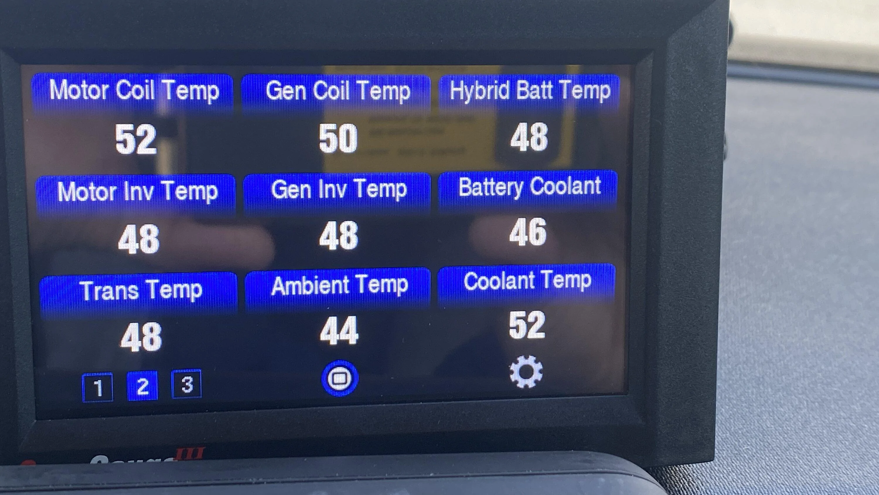

HV Battery Coolant Temperature always reads 20°F higher than actual on a ScanGaugeIII with the current firmware. I will inquire with the company about a possible firmware upgrade to correct for this.
12/1/2023 UPDATE:
Fixed with Firmware v. 1.231 and above.
Examples:
Overnight cold soak at 47°F
Engine coolant = 47
Transmission = 47
Motor Coil = 47
HV Battery Coolant = 67
Overnight cold soak at 64°F
Engine coolant = 64
Transmission = 64
Motor Coil = 64
HV Battery Coolant = 84
Warm Soak in hot parking lot at 95°F
Engine coolant = 95
Transmission = 95
Motor Coil = 95
HV Battery Coolant = 115
Consistent results over many months.
There is a software error or a sensor error. But at least one other owner has seen the same anomaly, so I'm leaning towards software error.

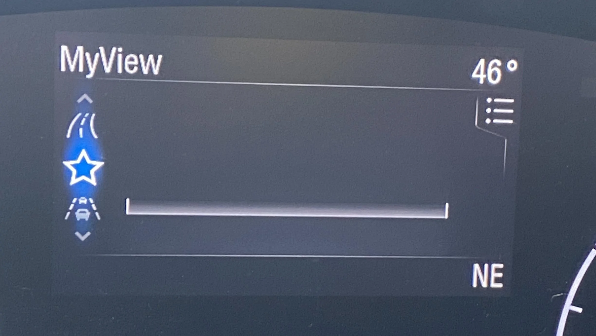

Update:
The manufacturer has updated the firmware and the battery coolant display is now within reasonable tolerances.
Today with v1.231
Before "starting" the engine:
Ford Maverick Scanner Data Depository for HYBRIDS IMG_8937
Ford Maverick Scanner Data Depository for HYBRIDS IMG_8938
