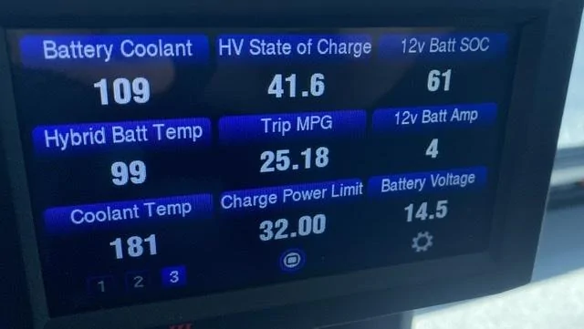

I DO NOT think the HV battery coolant circulates continuously. I think it only circulates when it deems necessary.
On multiple hot days, I've seen something like this: 90 degree day, but truck parked in a hot parking lot in full sun. The "coolant" was warmed to 109 (or more precisely the sensor location was heated to 109) from the hot parking lot.
After a 10 minute / 3 mile drive this value did not change, the coolant temperature did not go down and the battery temperature did not go up.
I had the A/C blasting for those 10 minutes.
Ford Maverick Hybrid Battery Cooling Data F496C080-56A7-4C94-A221-49EBB736E058

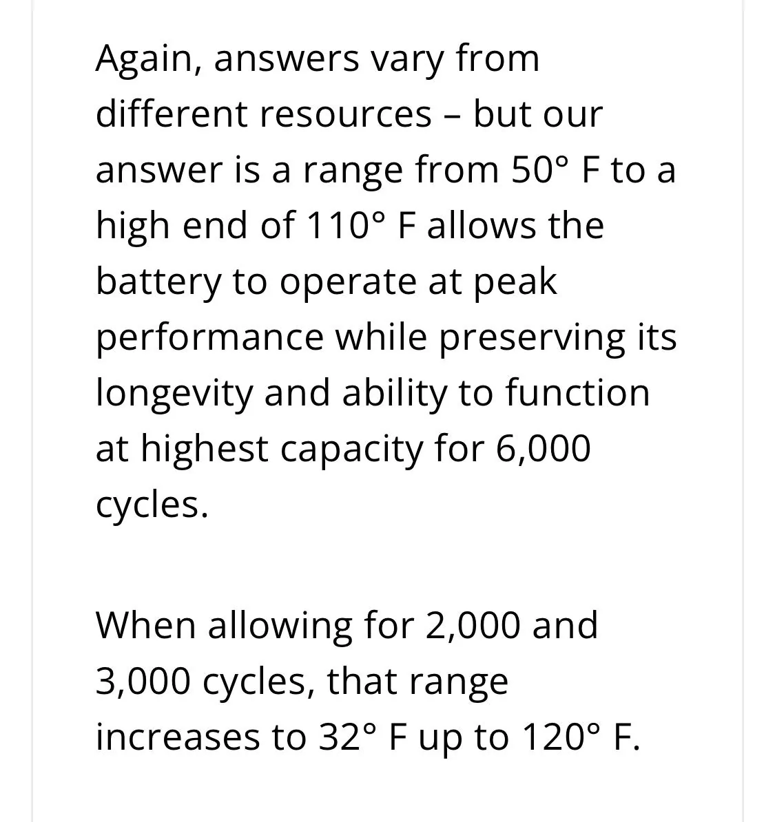

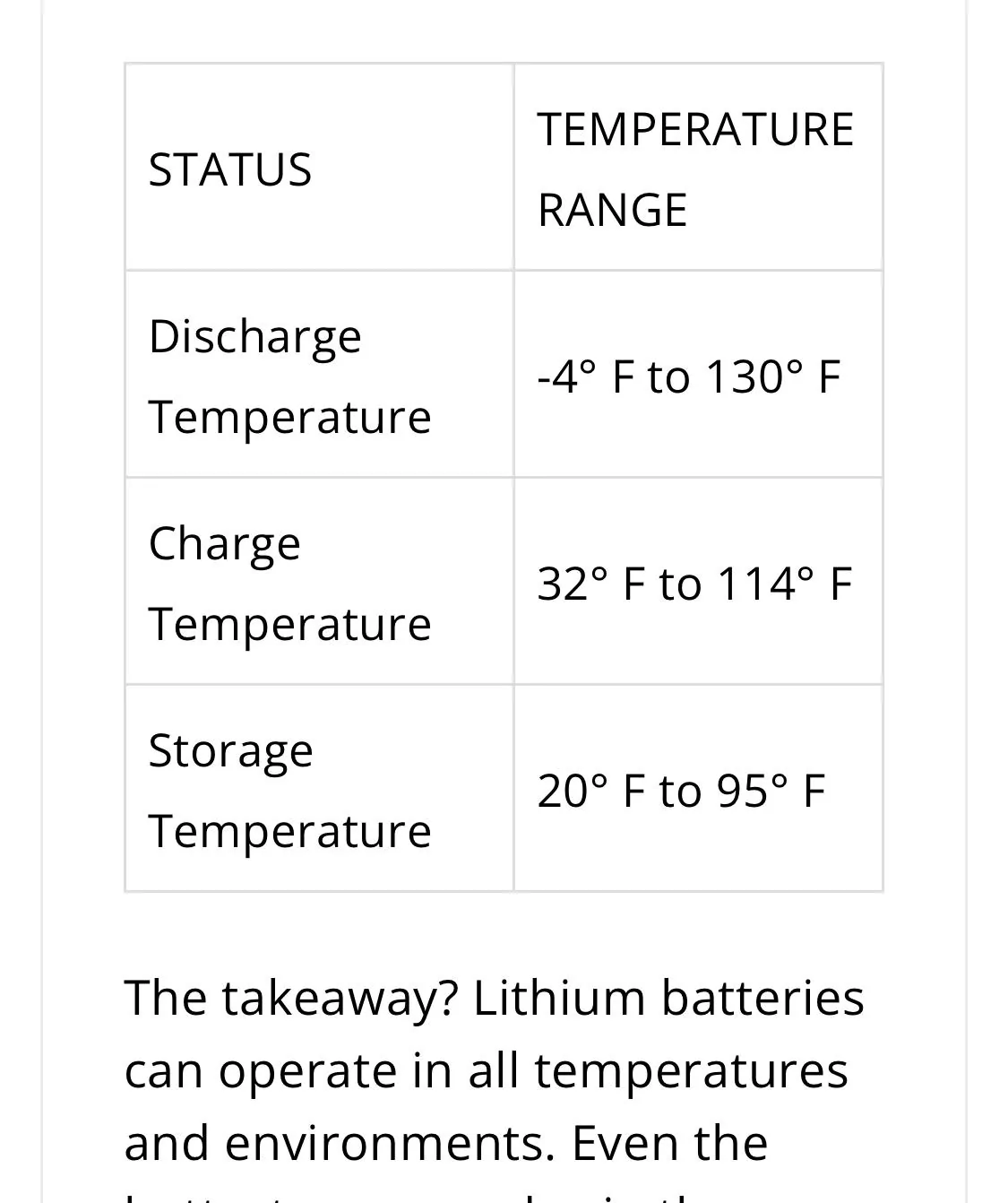

While the above data seems a little on the warm side, a battery company not affiliated with Ford has this to say:
Ford Maverick Hybrid Battery Cooling Data 2DB9A9B1-3ED0-4D0E-A0BE-D7BA6DB00592
Ford Maverick Hybrid Battery Cooling Data 3517B2ED-8174-4B4C-8476-5D4FEEFAFBEF
TedTX
Ted
Aug 12, 2022
1,614
1,312
San Antonio TX
Storage temps look bad, we have many hours above 95. I know its bad to store in elevated heat but not that low of a high temperature. I estimated based on killing laptop/phone battery life by leaving them inside truck during summer it was about 120+
