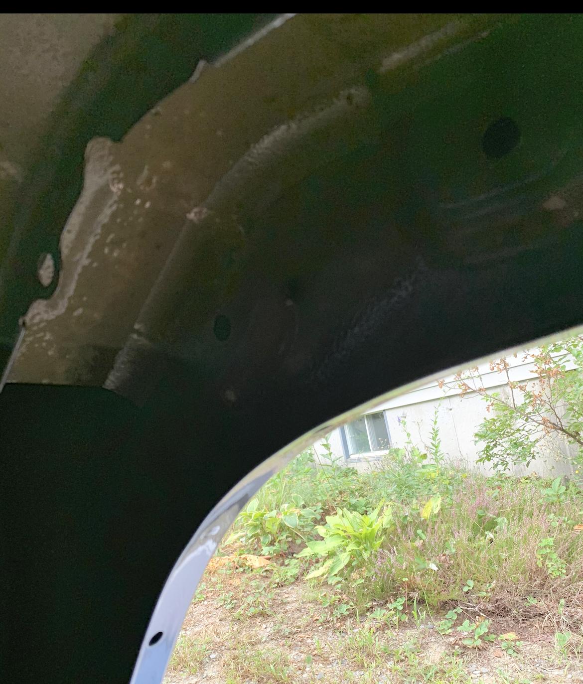

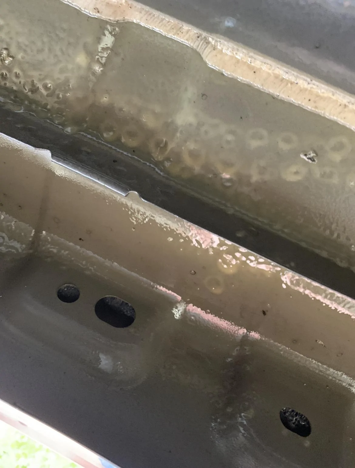

Yes. I simply “fluid film” (NH Hydraulics back to black recently,Undercoating) my cars every few years. Yes it works, it’s only about $25 worth of product per vehicle and it takes 30-45 Minutes under it on ramps. I do inside all frame members, behind all wheel wells, suspension, members, inside door drains, rocker drains and corners. Completely coat the underside. I also paint any bare parts (driveshafts etc) with rustoleum. It works, is cheap and worth the money and effort..
Some garages only charge $150-200 to do this service. They do not get into the inner doors etc, but better than nothing.
