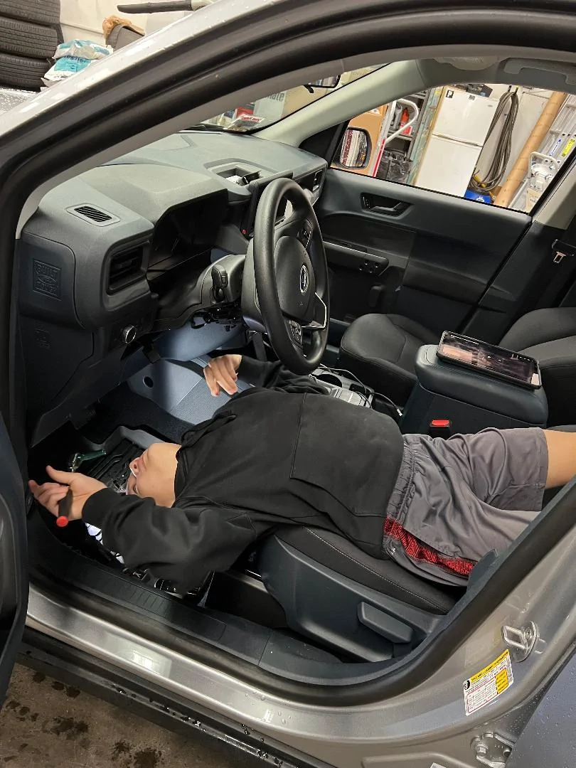

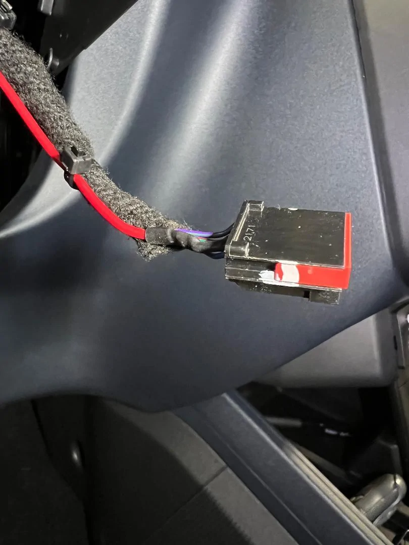

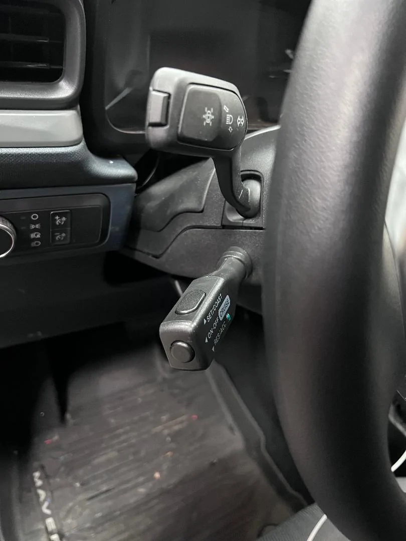

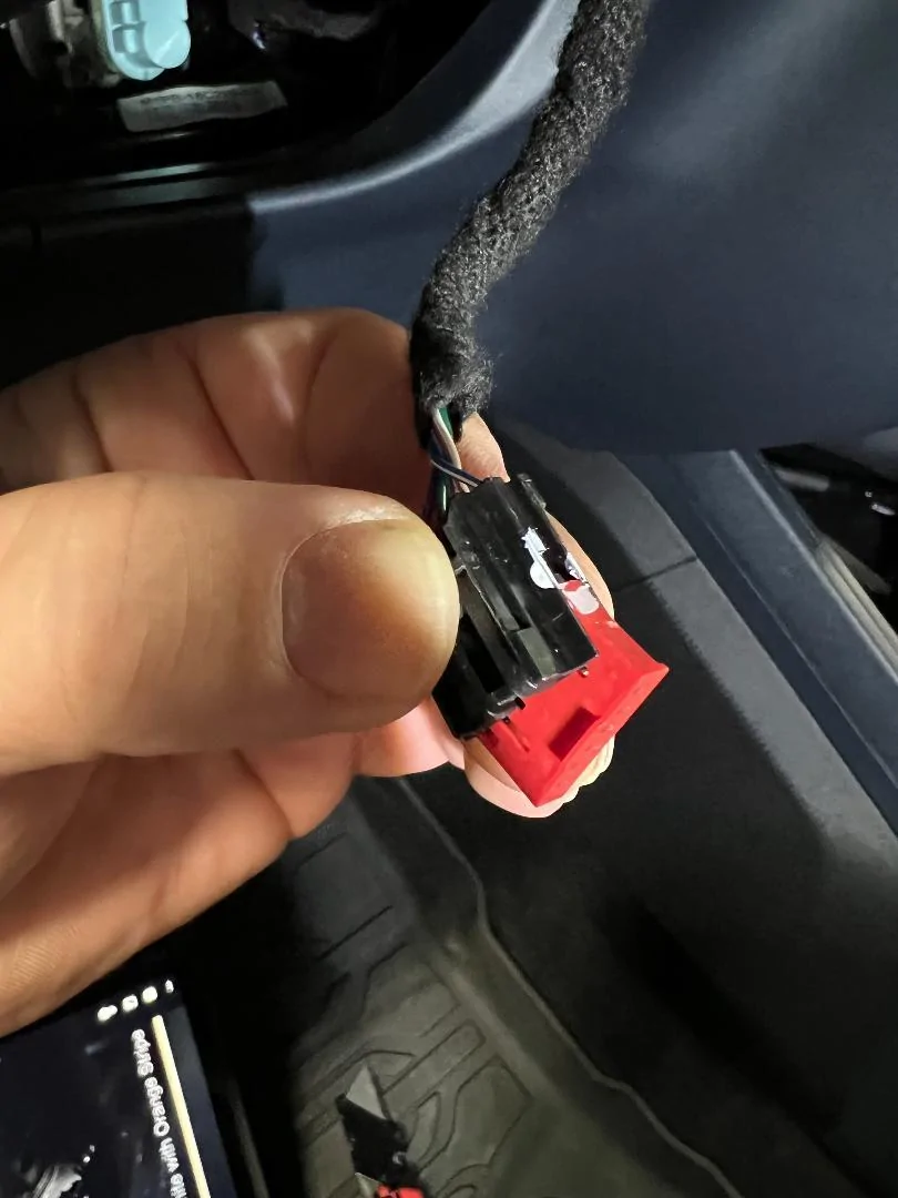

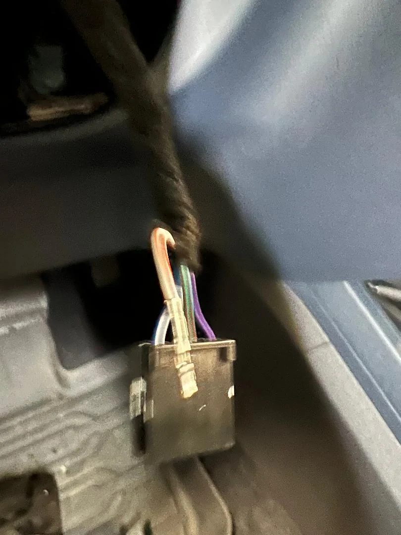

Yesterday I installed Rostra cruise control. I actually had my 13 year old do 90% of it as he fits better. Let me start out by saying thanks to Rostra for making the kit as its the only option. The kit is very easy to install and take about 90 minutes. I pulled the pins out of the plugs so I could use heat shrink, I did not like the idea of just putting tape over bare wires. Rostra needs to make T harness for the ignition and OBD2 plug to make it a more complete kit. Everything works good and I now have working CC on my truck. The Rostra CC switch is not as good as the factory Ford switch and I will switch over to oem CC at a later time if it becomes an option.
