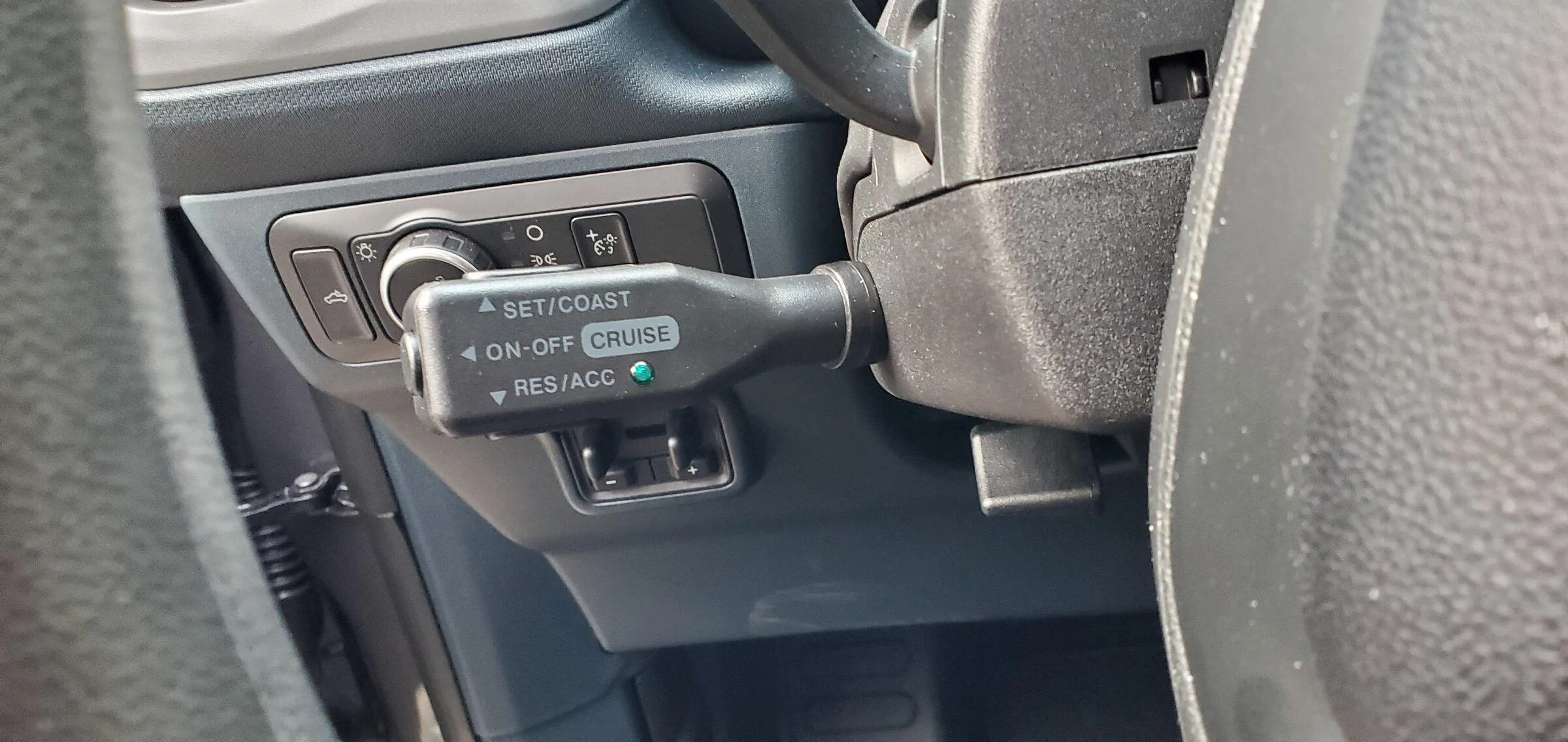

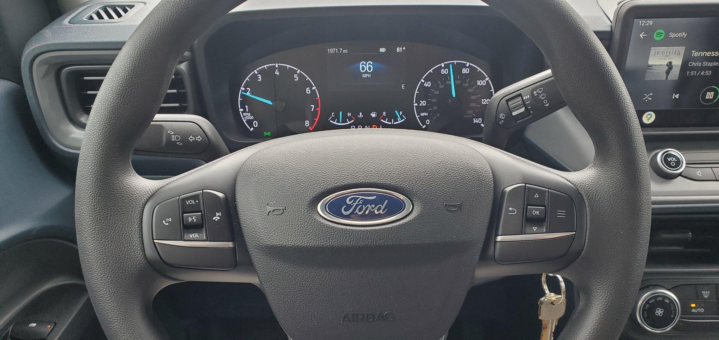

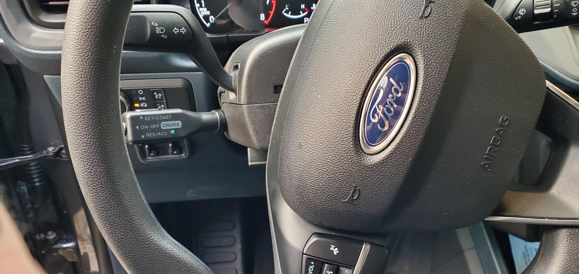

Finally got around to having a local shop install my Rostra cruise control module.. just couldn't go without cruise control any longer. Most of my driving is done on the highway.
I didn't mind having the lever installed, but I wish the buttons on the lever felt less cheap. There is an indicator light on the lever itself if it's on, however, no lights/warnings pop up in the gauge cluster. The way it's installed in my Maverick though means I can't see the indicator light while driving straight. (see photos) But, for $300 + installation, it works without issue and it's all I need.
Overall, I'm very happy with the purchase. Figured I'd post a few photos for anyone else with an XL who might be thinking about it.

I wonder why he didn’t go with the factory cruise steering wheel button option? 😉
In all seriousness though, I don’t understand why someone would install the aftermarket cruise. While it obviously works, I don’t see any advantages. Installing the buttons and programming with FORScan is easier, cleaner, and you get the display indicators. Best upgrade I made to my XL.
