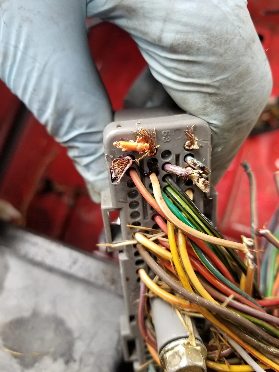

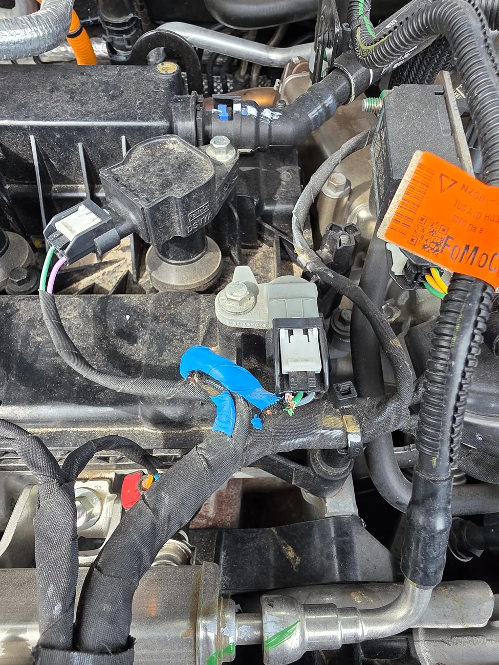

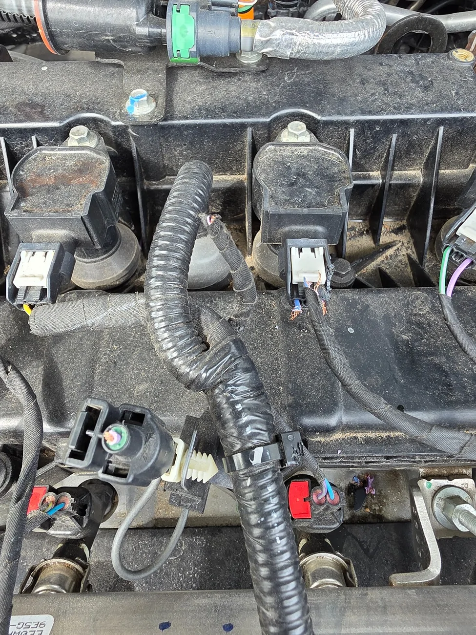

Ok, how many have had issues with rodents chewing on wiring? 2024 Hybrid, 31k miles. Ran fine yesterday and seemed like half the cylinders were misfiring. Getting towed in but quick inspection shows chewed wires. My neighbor had the same issue with his F150. Bought some spray on Amazon that was supposed to help. Maybe I didn't use it enough.

I've repaired lots of rodent damage like that
Sprays don't work all that great
The best solution is to get a squirrel trap & get rid of them at least a mile away or any other method to make sure they never return
Best $40 you'll ever spend
Now that its peed all over your truck, its a magnet for all of them to come back & do it again

There is no easy fix for this. If there's a mouse population in the area, they will at some point try to set up shop inside your shit. Deterrents do almost nothing. Exclusion is almost impossible.
Assuming you're around to monitor them, traps are really the way to go. Those bucket ones are great, because they can catch multiple animals without needing to be reset, but do NOT leave one unattended for even a couple of days or it will turn into a little Rodent Thunderdome.

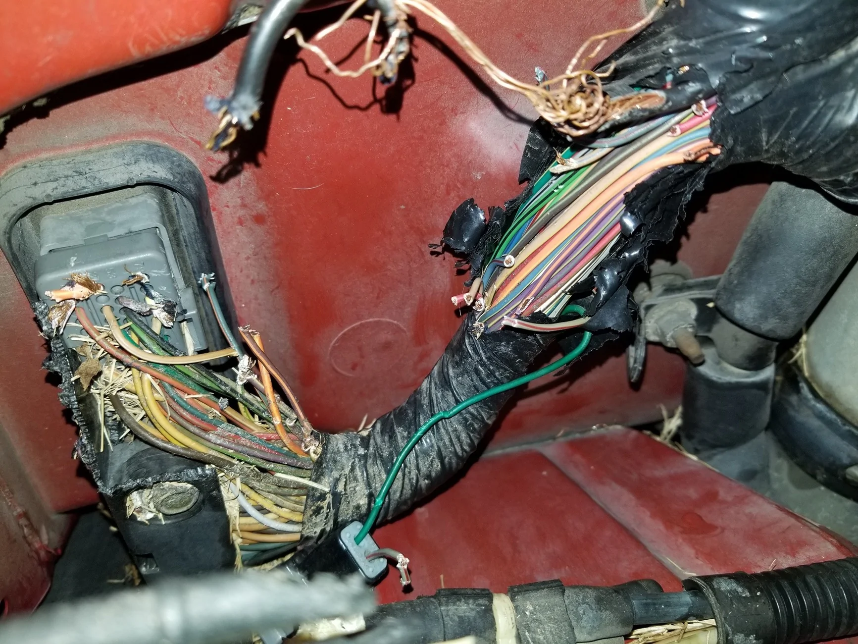

Looks like a rat did that to me. I have been at war with rats for 20 years until last November. I have trapped and shot 100's, maybe over 1000. No kidding. Mostly with the old fashion spring traps and my .22 with a laser sight and flashlight. They come out at night. I have tried many things. Never could completely irradicate 100%. I tried different kinds of repellants, CO2 automatic traps that cost $200 (save your money) dryer sheets zipped tied under the hood. The squirrels here run around in the day. I have never had a problem with squirrels under the hood of my vehicles. I have 100's of ground squirrels and greys running around my property. So last November was the final straw when acorns and crap was found under the hood of my Maverick. When it wasn't going to rain, I could leave my hood up, which always worked keeping them out for that 1 night. So, I did what I was not wanting to do. Poison. I put a couple pouches under the hood of my Transit and Maverick for 2 nights. The pouches were gone each morning. I have not seen any signs of rats since. Zero! I know this is not popular, and it was a last resort for me, after holding out for 20 years. Rats are a huge problem and will cause $1000's in damage, and inconvenience you, and put you in a bad mood if not 100% irradicated. I know the feeling. Good Luck. ✌
