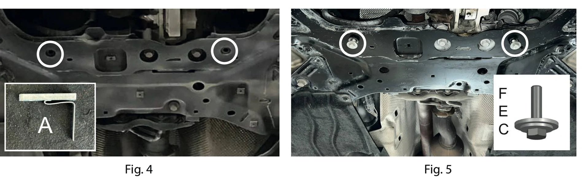

Does anyone have a photo of how they threaded the rear nutplates through the holes to install their Rival skid plate. I'm just not seeing it. :crying:

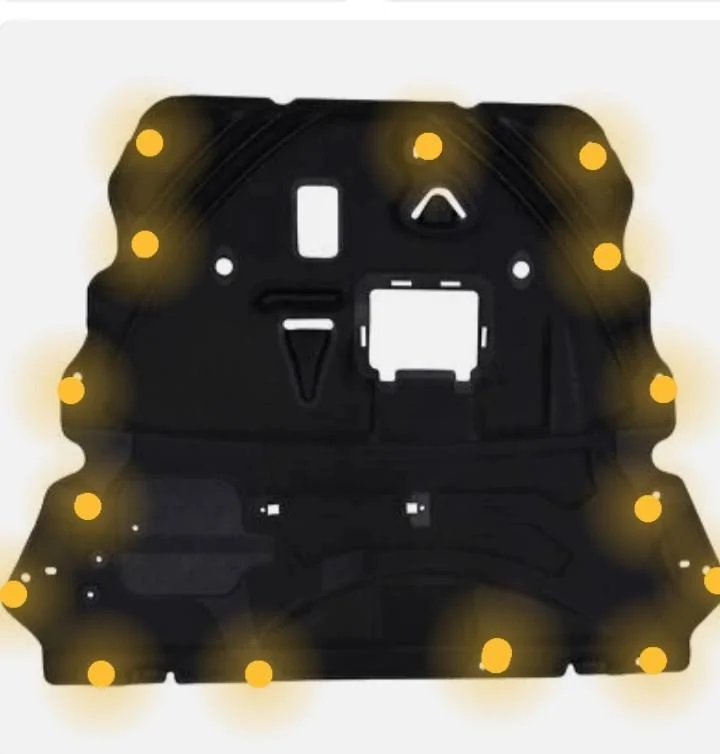

Bob,
You may want to consider contacting rival about having to redrill some holes because they didn't match up with Fords.
Below is a picture of the Ford Splash panel with the 15 screw holes highlighted.

The insert nut/nut plate goes in through the circled holes and then lays flat centered over the same holes. It helps to pull down a bit on the tab/wire when threading the bolt.
Hope that helps, feel free to PM me if you have any pictures/questions etc you would want to share so I can help you further.

I see it now. Thanks for the email and posting here. I appreciate it.
