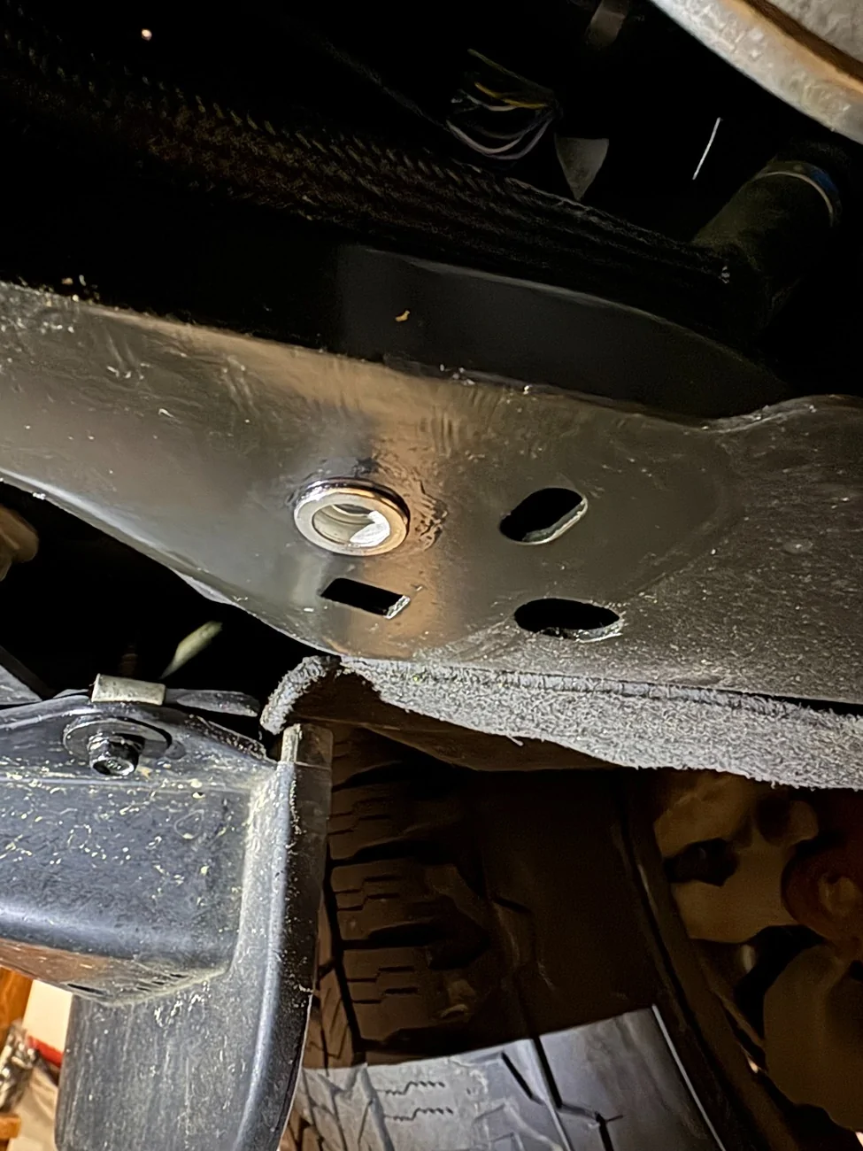

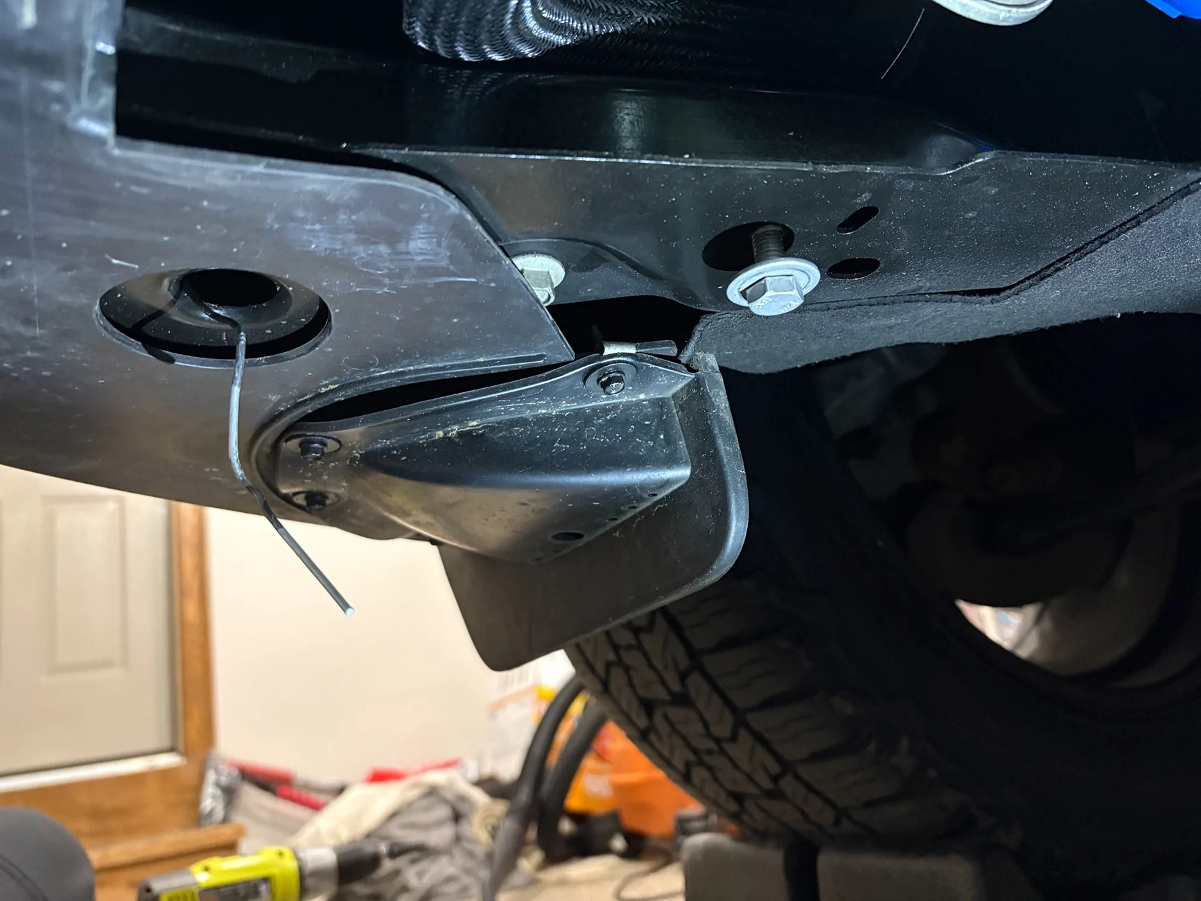

Circled back yesterday to install some rivet nuts into the front bolt locations so that they won't slide around when attempting to reinstall the skid plate after removal, and an opportunity to improve the rivnut, washer, and bolt to stainless steel.

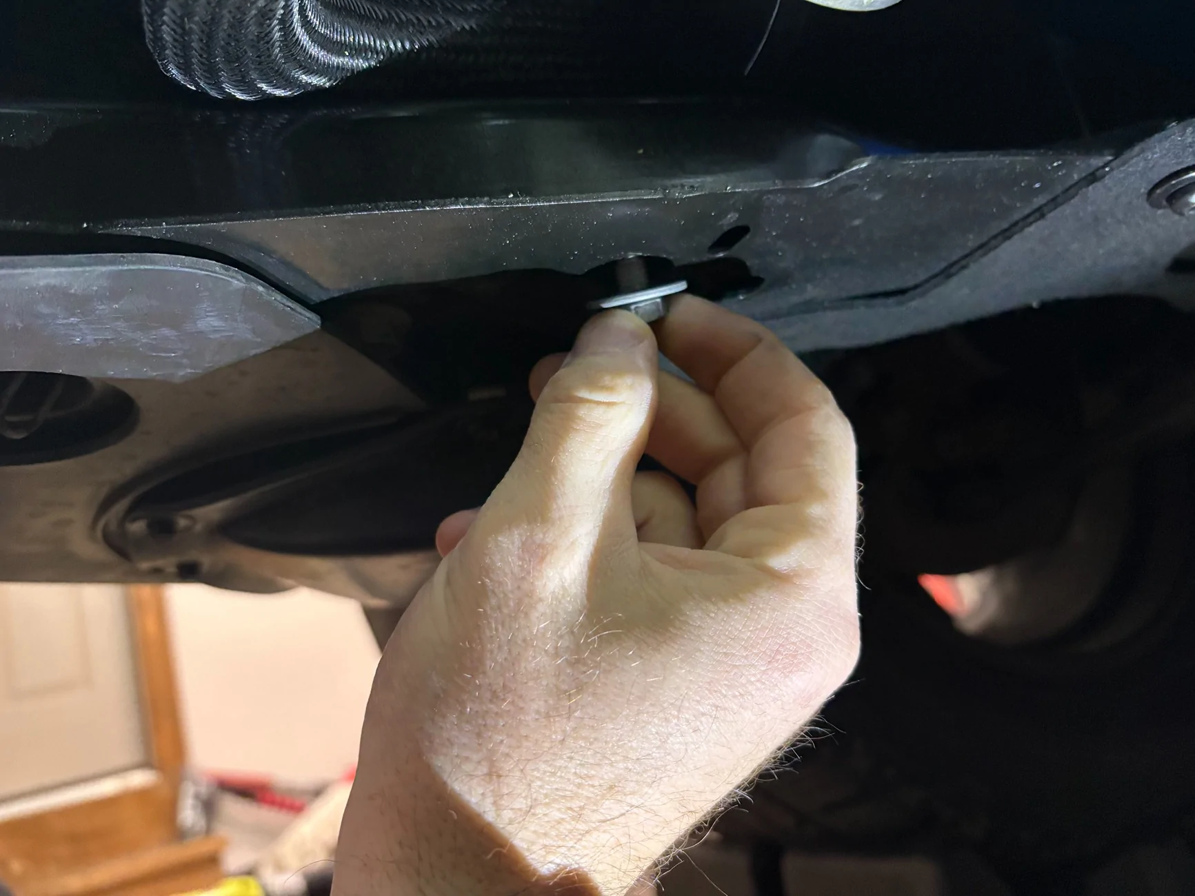

In the picture below you can see how the bolt is not really secure in the front location when it is loosened because the nutsert that is provided moves freely until torqued down.
This causes the bolts to move around when attempting to install and re-install the skid plate.

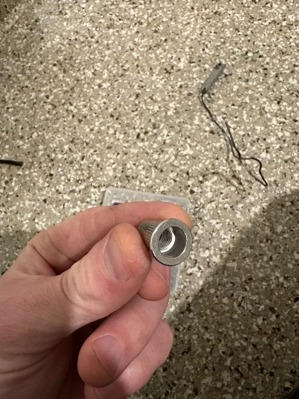

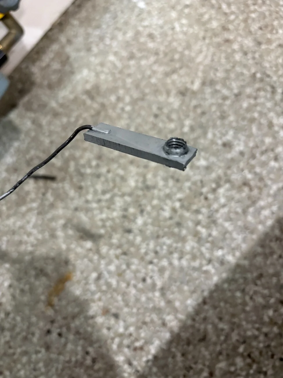

Here is the less than stellar nutsert provided:
Replacing the provided nutsert with a stainless steel M8 rivnut:
Had to use a step drill bit to open the hole for the rivnut to fit. Also painted (after this photo) with rustoleom to protect the bare metal.
Once the paint dried I pressed in the Rivnut and re-installed the skid plate. Total actual work time was about 20 minutes with a few hours to let the paint dry in between.
