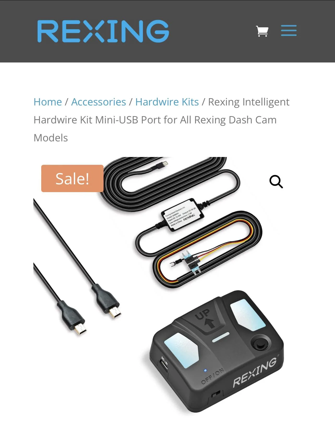

Cigarettes plug stays on for 60-90 min. after exiting the vehicle, which could be a good way to have a “Sentry mode” for your camera, while in parking lots.
https://www.mavericktruckclub.com/forum/threads/12v-outlet-not-shutting-off.26670/
If you don’t want that, purchase the hardwire instillation kit for your unit and you can connect it to the fuse box, to turn off with the key.
https://www.mavericktruckclub.com/f...install-w-pics-diy-writeup-instructions.6034/
Ford Maverick Rexing V1 dash cam help IMG_4133
https://www.rexingusa.com/product/i...qWMDpw1y4nXS49wNjwdQmQ2DWWLY0bNRoC0E8QAvD_BwE
