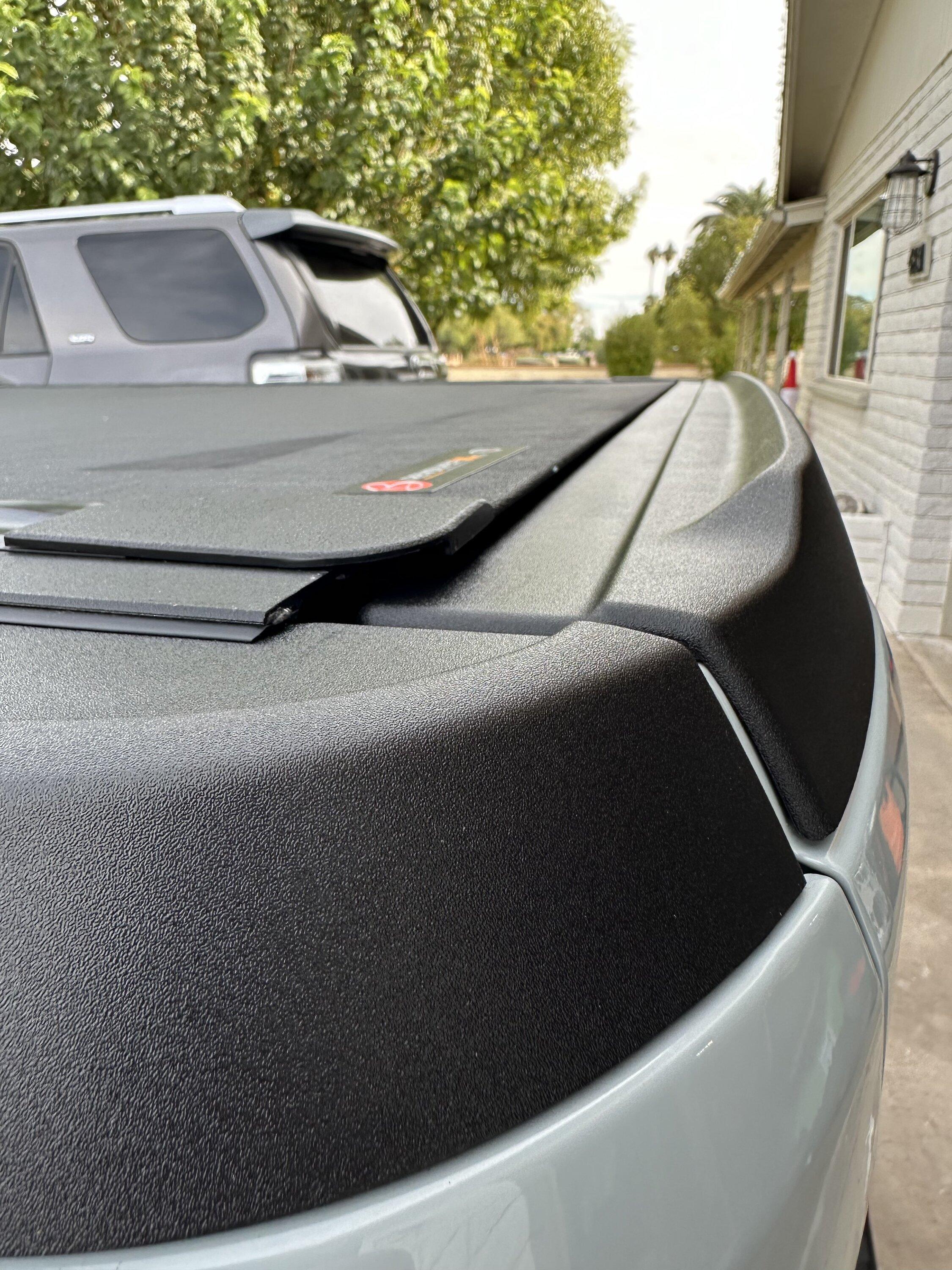

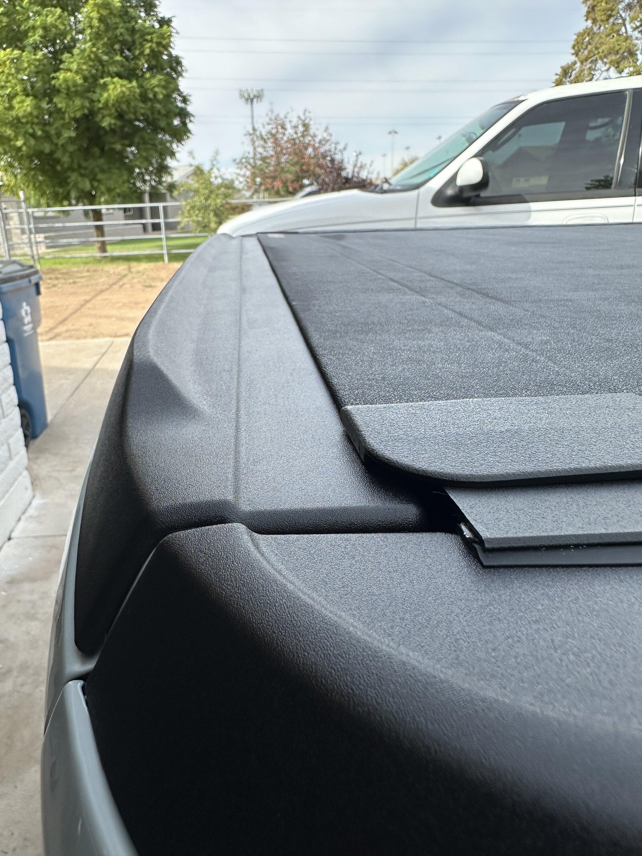

After waiting 13 months for my Maverick and researching roll up bed covers during my wait I finally settled on the X4S. Got a great deal though RealTruck.com!
After getting it installed I’m having fitment issues on the driver’s side tailgate and I wanted to ask if anybody is having the same issues? After searching YT and the forum I found issues but not related to the tailgate.
Essentially it’s not sitting flush on the drivers side and sits about 1/4” too high. I’ve uploaded some pictures and a video in hopes some of you have an idea of how to get it to sit flush along the entire tailgate.

Do you have the front stop against the bed on both sides so it’s square? You are just out of wack a bit. Just work with it and you’ll be fine.

Yes I do. I actually took off the rails several times to make sure it was square and no luck on getting that flush.

Is your cover track fully seated in the rail channel (all the way to the end) and not hanging up from not being properly square? It's likely not latching on the drivers side, and you may have to slide your left rail down a touch. Just make sure your rails are lined up in the same position on both sides and your cover is squared up. Good luck.

Looks like the rails are ‘tipped up’, at the back. Mine had foam strips on the back side of the rails and they were near the top, I moved mine towards the bottom; helped a lot. Also, how high or low you put on the clamp can adjust the rail’s tilt.
FYI - The metal part of the box, the rail clamps to, does not run all the way to the end of the box, it flexs a little near the tailgate so you may need to adjust for that.
The other thing I did was put a little more foam on the end of the rail at the cab. I did this so the back of the rail was closer to the tailgate.
Realtruck will send you foam shims if you need them; all need to do is ask. One of my end caps came cracked, they sent me new ones as well. Had no issues ever since, been over a year.
