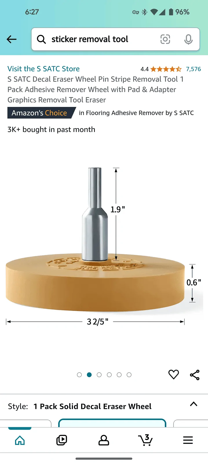

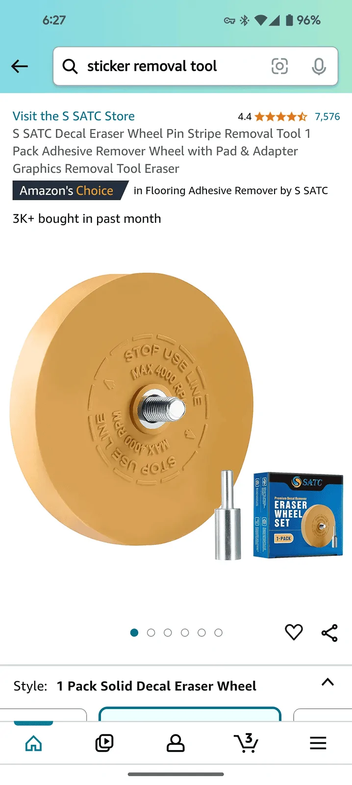

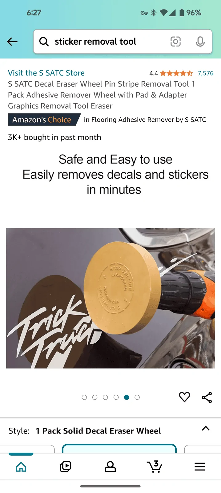

This should do the job. 😳
Ford Maverick Removing dealership decal without paint damage? Screenshot_2024-06-19-07-11-54-04_40deb401b9ffe8e1df2f1cc5ba480b12
Cheap too.👍
