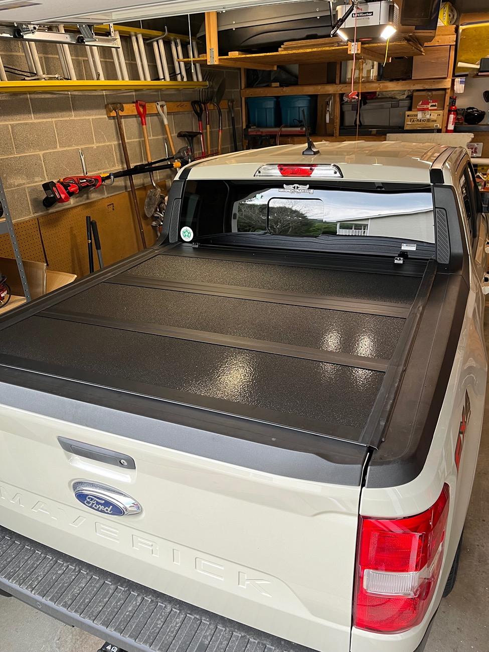

I just now installed my new Undercover Armor Flex cover. Installation was pretty easy. I'll have to give a report once I get it out in the elements. For now, shower, eat, and off to work for night shift.
Ford Maverick Recommended Tonneau Covers? IMG_1912
