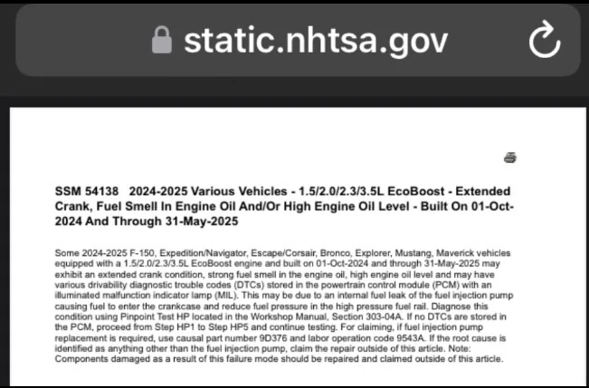

Is your build date within the range of this TSB? An ā€œextended crankā€ is a symptom. So is a gas smell on your oil cap. Check it out:
It is
Lovely, managed to miss that one in my search. I figured trouble starting was on the way to not starting and that recall notice has been sitting on my table for a couple weeks
Oil level is normal but does have a fuel smell. Still need to call the dealer, just a different issue apparently.

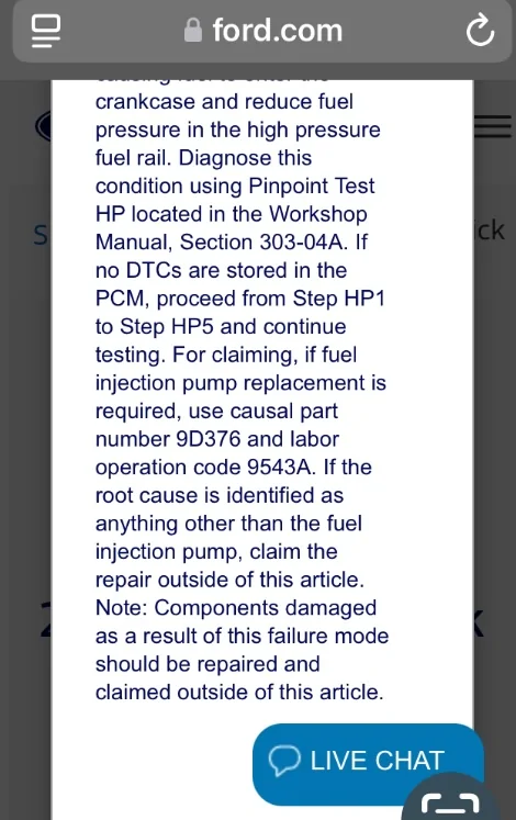

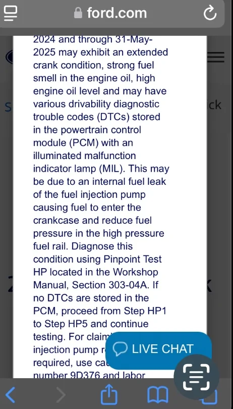

Here is some additional info on the TSB:
Ford Maverick Recall 26S10 IMG_0863
Ford Maverick Recall 26S10 IMG_0862

I have the gas smell but cranking is normal. I’m waiting for results from Blackstone to see if they find any oil dilution…
Took mine in this morning, codes had all cleared were just communication failures and I may need to get my nose checked
