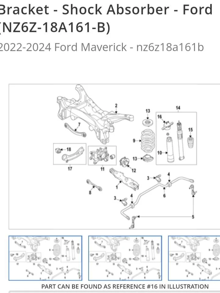

Do you have a picture to compare to mine.

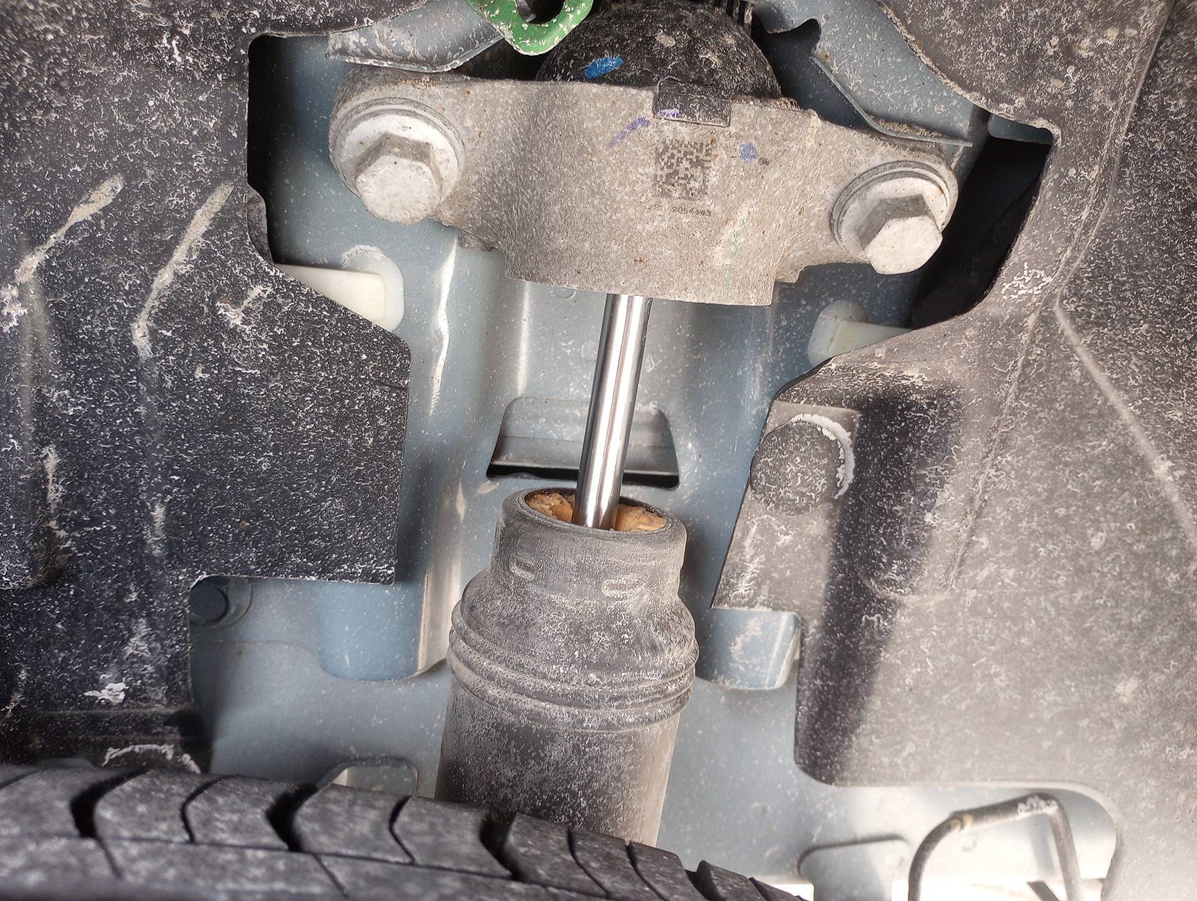

I push dust cover back into place, then it falls down again when driving.
It probably slipped out of the clamp/bracket.
There's always the most often redneck hack I've seen on here. Get out the old Kitchen and Bath silicone sealant. Just kidding. Kind of.

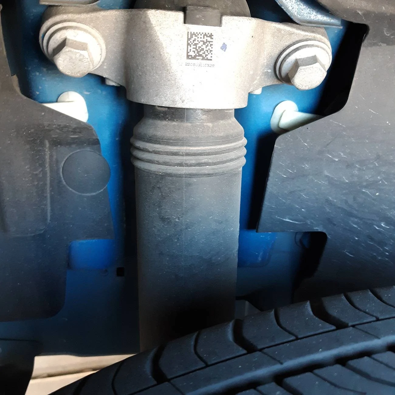

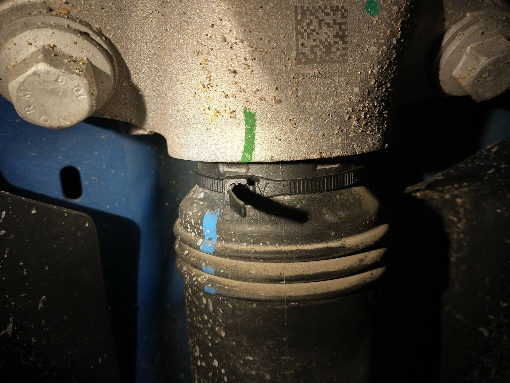

There's no clamp holding it in place, it's just the friction of the foam bottom-out bumper material that is sandwiched between the boot and shaft that holds it there. The foam is the yellow/orange material shown in the pictures above.
I'd recommend putting a zip tie around the boot at the top to apply some pressure to the foam bumper and give it more pressure against the shock shaft, then slide it back up into place. Before you do that, clean the shaft with some alcohol to be sure there's no oil film on the shaft. If there's a lot of oil there, you need to check for a leaky shock and get it replaced.

Nearly every performance truck shock made uses a zip tie to attach the boot to the body of the shock from the factory. It's good enough for Bilstein, Rancho or a Harley, but not good enough for a Ford?
:unsure:
Do what you want obviously @1929, but I'd have that boot fixed back in place in 30 seconds.
