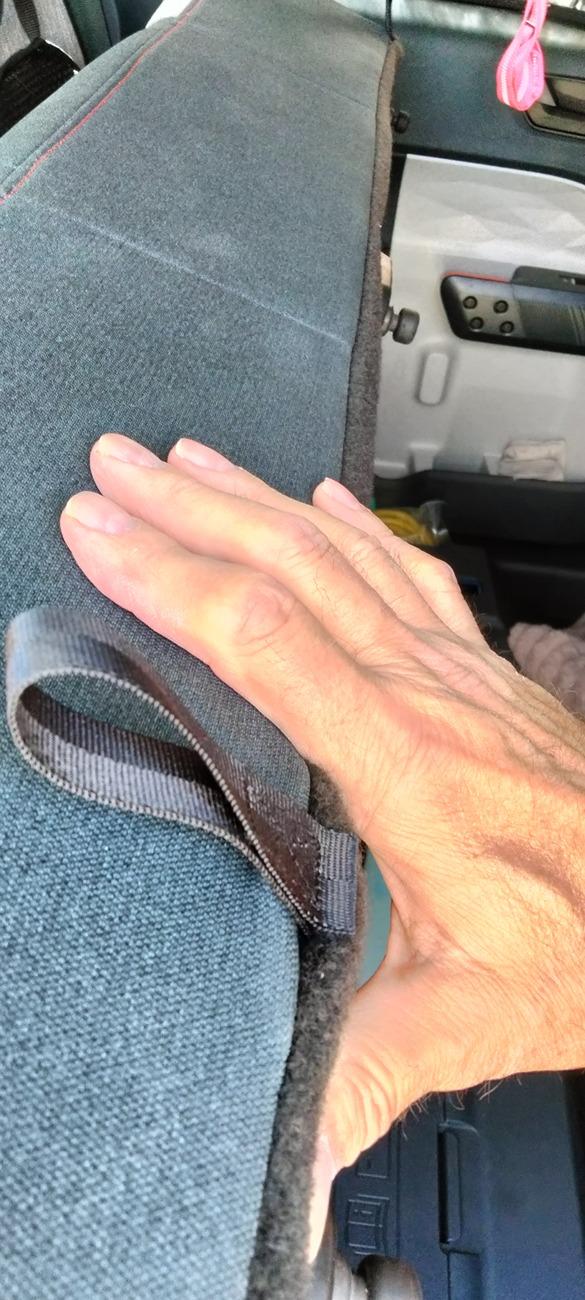

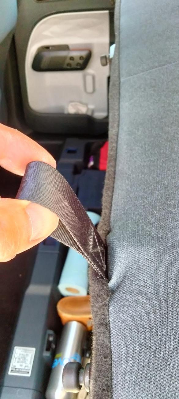

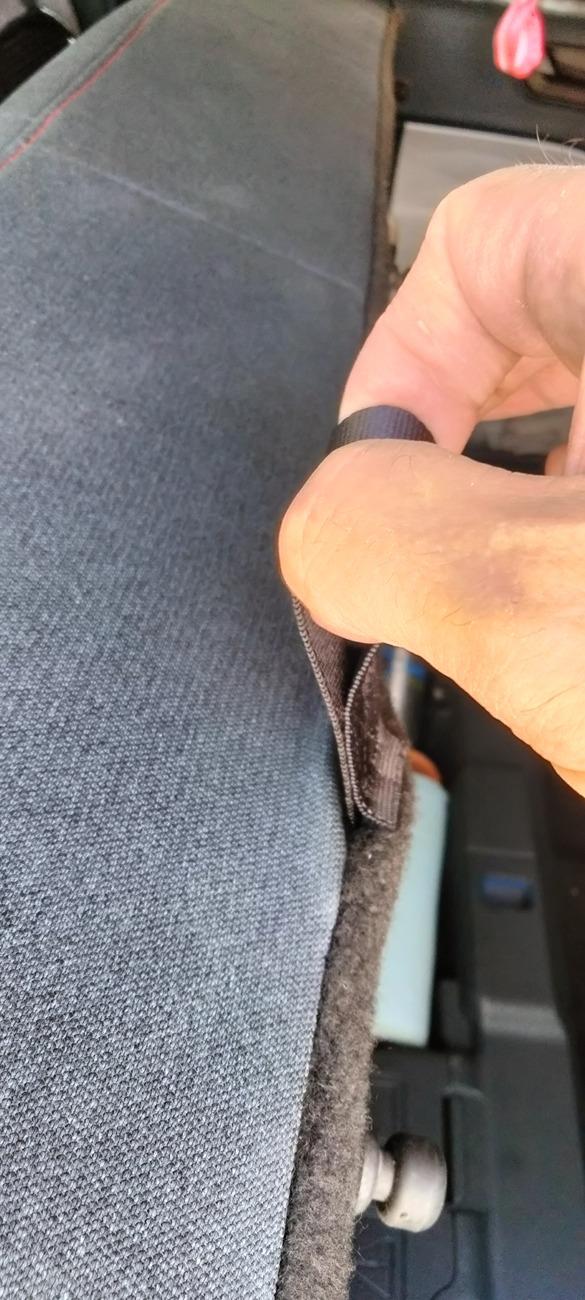

Can you send a picture of your seat in the upright position. Please.

With 2 hands 🙌
You can try pushing backward on the seat towards the back of the truck while pulling up on the strap.

Thank you! I got it back down. It appeared that one of the seatbelt receptacles was tangled in a way that was holding it in the upright position. Thanks again for your help. Occasionally the internet leads to something useful!

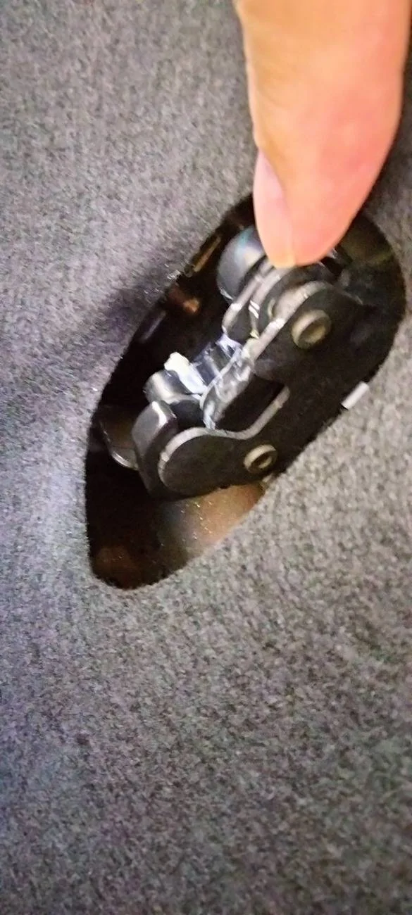

The upper i can't latch. Looked at latch contraption, can't figure it out. Luckily noone sits back there. Maybeeee they'll look at it at my next quick lane in 800 miles.
I believe I know what the problem is.
PM sent.
