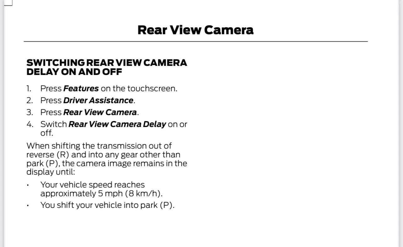

I think there is a setting that delays the camaera from turning off when going into drive. I would check that to see if that is turned on.

Yep
Ford Maverick Rear camera problem reappears IMG_9088
That's correct. There is a setting, and I have activated in my truck.

That setting goes off as soon as you reach 5mph so unlikely that is the issue.

There is a setting that delays the camera from turning off when going into drive tho

I had that problem and the dealership replaced something behind the center screen. I haven't had the problem since. That was almost 2 yrs ago. Good luck.
