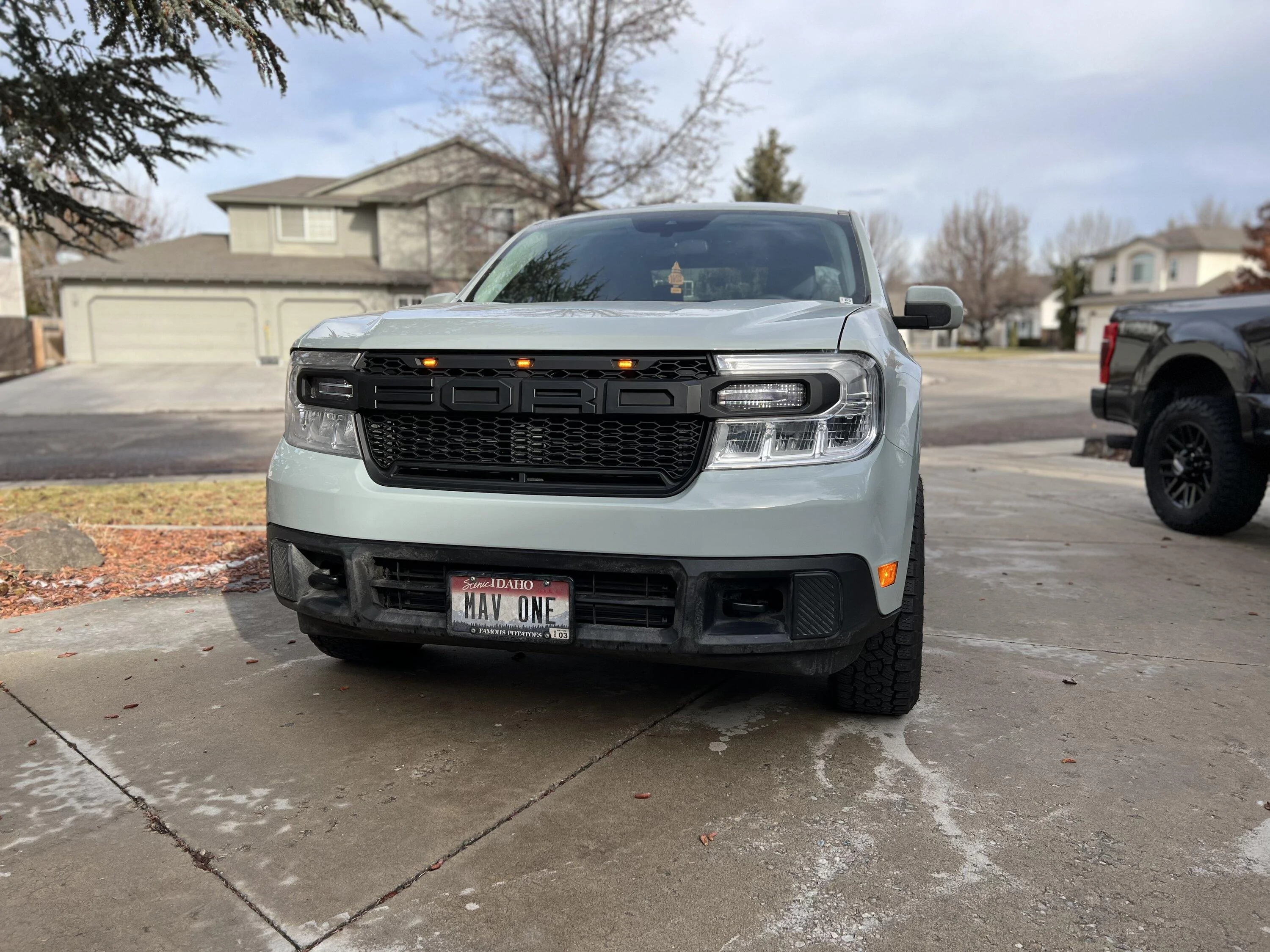

Mission accomplished!
Well done! How long did the evolution take? How did you do it without taking the bumper completely off? We need the deets, man!
