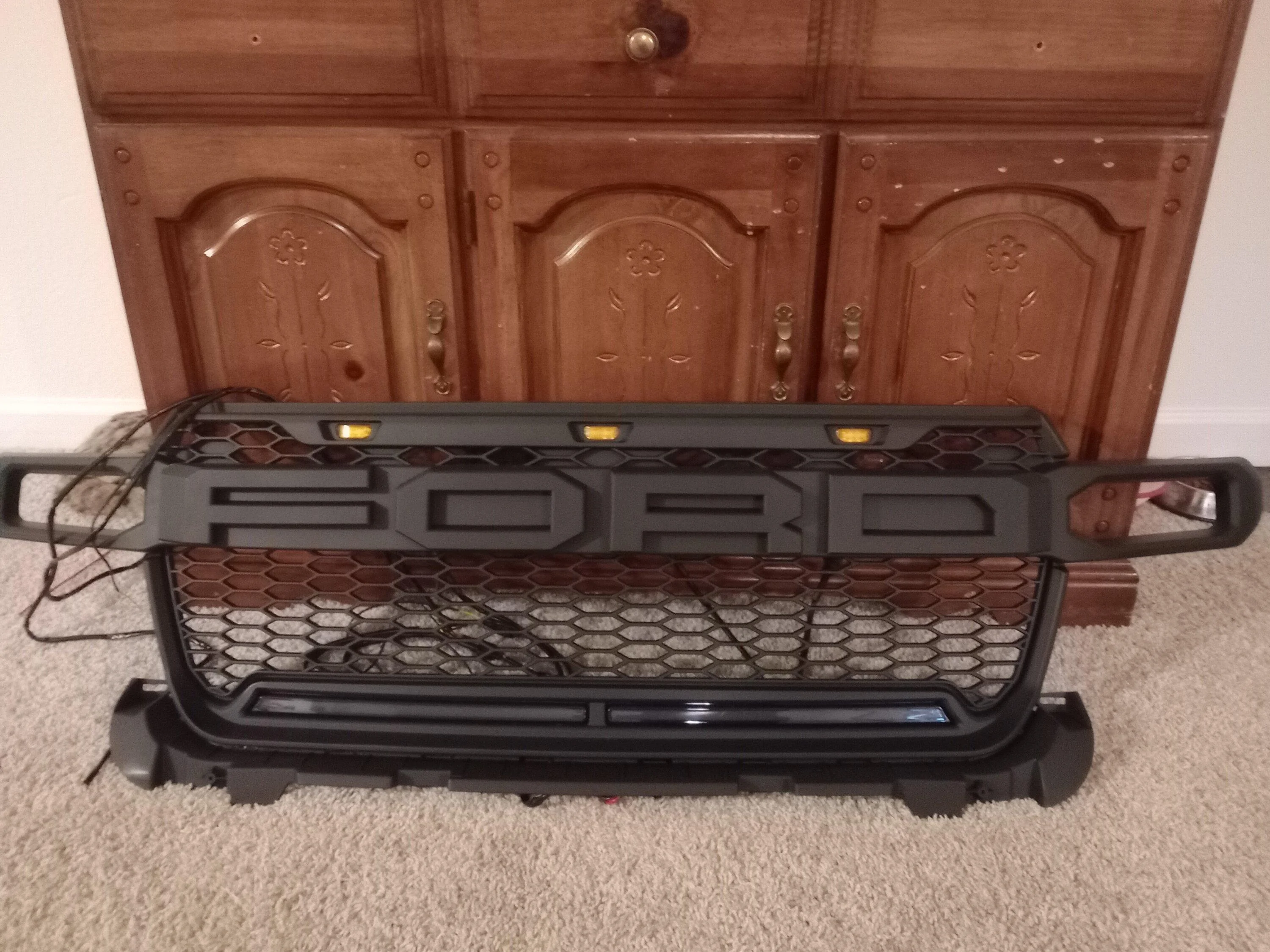

I joined the grill club. I Should have it installed this weekend. I suggest replacing the 24 screws and washers with #8, 5/8 sheetmetal screws, and 1/2" fender washers. The screws that come with the grill are too long and will poke out of the lettering, but use the short 6 short screws for the eye winglets. I just preassembled mine myself W/ LEDS. Here's the link I bought mine from. Comes with the LEDS $219.00 free shipping.
Update with video at night, lower LEDs I tapped into the upper turn signals. This is also with the lasfit switchbacks Installed. Some folks may not like it. Lower LEDs are white when turn signal isn't in use. Side markers are lasfit also. Price has dropped down to $200 now. Better buy. Definitely getting great compliments.
https://www.ebay.com/itm/125900707096

I watched a youtube video and I also saw that guy say he punched through the front with the screws. With that in mind, I "snugged" mine and did not have any unauthorized penetration :oops:
Hey, I know this is an old post by now but could I get a wiring breakdown to make my raptor grill function like this? I have a black, red, and two yellow off the combined harness for upper and lower lights that came with the kit.
Seller said:
The red wire links with the ACC or headlight. The black wire links with battery negative pole. Two yellow wires link with left and right turn signal lights.
How accurate is that to your wiring MaVVy? Has anyone figured out how to pull this off with splitter harnesses instead of tapping into wires?
